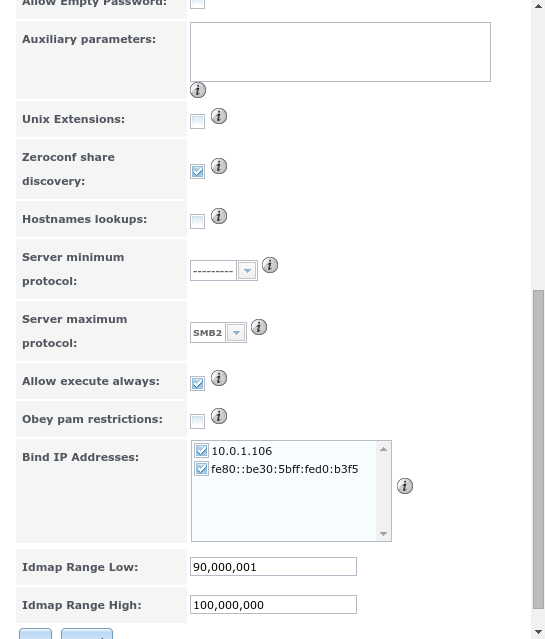

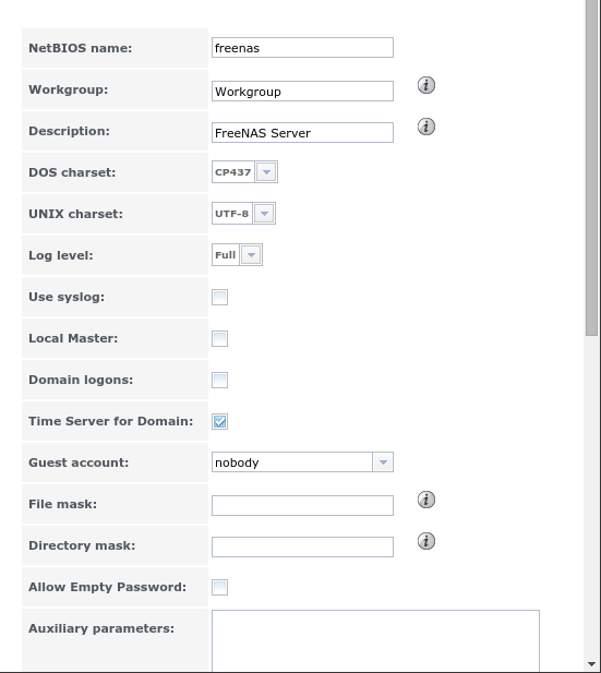

Nothing was changed in the volume options or the CIFS share options, except that I checked the "Bind IP Addresses:" boxes in the CIFS options to see if I could get a response. I'm including screenshots of my CIFS screens (snapshot1 and snapshot2). I ran testparm and see no problems either (file included). In the course of working on this I did a minor upgrade to the latest 9.3 stable, necessitating a reboot. I also tried cycling CIFS off/on.

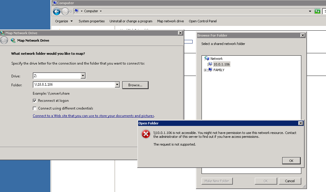

The windows 'map network drive' error that is generated now. The behavior has changed slightly, as it doesn't just spin its wheels and then time-out...
