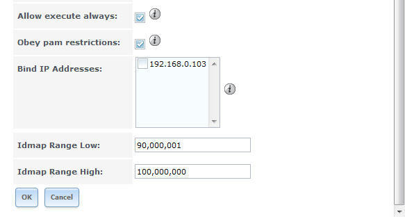

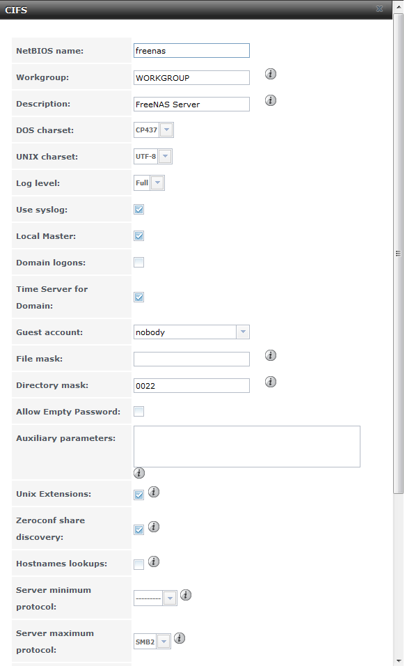

I updated from FreeNAS-9.3-STABLE-201501212031 to FreeNAS-9.3-STABLE-201502162250 using the GUI. My shares are no longer available on my Windows machines. I can log in through ssh and the web gui. If I boot from the previous version, the shares are again accessible.
Nothing was changed in the CIFS share options. I included screenshots of my CIFS screens. I ran testparm and see not problems either. I also included the last 100 lines of /var/log/messages.
Any help would be appreciated.

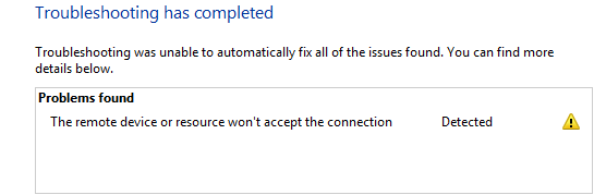

Same thing is happening to me. In explorer, if I type \\nas-ip it times out and pops up with "Windows cannot access \\nas-ip". Here is a screenshot of the remaining message:
When I try to troubleshoot the problem in Windows, it comes up with this error:
I changed my user password for both my Windows and FreeNAS machines, but I still cannot connect to CIFS shares from my Windows machines. I also tried booting from a fresh install of FreeNAS on a different USB, but I still couldn't access the CIFS shares. I may try this option again, because there were other problems that were also happening when I did this. Everything still works with 201501212031 on the original USB. I attached /usr/local/etc/smb4.conf file and the past couple days of /var/log/samba4/log.smbd. Where would the error 13 show, in /var/log/messages?

Just an update, a solution was found. I had to add the line "127.0.0.1 mymachinename mymachinename.domain.name" without quotes to /etc/hosts file.
