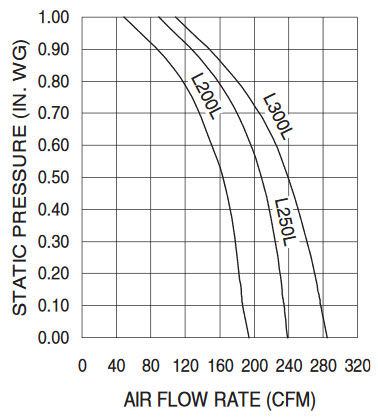

(I have no idea what the static pressure would be of course)

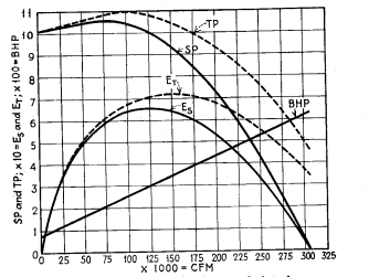

You should have such because I sent you the spec sheets that have the characteristic curves.

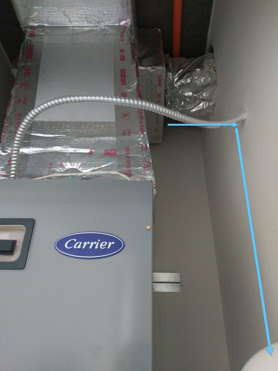

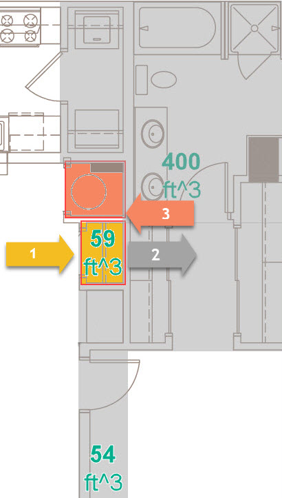

There is one return air "vent" in the condo, and that sits on the underside of the air handler in the utility closet next to the server closet.
Things are not as I had imagined. Your air cond/furnace is an "updraft" unit and therefore draws all return
air from the lower plenum at floor level. Your mention of concrete above the open closet also tells
me that your place is single story, again no reason for return air to be located above the ceiling.
I don't follow the comment about the handler drawing air from the closet with a ceiling in place? Perhaps you could explain that to me.
I was making assumptions about this mysterious draw of air under the closet door, knowing what I've learned
from you about your system, I can now say with confidence that this has to be natural convection with the
heat produced by your electronics and server.
I think you should install the fan you purchased and duct it into the space as you have described. Hang your
sheetrock and I agree with @Redcoat , you are good to go! At worst case scenario, you will need to possibly
install the second through the wall fan at the bottom of the wall. Stay Cool :cool:
To be honest, I've have a very cursory understanding of fluid dynamics. The extent of my understanding: I realized my SC836 did not have the correct fans installed as purchased (used via ebay) and the proper ones rated at a higher static pressure dropped temps significantly. OK well maybe that and I know that you can increase the static pressure with square instead of curved elbows in ducting, etc. I could give you the actual definition without googling, but I still don't really "get it." To that point, I don't understand a fan curve any better now than the first time I looked at one. Example: To me, it seems like air flow * should * be a function of static pressure not vice versa and I don't understand why fan curves present static pressure on the y-axis as a dependent variable.

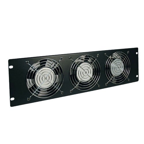

While I have the opportunity, do you think I would see any benefit to adding this between the drywall
Sure, the noise will be reduced for sure. There's 12 pieces of 16 x 48 in that bundle you linked to. If the cost
of that bundle is under $47 that puts the cost per piece @ <$4 so I would say go for it:)

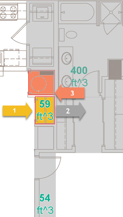

Some further remarks on this topic as I hit the home stretch with the install and in this post I present: (1) a closet diagram (proposed configuration), (2) discuss mounting orientation, (3) dive a bit deeper into mounting bracket selection, (4) question whether two brackets are needed, (5) question which cage screws are appropriate for my rails, and (6) discuss whether a final optimization to the system should be implemented to enhance efficiency.

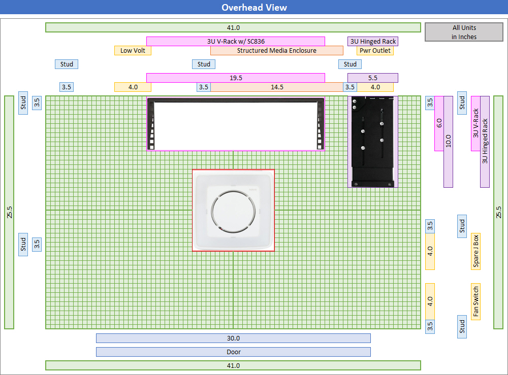

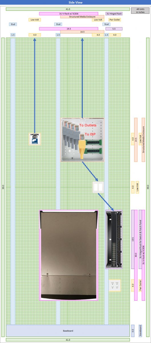

1. Closet Diagram
I took a moment to diagram out what this will look like when complete (I needed to this for myself as I start installing). Sorry for the large images, and there are probably better ways to do this; however, I've always done this sort of thing in MS Excel setting the cells to squares with values for measurement purposes.

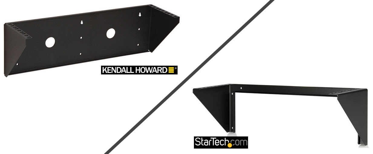

  • Current proposed onfiguration: Kendell Howard 3U V-Rack with SC836 mounted chassis bezel towards the floor, Monoprice 3U Hinged Wallmount Rack for current Cisco switch, patch panel (to be sourced), and 1U for future expansion (perhaps a 10 GigE switch).
  • Rationale for not getting a 6U bracket and mounting everything together: (a) "Isolate" the SC836 from other components that produce heat or impede airflow and (b) I like the idea of a swing out patch panel.
  • More on the brackets in a moment, but it goes without saying that if you are aware of a better solution, please, please let me know.
  • Further, I do need a recommendation for a Cat 5e 20 port patch panel for the Hinged Wallmount Rack.
  • Side View
  • https://ibb.co/g6RfZa
  • Edit: I couldn't zoom into this guy as I would like, so I've appended externally hosted links to those images.
2. Mounting Orientation
  1. Latest discussion with @BigDave suggested mounting with the chassis bottom flush against the wall, chassis front/rear facing left/right was the best approach in my case; however,
  2. as @Redcoat and @MatthewSteinhoff pointed out, the ideal configuration would be chassis bottom flush against the wall, chassis front/rear facing floor/ceiling.
  • I had taken a myopic approach being stuck on that particularly open frame rack and the clearance needed to perform "upside down, vertical mounting," but considering bracket mounting appears the appropriate path, I believe #2 is the way to go.
  • This seems to make sense to orient in this fashion as warm air is already being forcefully expelled upwards and convection is going to carry it further, so maybe this configuration creates less resistance in the flow path (perhaps I'm misapplying @Redcoat 's remarks though)? Further, to @MatthewSteinhoff 's point about attempted emulation of typical rack airflow (front to back), I think this configuration best aligns with that approach (although using intake/exhaust | floor/ceiling, instead of intake/exhaust | left/right).
3. Server Bracket
  • @MatthewSteinhoff was kind enough to note his company's use of Startech 4U or 6U vertical wall mount brackets. As I started to look at sourcing options, it appears as though a 3U Vertical Wall Mount Rack made by Kendell Howard is superior compared to StarTech's offer. I make that assessment just looking at specifications (lesson learned from @Redcoat). It is both heavier (3.47 lbs v 2.08 lbs) and rated for a higher load (150 lbs v 125.3 lbs).
  • While I'm sure either would get the job done, considering they are just about the same price, do you think the Kendeall Howard 3U bracket is the way to go? If you have another option, I'm all ears.
  • Further, I take it there is nothing gained by going with a 4U instead of a 3U? If I need more RUs for future expansion, I will buy another bracket and put it on the side wall. The only thing that I can think of is that if a 4U bracket were used, and the server was mounted on the 3 RUs furthest from the wall, that 1 RU buffer may aid upward air flow. I don't think this would have much, if any, impact though.

  • Latest discussion with @BigDave suggested use of two brackets, but that suggestion was made with the understanding that a horizontal mounting approach would be used.
  • Using a vertical wall mount orientation, I don't believe that two are needed, unless the rails I have can't be locked to prevent the bezel from hitting the floor.

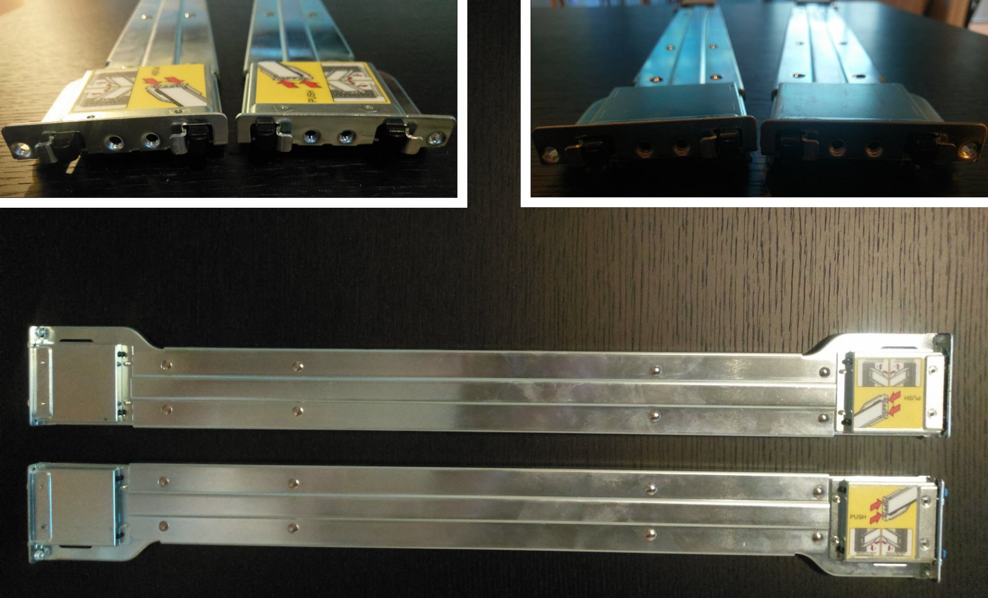

  • I've attached a picture below, but I believe the inner/outer rails I have are Repon W-778-B-0 / W-778-A-0 Rev B Rails.
  • Unfortunately I can't move the server to check at the moment, but is one of the two options possible: (a) Lock rails so they don't slide, or (b) Reverse them such that the end which would slide is facing up? If so, I believe only 1 bracket is needed, but if not 2 brackets are needed.

  • Looking at the rails, it looks like each rail end takes 3 screws / nuts, so I need 6 total if 1 bracket is sufficient and 12 total if 2 brackets are required.
  • Can anyone confirm M6 is the appropriate screw size and that these will work: http://a.co/6vs2XOg?
  • Alternatively, Rackstuds look kinda neat ... and I think they would make mounting / dismounting the server easier, which is already going to be a PITA with its heft by one person.
6. Cooling "System" Review
  • What we have effectively done with the system is take one box (closet) and place it in another box (overhead area), but I wonder if another "box" should be added, i.e the entire condo.
  • While there was no ceiling in place during my "test", lets suggest that fan actually does move 100 CFM, then the entire volume of the closet (59^3 ft) is evacuated nearly twice per minute. That means the capacity of the overhead area (454^3 ft) is fully utilized in less than 5 minutes.
  • Of course, it doesn't really work like that as the warm air is going to cool, become more dense, and gravity is going to pull it back towards the earth between the walls and that air ultimately escapes one way or another, and the cycle repeats.
  • Maybe not in 5 minutes, but given long enough, if that warm air doesn't cool and escape naturally, air flow stagnates and the system loses efficiency right? Where I'm ultimately headed here: Would it make sense to add a passive vent connecting the overhead area to the utility closet with the air handler, better allowing warm air to escape and prevent that loss of efficiency? As an added bonus, when the air handler fan kicks on, I can piggyback off that free active airflow movement, further increasing efficiency.
  • Finally, will the "whiffer" fan impede airflow due to lack of positive pressure in the closet? It is well noted that it is not the optimal fan for the job, but it has been purchased and installed, and isn't returnable so is the worst of my worries that the motor will fail and considering a 1-year warranty I have to pay for a new motor every year?
No, you have it right. And, if mounted bezel up the momentum of the warm air being expelled downwards would reduce the natural air flow upwards in the closet.
Is system efficiency increased by adding passive exhaust from enclosed overhead area to utility closet?
Not sure - but what it seems likely to do is give a lower resistance path for intake of air that bypasses the equipment in the closet...

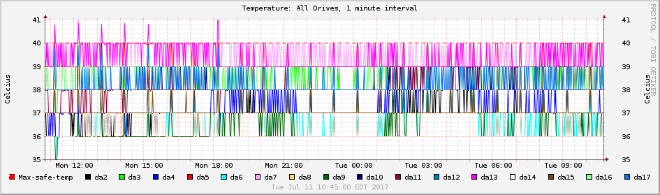

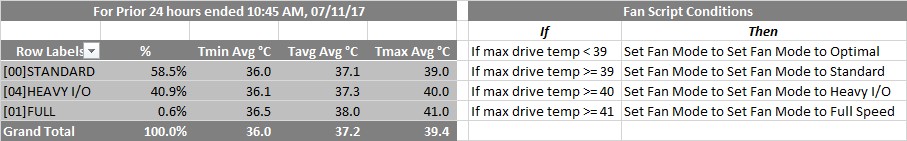

  • During the period of time that data is presented for, the server has been working away downloading data from ACD and replicating offsite and my 100/70 connection has been 100% utilized during that duration with vSphere CPU utilization around 40%
  • Over the last 24 hours, the average HDD temperature was 37.2°C. Over that same period of time, I held 40°C or lower HDD temps (for all drives) 99.4% of the time.
  • Perhaps more importantly, the "Full Speed" fan mode was only engaged for 8 minutes (of 1440). Also, only for 8 minutes during that 24 hour period was the max temperature greater than 40°C.
  • I consider Optimal, Standard, and Heavy I/O modes to be tolerable, whereas the Full Speed mode is not. Provided you have the fans specified for your SC826E16-R1200LPB installed, you know exactly what three of the FAN-0126L4 fans sound like at 100%. Completely unrelated to the topic of discussion, I'm curious if you think what fan modes are tolerable and what are not.
  • Nice case choice by the way. I love my Fractal Node 304.
Thanks again!

I'd like to understand why you think horizontal mounting is superior compared to vertical, face down. It seems like this configuration aligns with the laws of physics better than a horizontal mount. As you point out, there is downside to that approach, but how often are you looking at the system indicator lights or swapping drives?
Not having tested out the difference between horizontal mounting and "butt up" mounting, I just can't see the
drive temp difference between the two methods to be more than a couple of degrees at most! I understand the desire
to have the drives run as cool as possible and IF the "butt up" method gains 4-5 degrees, go for it! If the cooler
temps are not realized, I would highly recommend a horizontal mounting.

I understand the desire to have the drives run as cool as possible and IF the "butt up" method gains 4-5 degrees, go for it!
  • I appreciate that. Thanks for understanding my "passion" here as well as all of your help. Murphy's law plagued my first foray into utilizing enterprise-grade servers and while I learned a heck of a lot, it was extremely frustrating at times and I * thought * about giving up.
  • I'm a planner by nature and have to understand activities I put significant effort into, but got tired of waiting and pulled the trigger. If I were to do it again, I would manage this project just the same as one at work and notably spend much more time researching. But again, admittedly, I do have a tendency to over-analyze. I think I'm being a little too trigger shy due all the issues I encountered at first.
  • Hopefully my presentation of HDD temps did not come off the wrong way (my writing style is often perceived with an unintended, non-existent tone), but I'm proud of the temps presented in the post immediately prior to yours (considering the environmental variables). It took a lot of time, research, and effort to: (1) determine what was causing my high HDD temps, (2) deploy a hardware fix, (3) empirically analyze the improvement and report back to the community, and (4) and finally deploy a script that manages those temps in an "automated" way.
  • Initially, I couldn't break below 40°C with the fans at 100% and endured them screaming in my ears for weeks and then next thing you know, I'm producing (hopefully) insightful 1,777 word count posts with nice visuals comparing stock heatsinks and active CPU coolers, with the results surprising even some of the most knowledgeable members of the community: https://forums.freenas.org/index.ph...permicro-snk-p0048ap4-passive-heatsink.55799/
  • My ultimate point with this monologue: I just don't want all that effort to be all for naught.
I think the path forward is as simple as:
  1. Use two sheets of plywood. One that I can drill into as many ways as I want, whether it be "butt up," "butt down," "sideways", etc. Once the optimal position is empirically supported, simply remove the top sheet and mount permanently on the bottom sheet which I haven't drilled into 1,000 times. I too suspect that we aren't looking at a huge difference here and likely using a more appropriate exhaust fan would have a larger impact. But there is always the next build (or home) to get it right, eh?
  2. Also, I would like to hear back from @MatthewSteinhoff as clearly he has admirable and significant experience with this.
  3. You wouldn't happen to know the answer to how to use the rails with a butt up config would you (I'm still at work and curious)?
Thanks again and I hope you have a great evening! :)
I believe that you may be thinking of the manner in which a flow system would respond, rather than about the behavior of the fan.
Air flow and static pressure loss in a flow system are related - the more the flow the greater the pressure loss will be. In a system where the final pressure is zero (= to atmospheric pressure) the pressure loss due to flow will be numerically equivalent to the maximum static pressure in the system.
The fan characteristic curve of static pressure versus flow is a plot of the operating points of the fan assembly - in this case a single curve for a constant speed unit. What's shown in the data sheet is only the portion of typical interest to the user/specifier - the "full curve" would have looked something like the "SP" line below (they cut the top off the one in the literature).
The relative shapes of the various curves are inherently a function of the specific fan design. But the indicated fan, run at the speed for which the curve is drawn, will run at that point on the curve that the system resistance dictates. In the case of the diagram here, with little to no system resistance the flow will be around 300,000 CFM but no pressure will be developed. As resistance is increased in the system the flow will drop and the pressure differential created by the fan will increase to about 105" and then drop back to about 100' at zero flow - at which point the fan will be dissipating energy heating up the air in it as the impeller rotates.
For more info, "best" ref I found in a quick Google search is here.

To recap with visual aid …
There are 4 contained spaces here:
  • Living Area
  • Server Closet (without fan is not connected to overhead area)
  • Overhead Area (without a passive vent is not connected to utility closet)
  • Utility Closet (air handler)
Flow Path *could* consist of:
  1. Living Area to Server Closet (intake = under door) #no change
  2. Server Closet to Overhead Area (exhaust = whiffer) #no change
  3. Overhead Area to Utility Closet (passive exhaust) #potential addition
Hopefully I did a better job explaining, but let me know if not. Further, as I didn't appropriately relay the proposal previously, I'm curious to your thoughts on this.

To explain the context of the "Curious" bullet, let me rehash the conversation (my brain works best with lists):
  • @svtkobra7: Is system efficiency increased by adding passive exhaust from enclosed overhead area to utility closet?
  • @Redcoat: Not sure - but what it seems likely to do is give a lower resistance path for intake of air that bypasses the equipment in the closet...
  • @svtkobra7: [I'm] Curious (if you have time): If that enclosed space was a hermetically sealed chamber, what does happen after it has been pumped full of warm air? Perhaps, that isn't so hypothetical after I think about it, as at some point it does become full, and considering pressure isn't going to build and make it explode, "release" of cool air would have to equal "input" of warm air for the system to have a positive effect, right?
Perhaps with proper explanation of my proposed addition (Overhead Area to Utility Closet flow path), this doesn't require clarification. I was attempting to understand * conceptually * what occurs in a system where you have:
  • Container 1 (representative of Server Closet)
  • Warm Air is exhausted into
  • Container 2 (representative of Overhead Area)
  • Where Container 2 is "sealed" and pressure isn't significant enough to make it explode.
I presented it as such as you noted you weren't sure if system efficiency was increased (but my understanding is that the proposal wasn't properly conveyed, making the "Curious" bullet moot).
  • Living Area

svtkobra7
Jan 12, 2017
202
Ah... so there is currently no significant outlet from the volume into which the bathroom exhaust fan discharges?
  • No, not significant.
  • Of course, that Enclosured Area is by no means air tight, i.e. the warm air will cool and descend between the studs, escaping at outlets, wall switches, light fixtures, and surely other crevices I haven't thought of (as well as other ways).
Cut a hole from it into the air handler room.
  • Create a passive vent to the utility closet from the Server Closet or the Enclosed Area?
  • The way, I read your post is to cut a vent from the Server Closet to the Utility Closet and that the fan is worthless in extracting air and the only air "extracted" would be that which convection drives.
