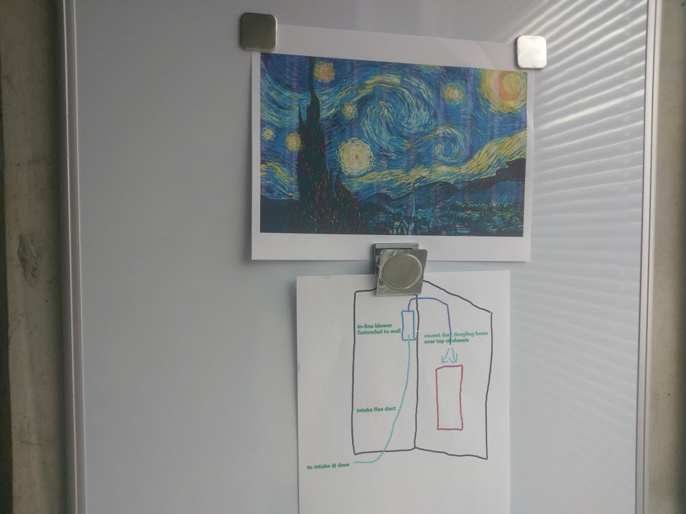

I feel that you are a bit reluctant to use my projected "exposed duct" method (you never mentioned the drawing):p

Are you kidding me right now? I love your drawing so much I hung it beneath my Picasso.;)
My apologies for failure to mention it - I haven't been my usual thorough self today, but hopefully you feel better now. ;) I'm not opposed to going the inline fan route, but considering the labor hours invested thus far, I would tweak installation as to hide it somehow. When it comes time to sell the property, I'd rather invest as few hours as possible "reverting" it to base state. Using my "working idea" (henceforth discredited), I liked that the only work on the back end was to be: 1. Removal of server rack and plywood backer, 2. Patching a few holes in the drywall behind it, and 3. Patching the drywall for the through wall fan. Obviously your approach would sub door replacement for #3.
Forgive my poor since of humor, my remarks are made entirely in jest of course.
Of course I'm kidding...
The picture rated a very hardy belly laugh and it's great to know my kindergarten grade drawing rates right
below Pablo Picasso :D

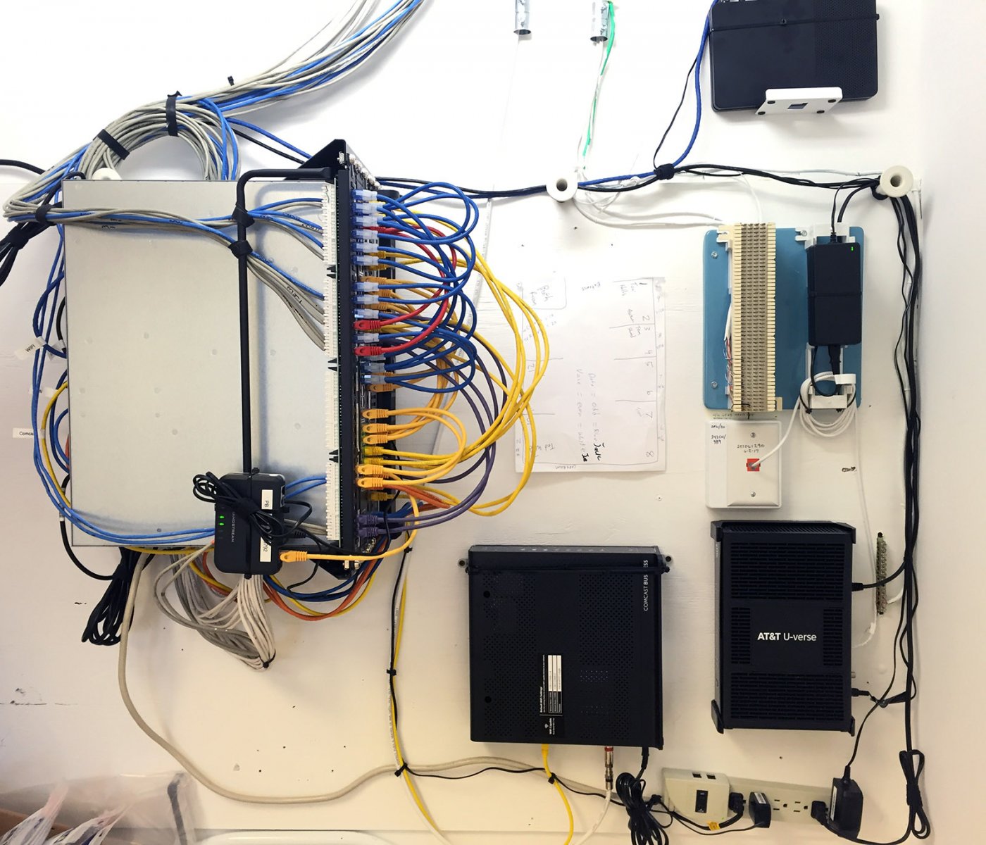

Here is the full backboard...
Were this closet more narrow, we would have mounted the AT&T and Comcast internet modems above or below the rest of the equipment. This configuration can fit in the tiniest of closets.
The other problem with putting the server face up is that anything that falls into the top of the server gets sucked into the box by both gravity and suction. What could possibly fall in? In my experience, everything. Coffee is bad. But so are the little copper wire trimmings from the network terminations. Mostly, whenever the ceiling tiles are touched, the box is dusted with ceiling droppings.

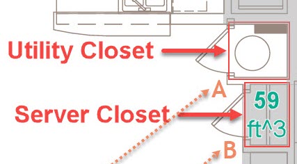

to be contained in the system (41" wide x 26" deep) and allows some room for future additions
So you have 40" of back wall in the closet? This would be prime for installing based on @MatthewSteinhoff example. Use a pair of the 4U brackets to mount the rack ears of your chassis and a third bracket to support the rear end of the server thus ending the upsidedown airflow issue now, by being horizontally mounted on it's side.

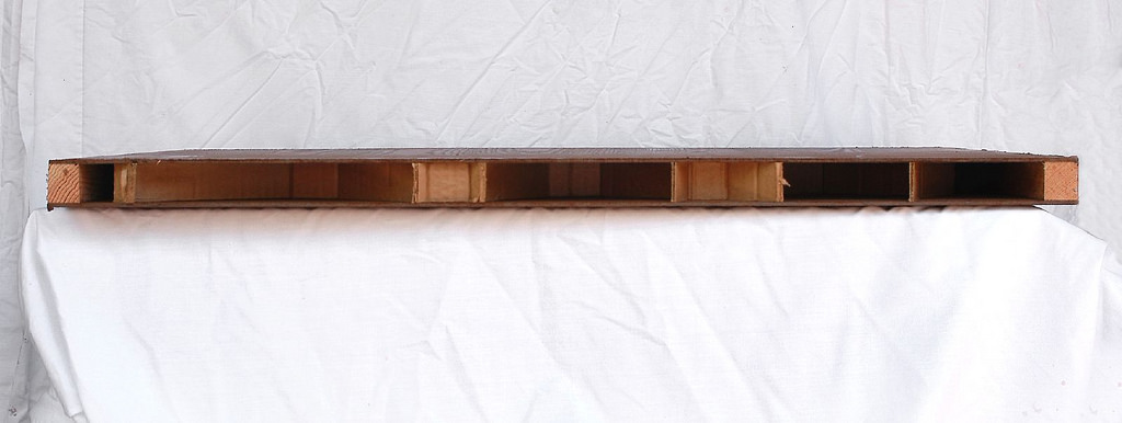

Stupid question: How to you tell whether a door is hollow or solid core without taking a Sawzall to it?
Knock on it really hard with your knuckles, if it does not hurt like hell, it's hollow core construction.
As you can see, the interior is very stiff cardboard that provide the outer skins a bit of rigidity. Most interior
doors are made this way.

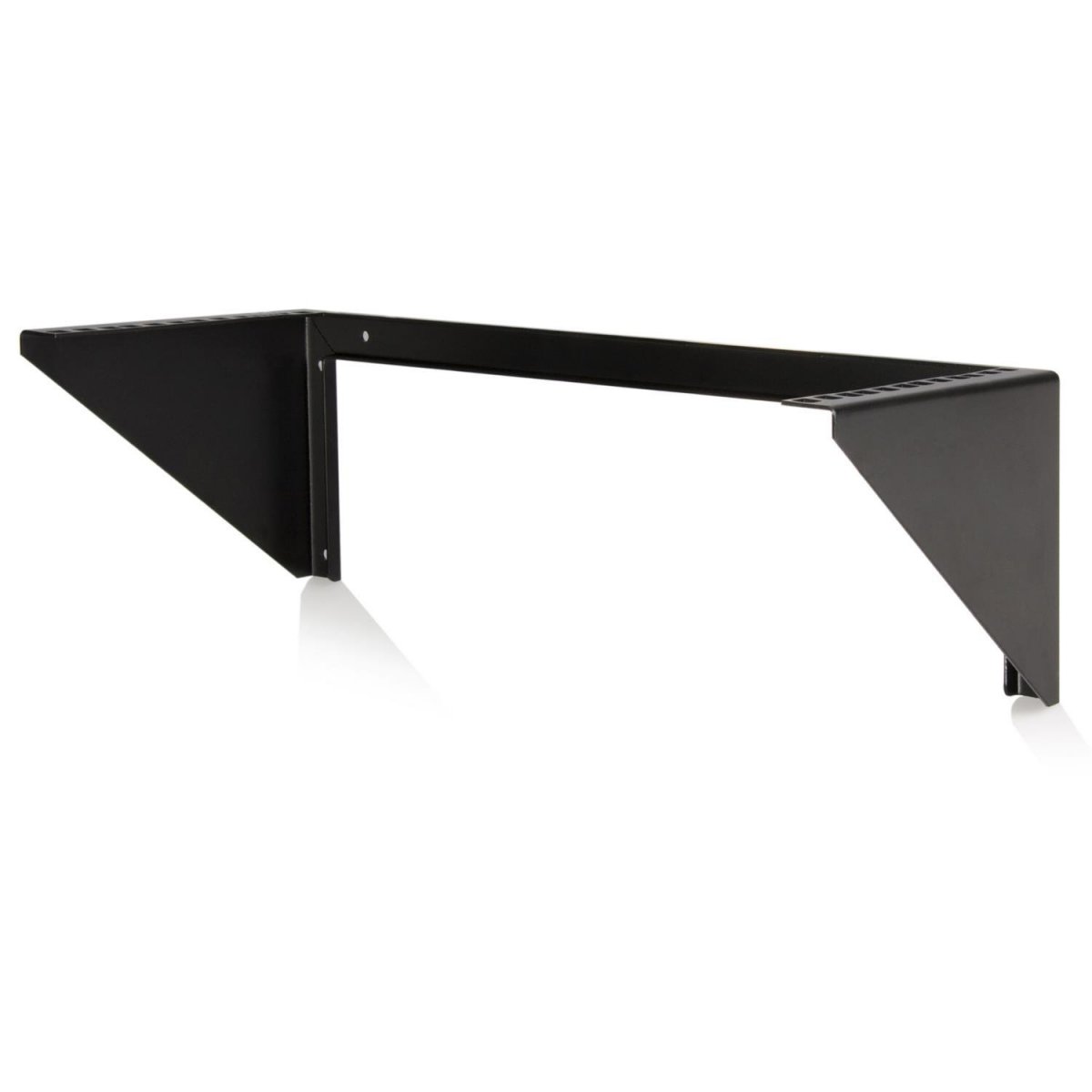

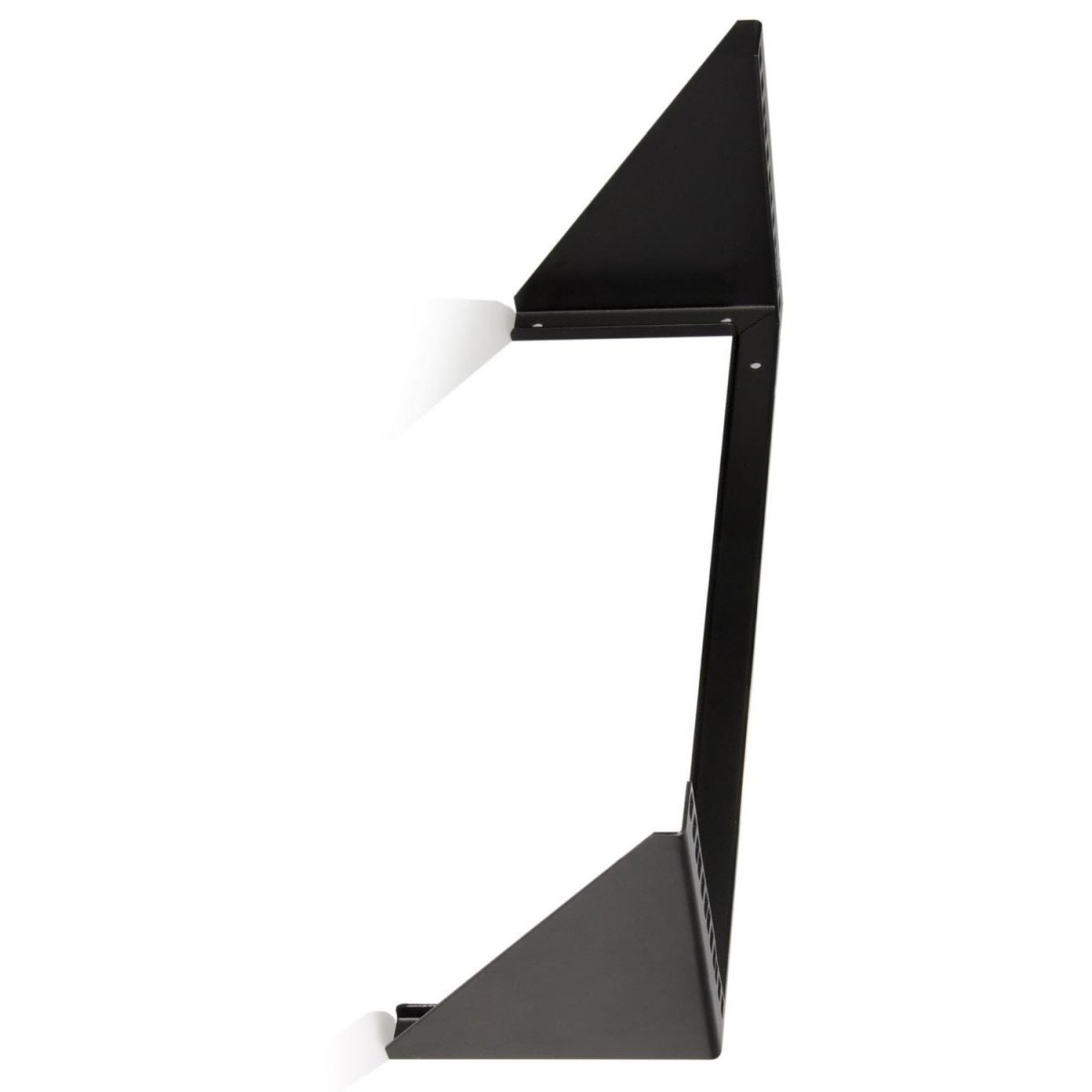

  • I'm assuming you use the brackets referenced earlier as intended (vertical) and mount by the rack ears omitting rails, but ..
  • What if you used a pair of those brackets, connecting one to the rear of the rails and one to the front, with the chassis bottom against the wall? [similar configuration as the picture you posted, but here we are contending with the weight of a server v. switching equipment]
  • I can dig it.
  • And I'd put a through wall fan / passive vent (no ducting needed in closet either way) where the X is with the front of the server facing it? The thing with an arrow on it is a built in computer desk, so quite easy to put an intake at floor level (above trim) tucked in that corner. I've never used that "desk" (piece of granite at desk height) and who could, you can't even line up two monitors side by side ... sheesh (kidding).
  • I've never used the brackets @MatthewSteinhoff described (or even horizontally mounted a server to be honest), and get the need for a third (or second as I proposed at nearly the same time), but why do you need two for the front?

Your back? The close encounter with the hollow door hurt my face! Kidding, I'm sure i ran into it chest first.
As you can see, the interior is very stiff cardboard that provide the outer skins a bit of rigidity. Most interior doors are made this way.
Definitely hollow core - thanks

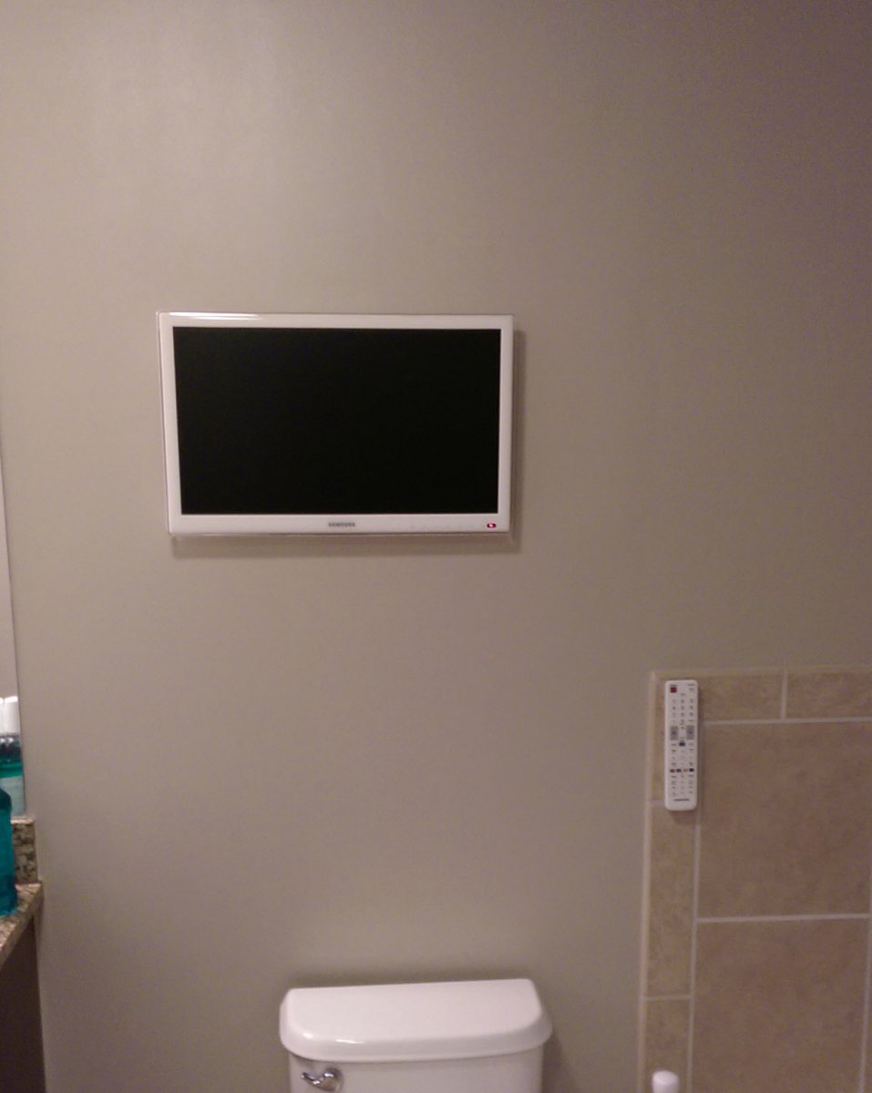

Not sure I understand ... is that weird? Not to mention a tv in the bathroom. It is great for watching pr0n in the shower. But I had to put a mirror on the opposite wall so I could watch tv while making a poop. Granted I put that there, but the baseboards came with pre-installed. Kidding about the pr0n and the mirror, I actually can't remember the last time I turned that TV on. When I installed it years ago, I thought it would be neat to watch the news in the morning showering, shaving, etc.

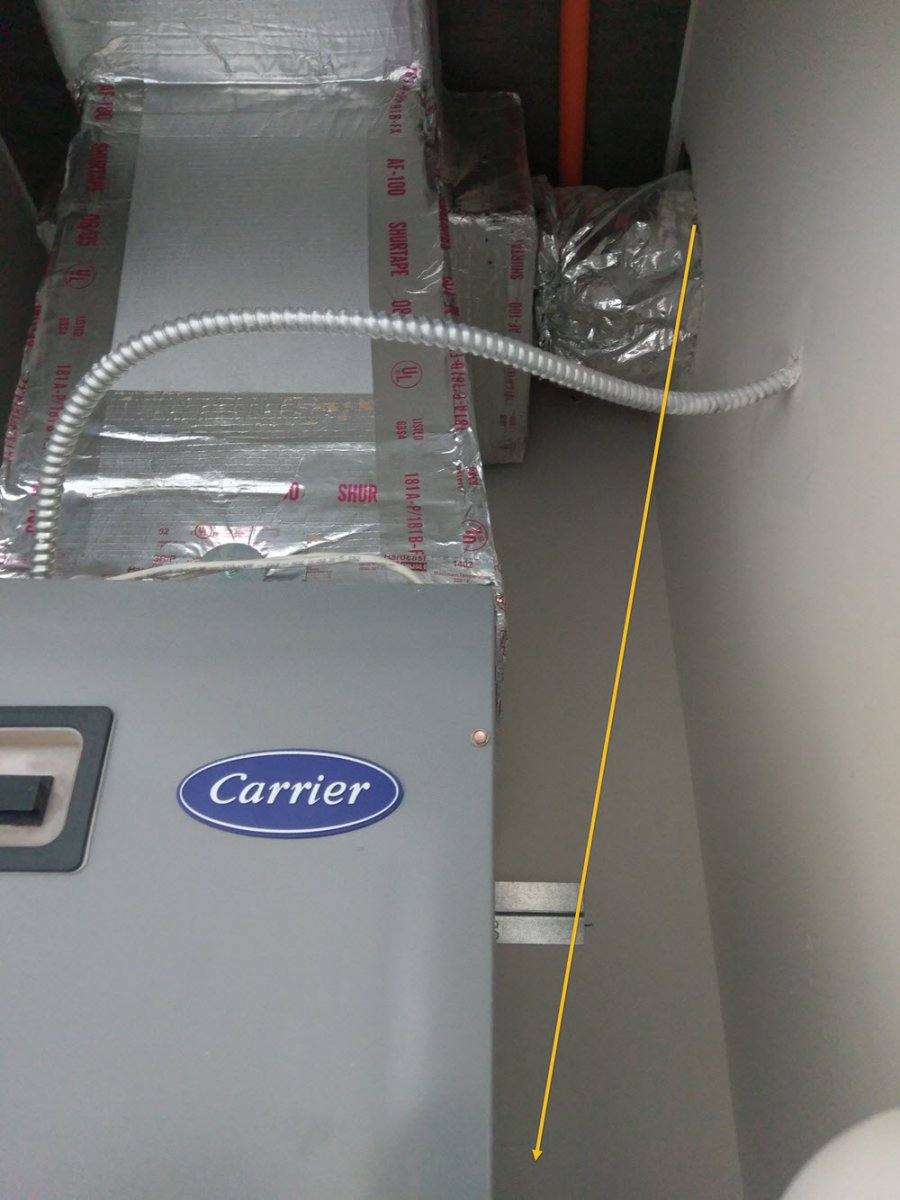

hrm ... I may not have much of a problem to solve ...
She has been suffocating in the closet with the door closed and no intake for the past hour. Regarding HDD temps, of those 60 minutes, only 4 were spent above 40C @ 41C and then the full speed fan profile kicks in to knock them back down. Ambient outside the closet is ~80F. Ref fan script log below (from 6:47 - 7:05 I was running a stress test in a 32 core VM I spun up, not that should drive up HDD temps, but def ambient in the closet).
When I say no intake, I mean no intake. I covered the closet floor with cardboard and taped it down cleanly with painter's tape (to protect the hardwood) so that takes up ~1/8" of the gap between the door and the floor. On one end of the door their is less than 1/8" of a gap and on the other no gap. I can feel the suction when I put my face at the floor. This is with no ceiling installed.
So, what does this look like with a ceiling installed (and even that crap fan I bought on) and the cardboard removed to allow here to breathe (without a separate air intake or maybe a tad of that door shaved to allow more air).

Turn from the position shown above, 90 degrees to the left or right depending on where you want the
front of the chassis to face (right or left).
OK - done.
I still don't see how you use two on the "front" side.
Granted I'm not the sharpest tool in the shed as is and it has been a long week.

OK - done.
There is two sets of square holes for mounting (that is the TWO I keep referencing), I'm
not thinking about the whole bracket being one piece of metal, but you're right, it's one
bracket with two mounting points. Sorry my bad! Where would we be
without pictures lol.
I would be interested to see of the A/C was running when you felt the air moving under the closed closet door.
Try shutting off the A/C and see if you can still feel moving air going under the door. If the return air space
is above the closet sheetrock ceiling, then the updraft in the closet will end once the A/C blower stops.
If the A/C return air is drawing from the closet, once you sheetrock the ceiling and get the fan working and
trim the bottom of the door, this may work!

There is two sets of square holes for mounting (that is the TWO I keep referencing), I'm not thinking about the whole bracket being one piece of metal, but you're right, it's one bracket with two mounting points. Sorry my bad! Where would we be without pictures lol.
10-4. Was worried my brain was boinked worse than it already is. I'm liking this idea.
I would be interested to see of the A/C was running when you felt the air moving under the closed closet door. Try shutting off the A/C and see if you can still feel moving air going under the door. If the return air space is above the closet sheetrock ceiling, then the updraft in the closet will end once the A/C blower stops. If the A/C return air is drawing from the closet, once you sheetrock the ceiling and get the fan working and trim the bottom of the door, this may work!
  • Not sure if the air handler fan was on or off previously, but I just killed power to it and I still feel a slight movement of air. I guess that means the closet has negative differential pressure v. living area?
  • There is one return air "vent" in the condo, and that sits on the underside of the air handler in the utility closet next to the server closet.
  • That 21.5" plenum above the closet serves as an area for distribution of HVAC (believe I mentioned that previously) and the image below shows the gap in between the duct and sheet rock, which when the fan is on, would account for that pressure differential (or part thereof).
  • Yet it persists even when off - interesting - not sure what to make of that.
I don't follow the comment about the handler drawing air from the closet with a ceiling in place? Perhaps you could explain that to me. Regardless, I should note, that I was just planning on putting an 8" piece of 4" duct on the end of that fan and then a curved elbow directing the exhaust straight at the concrete ceiling. Why? I've read that the minimum distance that you should keep ducting straight for is 2 x the diameter of the outlet and also I can't go much further than 8" anyway as the exhaust vent from the fan doesn't sit much higher than the drywall and any longer it would hit whatever you call the horizontal piece of metal that "frames" the ceiling of the closet (which you would screw the drywall into). In GA, it isn't against code to not externally terminate a vent in this case. Remarkably, bathroom vents don't even need to be externally terminated (which surprises me).
