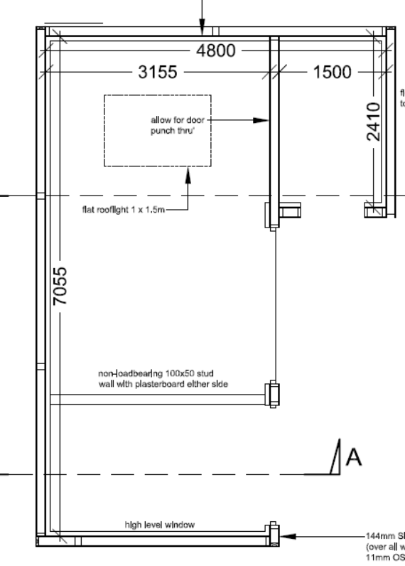

Having lost my house to fire that started on the ground floor (floor designations in UK lingo to match drawing), my two servers, workstation, and laptops in the first floor office to water damage, and everything in our second floor (attic) master suite to fire/smoke/water damage, just about the last place I would put my file server would be in an attic unless my "new office" were an obvious high risk location.
That's a good point and I'm very sorry you had to go through that. I'm limited with space unfortunately, but also didn't want to clutter up family areas on the ground floor and didn't want to create noise on the first floor (bedrooms), so it has to go in the attic. The new office has a moderate risk of flooding, I wanted to make the building higher, but then it would become and eye sore and likely not receive planning approval. The new office has gotten planning approval despite it's overbearing size.
(That's just under 16' x 23' in US lingo)

Thanks for the sympathy. Your situation understood. Make sure that you can keep the server cool, too, and set it up to email you if drives get towards the toasty side.

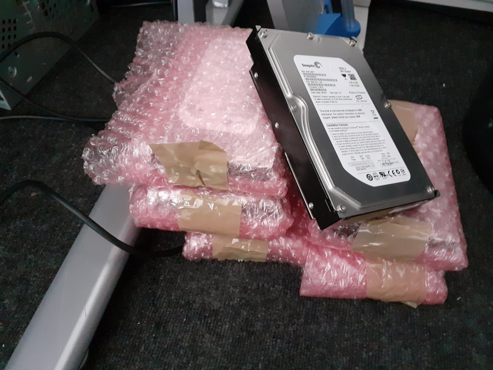

A little update, my 6 used 300GB drives arrived today, can't believe how quick the postage was, I was expecting them in 2-3 days. I also received the extra 4GB of ram, installed and they were successfully recognised by FreeNAS.
While I was looking at it, I changed a few BIOS settings and removed the audio and GPU card. Still works well and now I don't have an excessively noisy fan to tolerate.
Anyway, hope everyone is safe and well ;)

if you are planning on using the same RAM and HDDs for the actual FreeNAS install -- make sure that you burn all of those in correctly to make sure nothing's wrong with them.
I always burn in any NEW or USED components that I buy
Bikerchris
Mar 22, 2020
210
Thank you for that, I'm just working on my test build at the moment, it's a very old system but it will allow me to become familiar with FreeNAS, before I start depending on it.
I do have a lot to learn, especially with Hard drives, but my intention is to read up and bother you good folk as little as possible :)

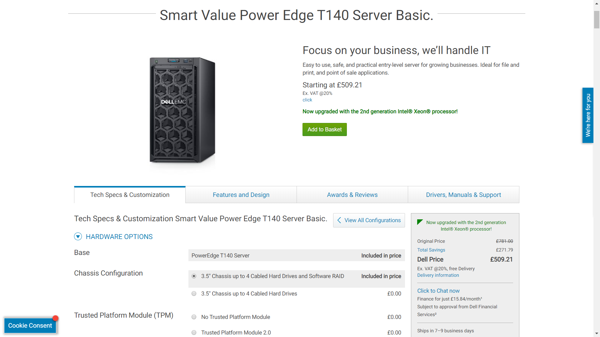

I am a little stuck with choosing the Windows Server come FreeNAS snapshot box though, it's quite a headache and it seems I can either:
Buy a nice ECC RAM box from Dell like the one below, for around £600 inc. TAX's
Or, build one based on a Xeon E-2124 CPU and Gigabyte Intel C246M-WU4 motherboard. The latter seems to end up costing around £600 as well...making it a bit pointless, but I can't see a cheaper way to do it. I'd like to avoid buying used, or something old which may mean loud.
Anyway comments very welcome and thank you for reading this!
