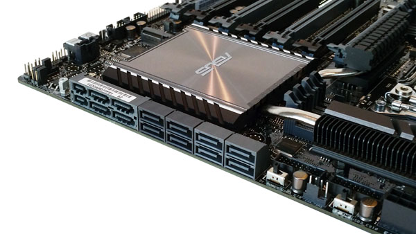

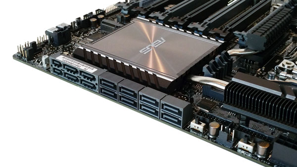

Doh, meant to attach a picture of the SATA :rolleyes:

wow ! sata ports on the edge of the board?? hopefully they won't face a wall in your chassis in a way that it would become difficult to plug in or remove a cable.
Yeah, it's one of the features I like about it, 3 years ago when I got it, I thought if it doesn't do a good job of workstationing, it must be able to do many other things. Luckily the orientation of them is towards the front of the PC chassis...phew! The other edge you can see, faces down and has button press, led things. Something I really like is a 2 digit trouble shooting code display, been helpful a number of times!

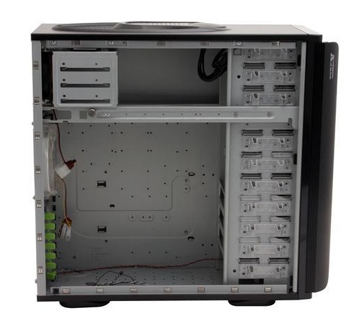

Just thought I'd amuse all by showing the case I'm using, it must be well over 10 years old and called a Thermaltake Armor:
it has space for an awful lot of drives, which is what interesting me even back then. Also I wanted a large case after struggling in small mid cases.
That might work in your chassis, but it still won't work in my SuperMicro 1U and even in my 2U server because the case fans (aka the jet engines) are right at that end --which would mean either no air-flow at all or at the very least very inconvenient cabling due to the fans being in between when trying to attach or remove SATA cables.
But then again, usually when you are using rack mounted chassis, people tend to get an HBA and call it a day.

I think I'm far from HBA, the case I have has the space for 10 hot swap caddy thingys on the front, so I'm happy with that..unless it ever gets too warm!

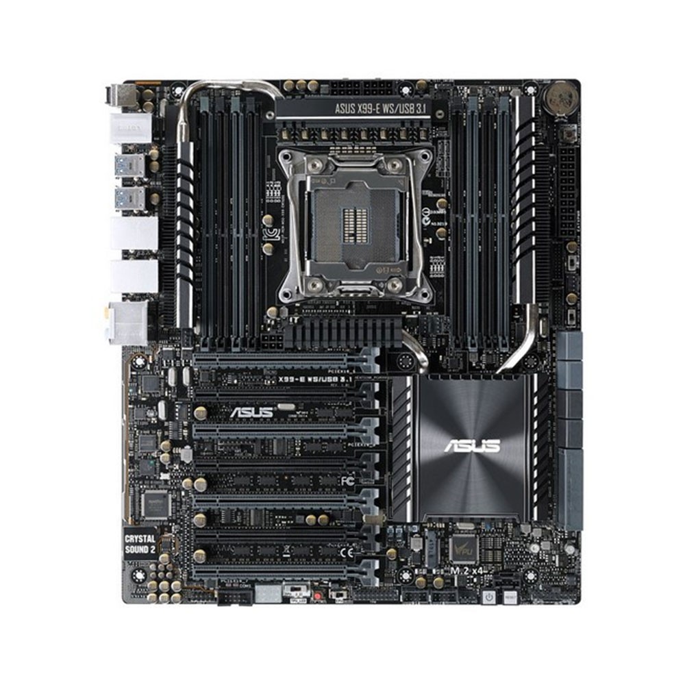

Thx for the picture - I've never seen such an arrangement before.
'Back in the day' it was supposed to be a fairly 'do all' board, it's a shame I don't use it to its fullest.

Oh, pic of the board...if you're....bored :rolleyes:

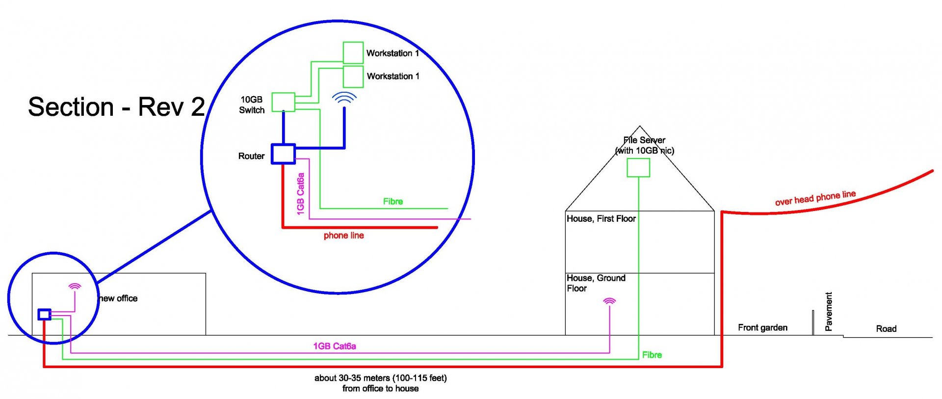

@inxible @sretalla @jgreco @Yorick @Redcoat
Just because I'm a bit bored, I thought I'd show my proposed network, guys over at Level1Tech forum have been massively useful.
