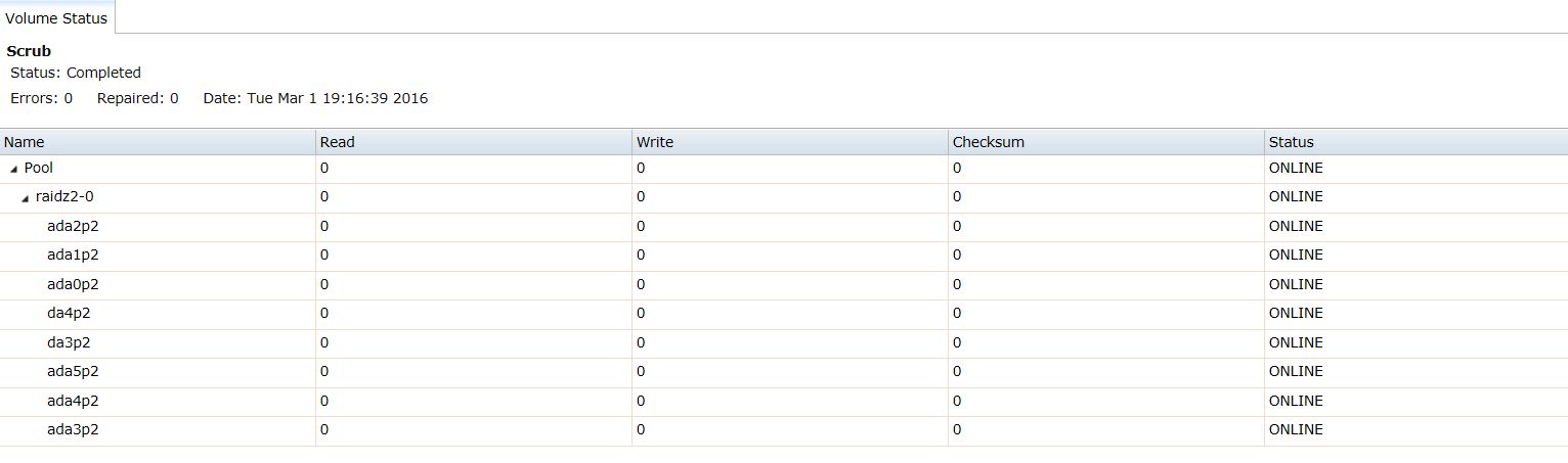

I am working on backing up my main freenas box (details in sig).
I have a Vdev which has 8x 6TB disks (setup using the 1meg recommendation) into a RaidZ2. I have a single Zpool called "Pool".
My understanding is that I can have two drives fail at the same time & still have my data intact.

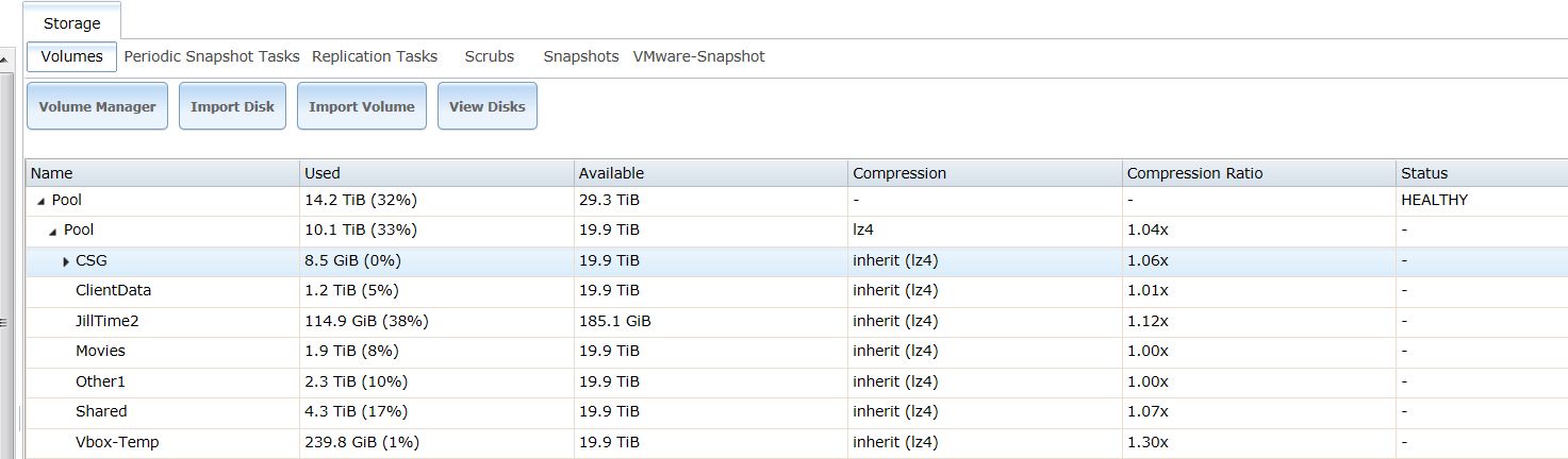

Pool size is 29.3TiB - I am a little confused as I thought Z2 would be 6x6 Tib or closer to 36Tib vs the 29Tib I have now. Do I have 3 actual disks for "parity"?
I am working on separate backup options for this setup (maybe two others).
Is my box sufficiently protected (generally speaking) for drive failure?

depasseg
FreeNAS Replicant
Sep 16, 2014
2,874
What is the output of zpool status?
And don't forget that 6TiB is roughly 10% smaller than 6TB.

Actually you have exactly 30 TiB usable (10.1 + 19.9) which sounds right as you have 32.7 TiB raw, minus the overheads and you get the 30 TiB you have ;)

So this all looks like the right amount of storage space & looks to be a decent design (not reckless)?
Bidule0hm
Server Electronics Sorcerer
Aug 5, 2013
3,710
Yep, I don't see any problem ;)
Just to be sure you know it: if you care about your data then backup it, RAID doesn't replace backups :)
