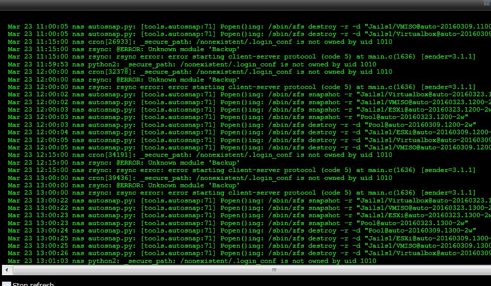

I have two freenas boxes - Box 1 is in my sig - called Nas, box 2 FNB (freenasbackup). So I looked at the manual & am confused.
Both boxes have a user Rich - both have the same passwords, both have permissions on the datasets.
Nas - \mnt\Pool\Storage (DATA TO GET PUSHED)
FNB - \mnt\backup (LOCATION TO GET PULLED
On both boxes I clicked on Services, Rsync, Rysnc Modules, then Add Rsync Module. I named it backup & pointed the path as needed. I left the comment blank, changed the user to my username.
I allowed the host (FNB), Hit OK.
I did the same thing on FNB.
On both boxes, I went to Tasks, Rsync task, I put the correct paths, put user as Rich, added appropriate Host IP, Rsync Module, Remote Module Name was backup.
Directions were set properly & it was set for 15 minutes (which could change later).
I hit OK, closed & went to Run task. It errors out (attached).
What am I doing wrong ?
This is on the same network (local), same version of freenas, etc.
Thanks,
Rich

Maybe that is the way to go?
My goal was to have a multi day sync of anything on my freenas (specific directories) copied to a new backup only box. The only other service running would be CIFS to access that data. I figured Rsync was the easiest way to keep files in sync on another box without looking though snapshot data and adding it to CIFS
I currently use snapshots when I realize something is missing, I goto snapshots, clone the snapshot, change permissions, then create a cifs share to access that data.
It seems easier to have Rsync setup & coping data periodically to a new source (untouched). However i cant figure out the setup.
