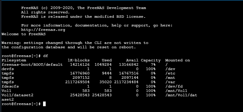

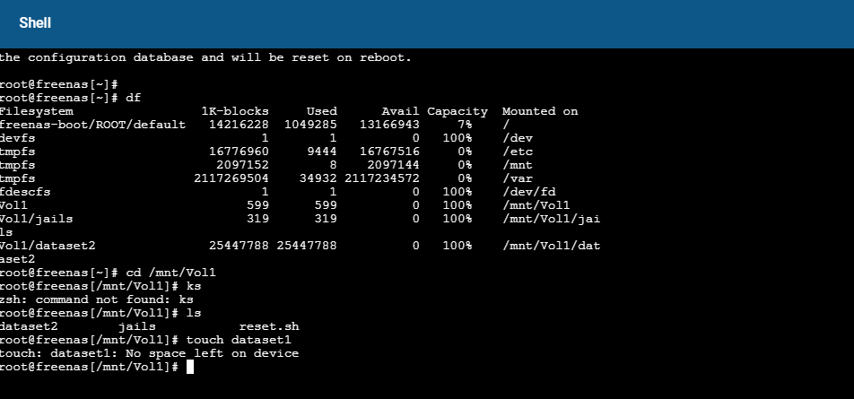

The Volume has 2 datasets (dataset1 and dataset2) and was 99% full before the crash. I am in the process of building a second NAS when this happened. The server also had 4GB of RAM but was only sharing an SMB share and nothing else. I have ordered another 8GB SIMM to bring the total to 16GB
So today, I first upgraded the RAM to 12GB (I had 2 8GB simms for the new NAS but one did not work). I then reinstalled the latest version of freenas and reimported the volume succcessfully.
However, I believe that I damaged one of the SATA cables as I can see 1 drive was reporting errors so for the moment I have a degraded volume (Im running RAID-Z2 so no data loss). I'm just awaiting a new cable to fix that problem.
The remaining problem I have is that upon reboot dataset1 was not mounted because it could not create the mount point because the volume is full. I have spent some time today removing data from dataset2 but deleting the file does not seem to reclaim any space. Does any one know why this may be ?
Once I can mount the main dataset I can remove data to get down to the 80% limit recommended by Freenas.

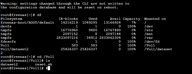

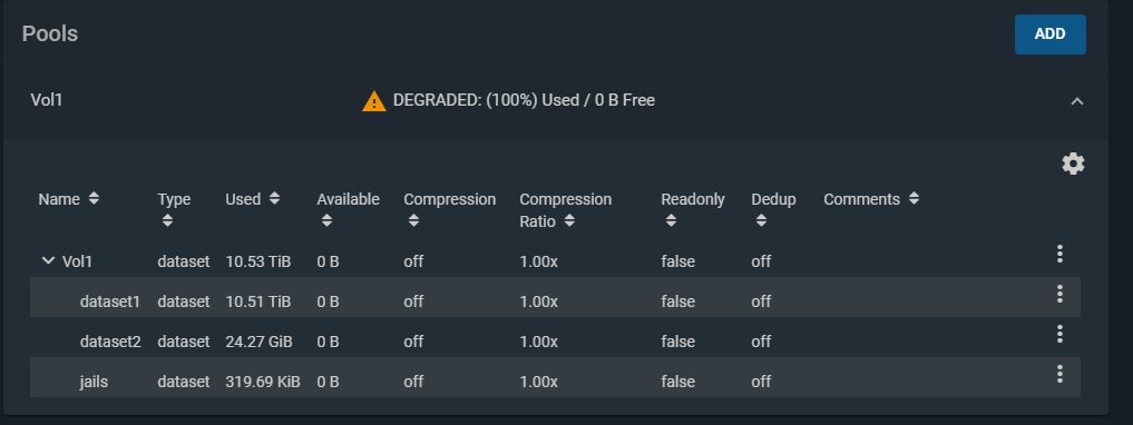

I have made some progress but I still have the issue that the Volume is 100% full and although I can delete some data from the dataset, the freespace does not increase even by a single block
I dont believe I have any snapshots
or recycle bins
Any help would be appreciated.
Many Thanks.

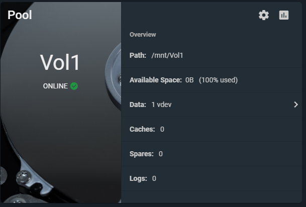

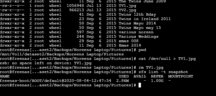

Oof. If you're truly 100% you're in a pickle.

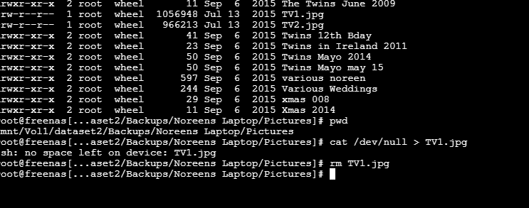

Try truncating and then deleting single file via:
# cat /dev/null > /file/to/delete
# rm /file/to/delete

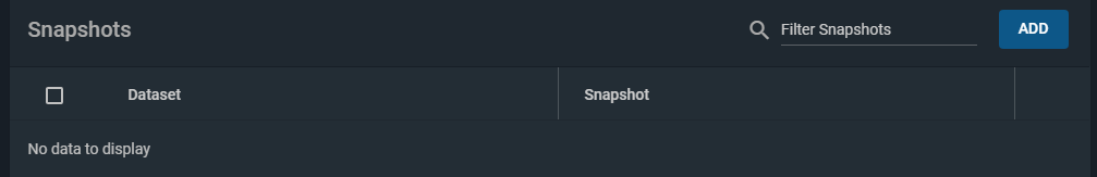

Do you have any snapshots showing via zfs list -t snapshot in the command line? (Outside of the boot pool of course.)

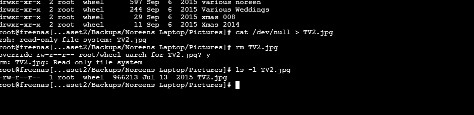

lessdrama
Aug 3, 2020
21
Hi
nullifying the file does not seem to work but removing it does (but it does not change the free space)
I dont have any snapshots apart from the boot pool.

lessdrama
Aug 3, 2020
21
Since your pool is full, there's really only one remaining dice to throw: Unmount your pool, and see if you can mount it read-only. This may allow you to access your datasets to evacuate data off the pool.
zpool export -f Vol1
zpool import -o readonly="on" Vol1
ZFS is really unhappy being that full, as there's no space for copy-on-write housekeeping for things like atime.
Hi
I mounted the volume readonly successfully but of course I can then nolonger remove files from the dataset.

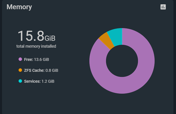

lessdrama
Aug 3, 2020
21
I have also replaced the failed SATA cable to the Volume is nolonger degraded and ensured that there is 16GB RAM available.

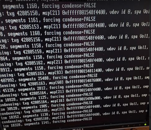

I did notice that I get lots of errors on starting the server as follows which I assume is related to the volume being full
Thank you for all the help so far.

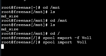

lessdrama
Aug 3, 2020
21
Deleting files isn't possible in a read-only mount. Did dataset1 mount? That was the point to try a read-only mount. The only thing you can do is to get files off to other media.
Once your data is safely offloaded, you can destroy the pool, recreate it, and put data back below the 80% limit.
Hi dataset1 did not mount because the mount point did not exist. Dataset 2 did mount.
I exported the volume again and tried to imported it but now its taking a long time !
and had not completed yet.

lessdrama
Aug 3, 2020
21
Another option would be adding a vdev to the pool (even if it's just a mirror of 250gb harddrives) and moving the data after that...
Hi I have now backed up dataset2 onto seperate media so I can do anything I want with that dataset including removing it if needed (although Im not sure that will actually free up the space either)
I dont have any free sata ports left. Would adding a vdev of 2 drives connected via USB be acceptable ?
Finally, 99% of the data is consumed by dataset1 which I cannot mount as the mount point not exist
Would it b e possibleto umount dataset 2 and mount dataset1 on its mount point. Then I could copy everything to the new NAS that I was setting up

Samuel Tai
Apr 24, 2020
5,399
If you're sure you've offloaded dataset2, then you can zfs destroy -rf Vol1/dataset2. This should free up a good chunk of space, and allow you to set the mountpoint option for dataset1.
Please don't use USB for VDEVs. USB controllers can't really handle the usage patterns of ZFS. They're really only capable of dealing with FAT32 partitions.
