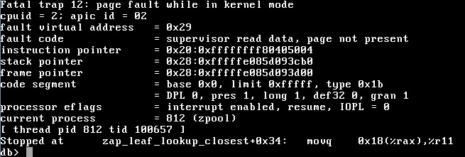

I've had six 4TB drives in a RAIDZ2 volume for two or three years now staying on the latest stable build of FreeNAS. I just noticed tonight that it has apparently started rebooting itself and reporting the "Fatal trap 12: page fault while in kernel mode" error. I have tried booting in to a previous version, reinstalling and importing backup, and installing from scratch, re configuring and attempting to import pool.
None of these have worked for me. I have 12-14TB of data in this pool that I would really like to salvage. Yes, the important stuff is backed up, but ZFS has always been so rock solid, I can't image that my data is gone. When I attempt to import the volume from either the GUI or command prompt, I see the identifier listed and it allows me to start the import. After several seconds, the machine reboots, and still no storage volume available.
Any ideas. I have done quite a bit of Google and forum searching already, and no suggestions that I have read appear to apply to my situation.
Please let me know if this should be posted elsewhere, and thanks in advance for the assistance.

Did you try all of this from the same boot device? In other words, have you tried another USB stick?

Can you provide System Hardware Specs? Also, what HBA/Controller you are using for the drives?
Normally a "Fatal trap 12" can be due to RAM issues, but other things like running a Hardware Raid can also be the issue.
Here is a similar thread on the that error: "My freenas wont start up. Fatal Trap 12"

USB Flash Drives are a high failure component in a FreeNAS system. If you can replace it with a single small SSD then you would be doing yourself a favor in the long run. But for now, Dru requested you try a new/different USB flash drive and to see if that helps. Please use the current version you were using when the failure occurred, no need to inject another unknown yet.
My first thoughts were if you have been running routine SMART testing and now you may have several drives which have failed, or you may have other hardware component issues such as bad RAM or power supply.
1) Please post your list of hardware and what version of FreeNAS you are running.
2) Run Memtest86 on your system for 48 hours minimum.
3) Post the output of "smartctl -a /dev/adax" (where x is the drive identifier)
EDIT: You can do step 3 before step 2 if you like but you need to do both.

I would advise against doing that.
My guess, is that it's a hardware problem, ie. mobo/cpu/ram.
I ran into the "Fatal trap 12" error back in May 2012 and couldn't track down the problem. With more money than time, I ended up replacing the server. My drives imported just fine and I haven't had a problem since then.

So within the last six months I completely overhauled this system from consumer grade hardware that I had laying around to hardware that was recommended in the forums, wikis, etc. I ran the whole setup, non ECC and all with no issues whatsoever for two years or so. Now that I have more robust components, I seem to be having more issues. See below.
SuperMicro X10SLH-F
i3-4130 @3.4GHz
2x Crucial 16GB Kit (8GBx2) DDR3/DDR3L-1600MT/s (PC3-12800) DR x8 ECC UDIMM Server Memory (32GB)
2x Intel PRO/1000 Dual Port Server Adapters
6x 4TB WD Red NAS drives connect directly to the six SATA ports on the board.
PCIe SATA adapter is my next purchase, but I have not been down that road yet. With that said, it goes without saying that I do not have a spare SATA port to set up a boot SSD, although I have about half a dozen 64GB drives laying around my office. I guess I could use a USB to SATA adapter, but have not really expored that either.
Could be forgetting something, doing this in a hurry. I will say that I have been building consumer grade PCs for 20+ years, but the setup for this board has several options that I've had to do some digging to know for sure if they are set correct for FreeNAS and ZFS RAID.
I was just going through it and saw a setting called "SATA Frozen" that was enabled. That didn't look right to me, as I am using all six SATA ports on this board for my NAS drives. Is this ok to have enabled?
Also, it appears that for some reason there is a watchdog on this board. I'm not sure if it is from the BIOS/EFI part of the board or if IPMI is doing it. It is getting logged in IPMI, but the setup utility has an option to disable it.
I'm working on exploring these options. I just think its funny that it's worked for 6+ months without a hitch.
If anyone can shed some light on any of the above mentioned topics, it would be greatly appreciated. I will be getting the smartctl output requested and running memtest probably sometime tonight. Thank you for all of the responses. I hope I put my faith in the right file system this time. :)

So, I have made a bit of progress, but still trying to make sense of it all. If I manually import the volume from the command line using the -f switch to force the import, the computer reboots and when it comes back up, from the command line, "zpool status" shows the volume. The web GUI does not. The web GUI actually shows the drives as available to create a new pool, which is very unsettling. Could this possibly be a simple mounting issue at this point?
I also read a forum not specific to freenas, but about the same situation, that with the the relational style file system, snapshotting, etc., that there is a way to restore it to an earlier version in time and correct the corruption, during the import process with a few other command switches.
I'll keep looking in to it. In the meantime, I have attached the requested output for all six physical devices in my pool. If anyone sees something obvious that I'm missing, please let me know.
