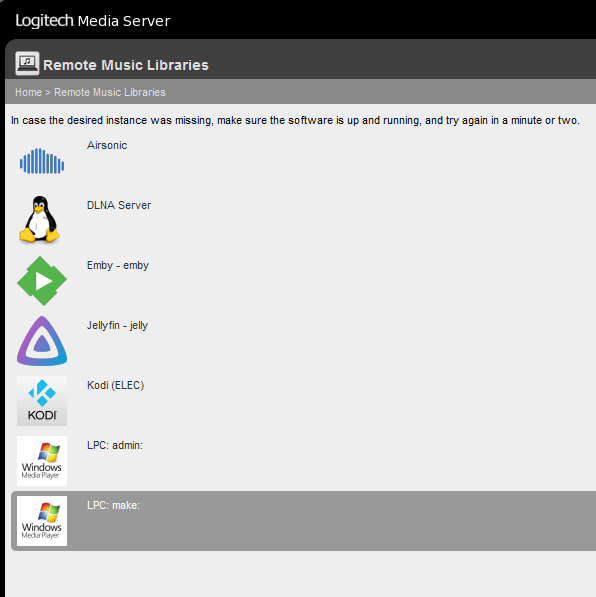

Remote Music Libraries not working right…!?​
I set up a fresh Basejail and installed LMS via lms_installer
FreeBSD LMS-8 12.2-RELEASE-p11 FreeBSD 12.2-RELEASE-p11 75566f060d4(HEAD) TRUENAS amd64
Logitech Media Server Version: 8.2.1 - 1632112486 @ audiodigitale.eu 01-10-2021
Hostname: LMS-8
Server IP Address: 192.168.x.x
Server HTTP Port Number: 9000
Operating system: freebsd - EN - UTF8
Platform Architecture: amd64-freebsd
Perl Version: 5.34.0 - amd64-freebsd-thread-multi
Audio::Scan: 1.05
IO::Socket::SSL: 2.072
Database Version: DBD::SQLite 1.66 (sqlite 3.32.3)
In "Remote Music Libraries" enable this option
Enabled, look for other UPnP/DLNA media servers.
and see my DLNA servers…
But only the Windows Server and KODI return proper file lists I can play — all others only return empty dir/folder listings!
In an older Jail with an older install, all Servers are working fine:
FreeBSD LMS8 12.2-RELEASE-p11 FreeBSD 12.2-RELEASE-p11 75566f060d4(HEAD) TRUENAS amd64
Logitech Media Server Version: 8.0.0 - 1598791476 @ audiodigitale.eu 31-08-2020
Hostname: LMS8
Perl Version: 5.30.3 - amd64-freebsd-thread-multi
Audio::Scan: 1.02
IO::Socket::SSL: 2.068
Database Version: DBD::SQLite 1.58 (sqlite 3.22.0)
Anyone got this issue, too?
Anyone willing to test?
Cheers
