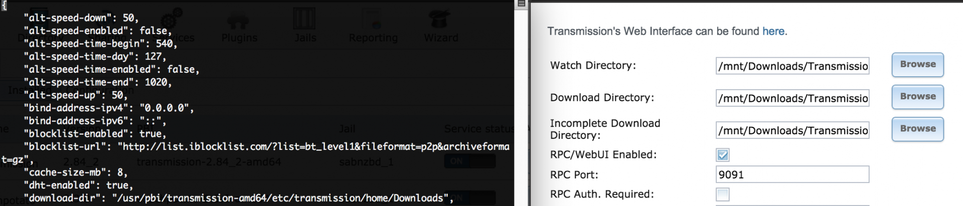

MtK
Jun 22, 2013
471
Hi @Joshua Parker Ruehlig,
I just updated to Transmission 2.84_2 and the download_dir is getting overwritten as soon as transmission starts.
(even if you edit it by directly editing the config file)
is this a known issue?

how are you trying to set it? Ideally you set it from the FreeNAS WebUI (left panel, transmission icon).

MtK
Jun 22, 2013
471

MtK
Jun 22, 2013
471
Can you please show the contents of /etc/rc.conf, that's a spot it can sometimes be set.
What did you put as your blocklist setting? Can you try fetching it from the jail's commandline?
I edited the post too late, the blocklist issue is solved.
the settings were reset after the update.
the download_dir issue remains:
