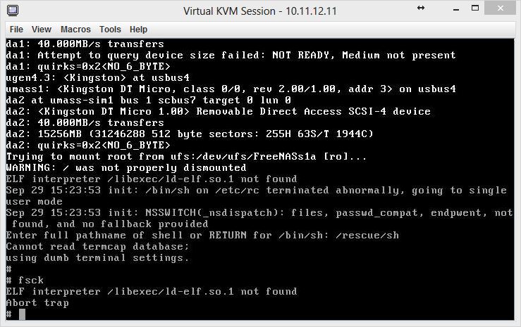

Hi.
I have a installation with FREENAS 9.1.1 in a usb flash disk kingston 16Gb. After a power outage, Freenas don't boot, show this message: (see picture)
WARNING: / was not properly dismounted
ELF interpreter /libexec/ld-elf.so.1 not found
If i try start /rescue/sh shell, the commands (p.e. fsck) don't work
I execute fsck -t ufs -y /dev/da2s4 in a shell, but give much error for "CAM"
What I can I do to restart freenas?
Thanks you, regards.

My advice is to take a separate USB drive and load FreeNAS on it and boot that. If you made a backup of the same release version then you can restore it and reboot and everything will hopefully be restored. I say use a second flash drive because if that doesn't work, maybe someone could talk you through fixing the corrupted one.

So you won't be fixing the db file, you need to start over with respect to creating the USB stick. Once done you can "Auto Import" your storage. From there you will need to redo all your setups. Once done, crate a backup of your configuration. Check out the FreeNAS manual for that help.
