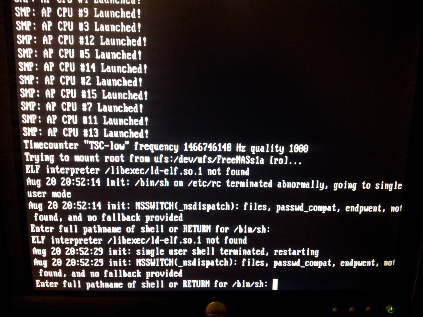

I've installed FreeNAS 9.1 using regular CD installation. It installed normaly. After reboot, it shows me the following error:
"Trying to mount root from ufs:/dev/ufs/FreeNASa1a [ro]....
ELF interpreter /libexec/ld-elf.so.1 not found
Aug 19 19:47:02 init: /bin/sh on /etc/rc terminated abnormally, going to single user mode
Aug 19 19:47:02 init: NSSWITCH(_nsdispatch): files, passwd_compat, endpwent, not found and no fallback provided
Enter full pathname of shell or RETURN for /bin/sh:"
I can't go forward, please someone can give some assistance ? I never used USB drive ...

I start over into new installation, using CD and Thumb drive. The installation went well, recognized the USB drive correctly, but after rebooting, still have same problem.

yes I change it. My HW is IBM server X3550 M2 model. Regarding the old HDD config with Raid1, I took away (including HDD) There is no embebbed HDD in the server... Attached to this server I have 2 storage with each 12 x 600 GB disk in RAID5 mode using Megaraid SAS 8480 card.
Attached the picture with error ...
