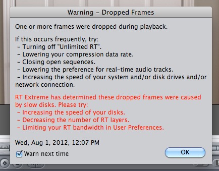

Hi Everybody here. Sorry for my English at first :),I am the new user of FreeNAS. My server and client configuration is:
Server:
INTEL E5-1620V3
SUPERMICRO X10SRL-F
64GB REG ECC DDR4 2133 MEMORY
8GB USB DRIVER FOR FREENAS
LSI 9211-8I WITH IT MODE
24* SEAGATE 8TB ENTERPRISE HDDS running for RAIDZ2
6*Intel X520 DA2 dual ports 10GB SFP+ adapter for 6 clients machine for directly connect.
Client:(Others almost same)
Mac Pro 6,1 install MAC OSX 10.9.5 system
Intel 4 cores E5
32GB ddr3
D300 dual Graphic card
256GB SSD
Promise Sanlink2 10GB Ethernet SFP+ adapter
Test environment speed in AJA system test is 900mb-1000mb/write and almost same in read (very good).
Real environment speed in MAC OSX (afp and smb)read and write via sanlink2 is 500mb-950mb/S(I have a lot of small file so sometime is high sometime is low) and stable. (very good)
The problem is:
When the clientmachine using Final cut pro7 always has error like in the attachment picture (Dropped Frames), playback or recoding to tapes both same(3-4time each day), but its never happened at before when we using local driver.The media format is 1080P prors 422 code. Anybody has experience and any advise? May be something I need add in sysctl? Thanks a lot.

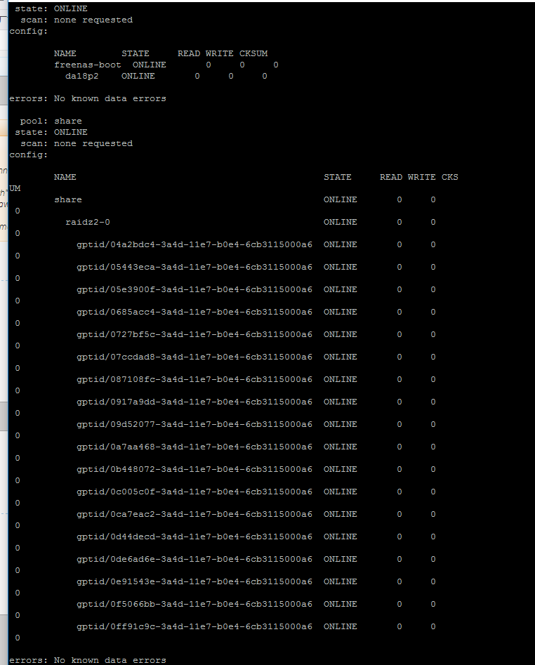

Have is your pool structured?
can you provide the output of zpool status in CODE tags?
skyyxy
Jul 16, 2016
136
Hi Stux, Thanks for your reply
Now im at home and also has the almost same server in my home, the only different is home's server just 18hdds not 24hdds and also raidz2 mode. please check the pool structured picture in the attachment, Thanks again.

Stux
Jun 2, 2016
4,419
Okay, thats what I feared.
So, you have a 24-way RaidZ2?
I would strongly suggest you refactor your home pool into 2 9-way RaidZ2, and your ... work?... pool into either 3 8-way RaidZ2, or 4 6-way RaidZ2.
3 8-way if available space is more important than performance, 4 6-way if performance is more important.
This will cost you a little bit of extra parity (ie reduced storage), but will double your IOPS at home, and triple or quadruple your IOPs at your other location. IOPS are random access operations... which happen, even if you're streaming video.
Also, it will make it so that if you have a raid error the resilvers happen 4-16x faster, which will reduce the chances of an additional error happening.
I don't know how slow it is, but as you scale from a sensibly sized RaidZ2 (say <=9 drives) it gets slower and slower.
I'm suspecting your issue is caused by the excessively wide nature of your single vdev pool.
Of course, the trick is, how do you refactor your pool? Unfortunately, you basically need to back it up and restore it. You should have a backup anyway ;)
As a benefit, because your 24-wide pool is using 20GiB of parity/padding (even though you'd expect it to use 15GiB), if you change to 3x8 RaidZ2 you'll be using 50GiB, whcih is only 2.5x, even though you've tripled the parity. A free 10GiB due to inefficient padding at 24 way.
9-way is even more efficient than 8-way.
