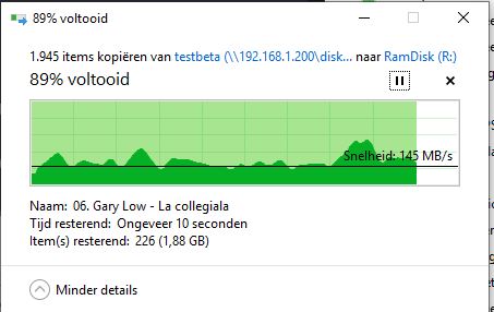

- actual reads: 150MB/s (copy-paste 20GB-batch of 10MB-files; file-cache nearly null (ARC claimed for Metadata); read from NAS, write to RAMdisk)

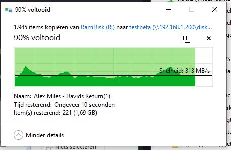

- actual writes: 300 MB/s (same but vise versa)

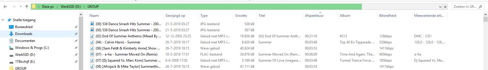

- Directory-listing: (opening a folder in Windows Explorer... waiting for the file-data to come on screen...)
- opening folder from FreeNAS-share: 25 files/sec (often also totally stopping/halting)
- opening same data-folder, from an old 1TB harddisk, under Windows: 50 files/sec (non-stop).

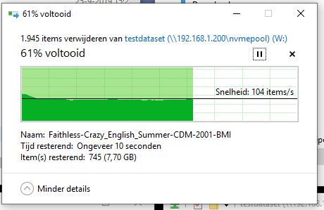

- Deleting files: (right-clicking a folder in Windows Explorer and deleting it)
- from a folder from FreeNAS-share: 100files/sec
- same data-folder, from an old 1TB harddisk, under Windows: 1000 files/sec.

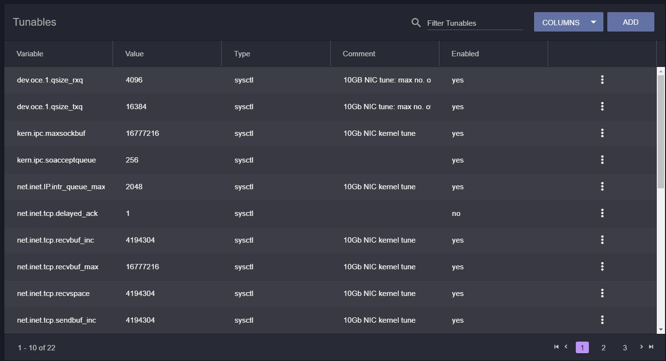

- In the NAS/Interface-setting:
- added the 'MTU 9000' (to use the large segment size)

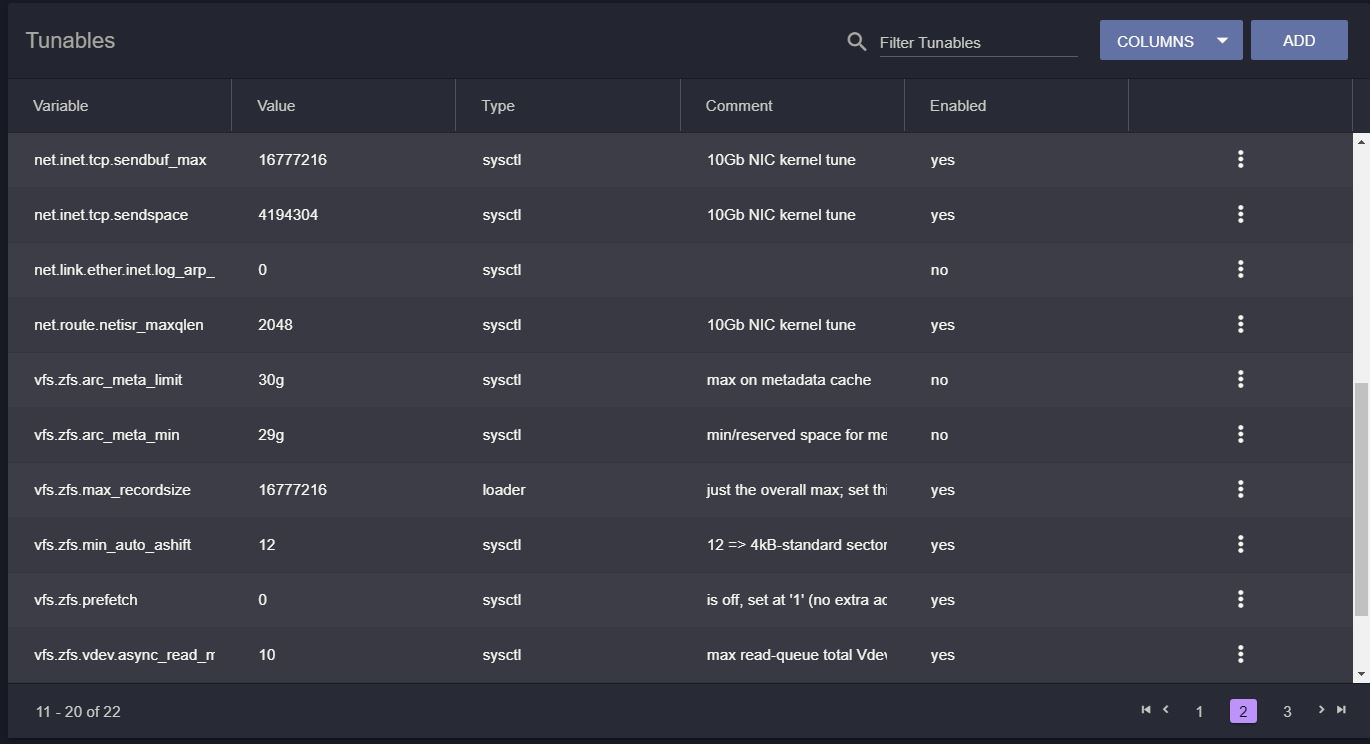

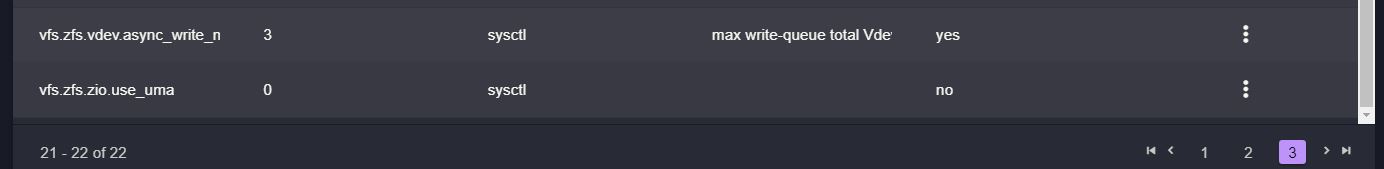

- Furthermore for the NAS-NIC: added a series of settings in the Tunables (please see the screenshots ‘Tunables (1)(2)(3)’ in the attachments

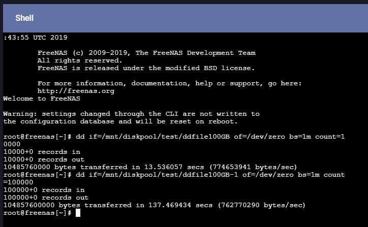

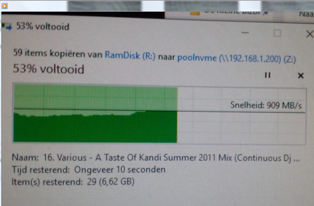

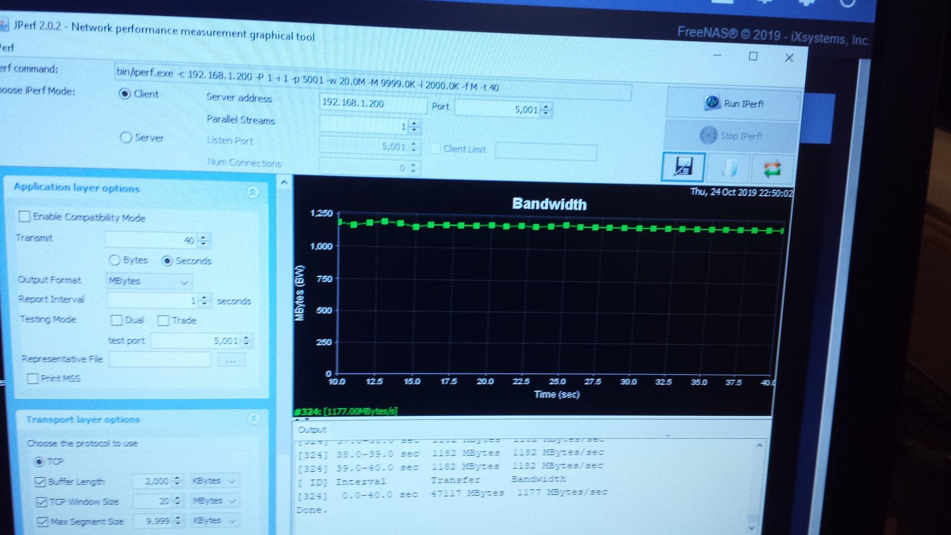

- Iperf-test gives 1200MB/s (and I also managed to get about 900MB/s accross when doing real copy-paste of very large files, using a NVME-SSD as pool), so it looks like the (10Gb) NIC to NIC speed is OK

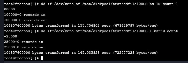

- dd-test gives 700MB/s write and 750MB/s read; so diskpool-speed is also OK (although the pool is 8 disks and each disk has a seq speed of 200; so 1600 reads is the potential of the diskpool; looks like the RaidZ2 results in say loosing half the bandwidth)
- real transfer-speeds when doing copy-paste of a 20GBbatch of files, being 10MB in size: (file-cache limited by claiming almost all ARC for metadata-cache)
- reading from NAS, writing to RAMdisk on WindowsPC: 150MB/s
- writing to NAS, reading from RAMdisk on WindowsPC: 300MB/s.

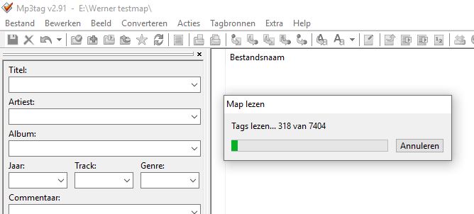

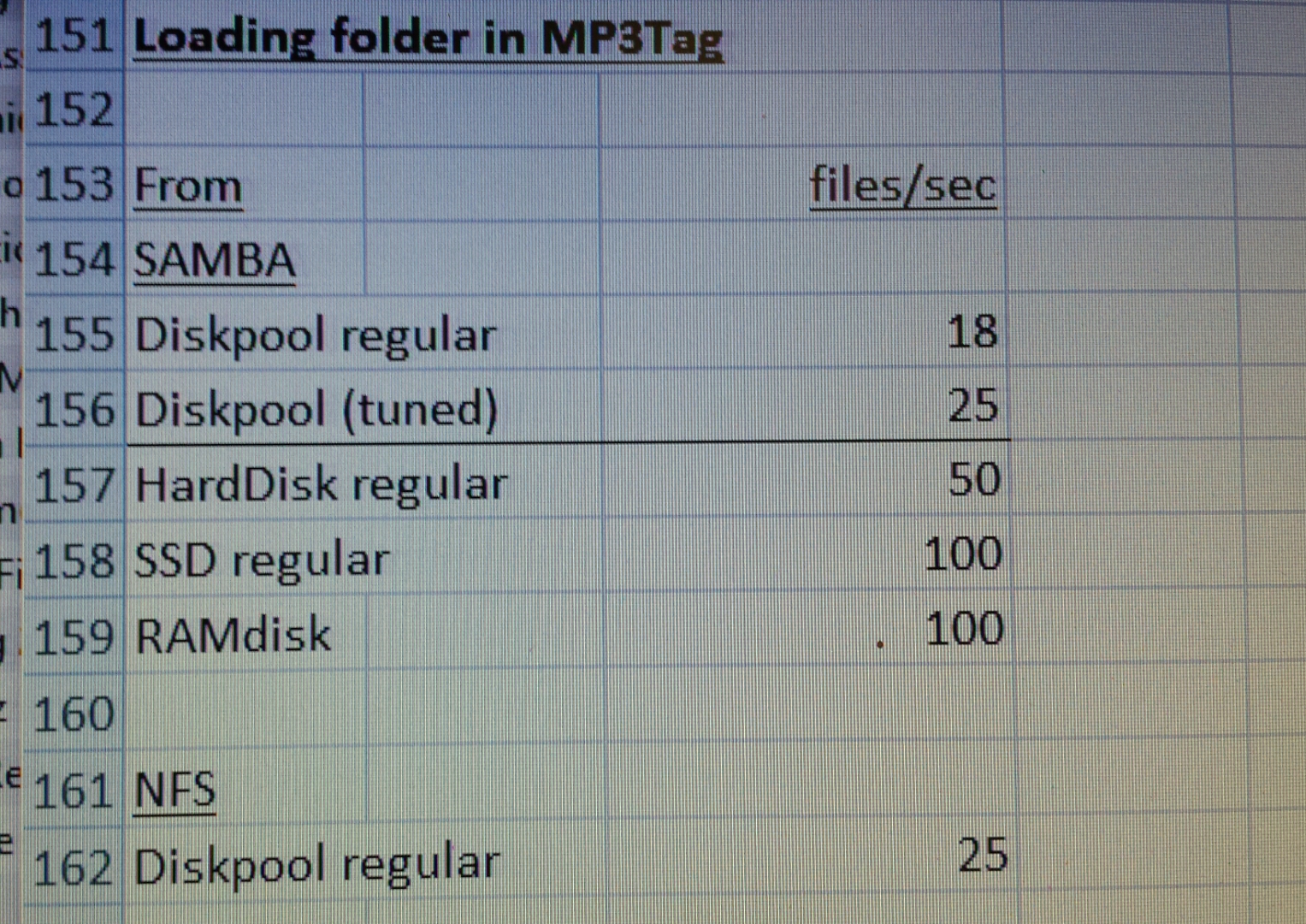

- Directory-listing (opening folders with lots of files and waiting for all tag-data to list):
- 25files/sec (vs 50 files/sec for an old, simple harddisk, under Windows direct)

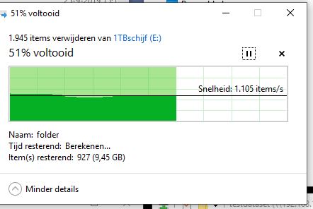

- Deleting folders/lists of files:
- 100files/sec (vs 1000 files/sec for an old, simple harddisk, under Windows direct).

network speed test (writing to NAS, using NVME-SSD pool (1GB-size files) (~900MBps).PNG1.3 MB · Views: 517 -
dd test WRITE to Diskpool (100GB-file) (1 resp 4MB bs) (~700MBps).JPG38.5 KB · Views: 491 -
