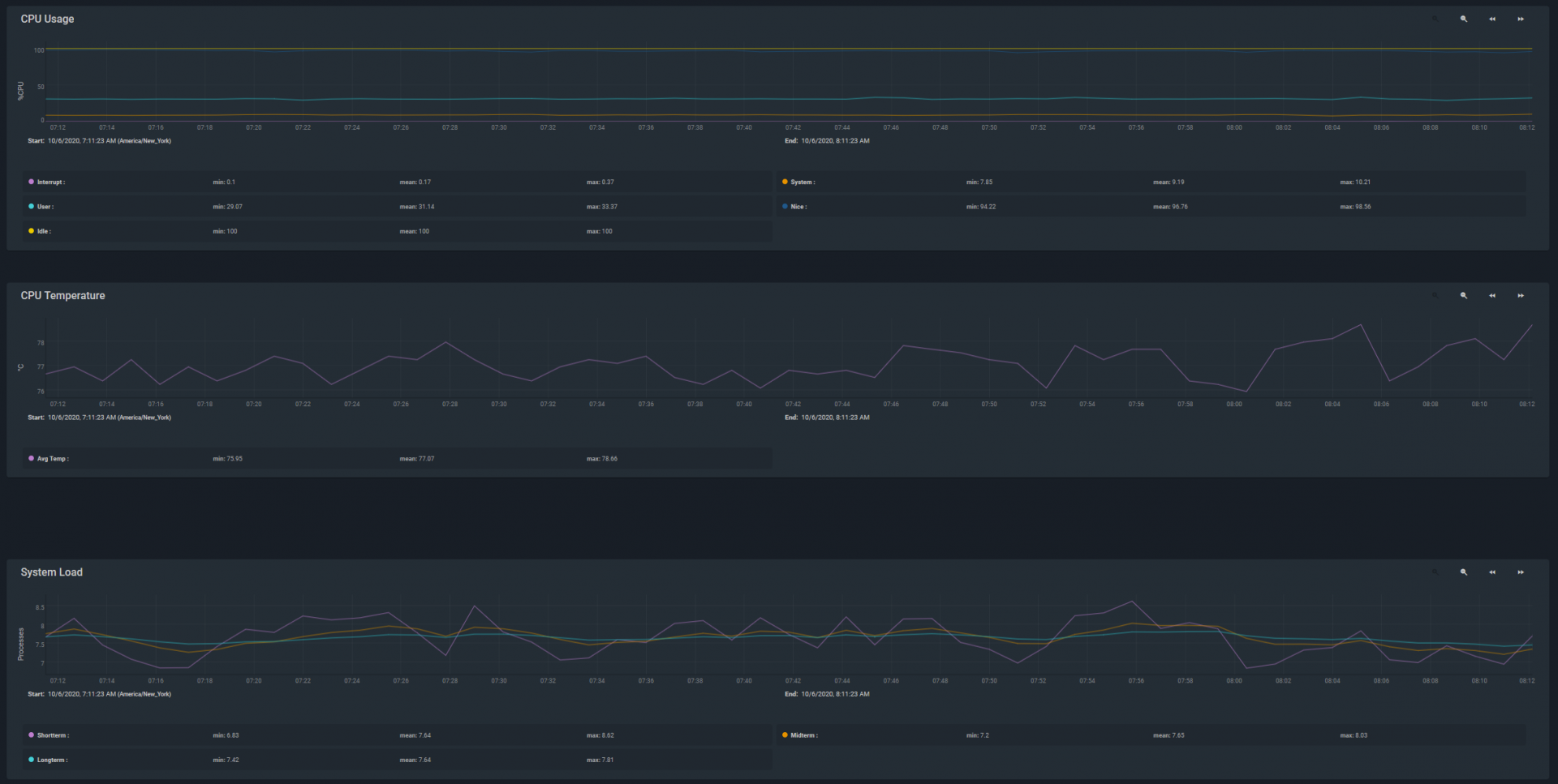

Anyone experiencing high CPU usage after install Zoneminder?
Zoneminder's console only reports 5-10% usage with 3x 5MP cameras running. FreeNAS system load never goes above 10%, however CPU usage is pinned at 100% and my temps in the high 70s.
CPU: Xeon E3-1220 (I'm using the stock cooler, so maybe it's time to reapply the thermal paste?)

I am using MoCord on 3x 5MP Cameras. Recording at 15fps.
I am using h254 passthrough with video writer.
CPU is now pegged at 60% across all four cores according to FreeNAS. Goes up to 80% during events. (Temps unfortunately are also pegged around the 70-80 degree range, so there's probably some throttling happening)

Sorry this probably should not be in this thread - deserves a separate one. Not surprised on your cpu with 3 cameras doing motion detection @5mp 15fps, you are asking a lot from the cpu. Can you not use one of your three cameras in motion detection mode to add events to the others? Or use a low res/fps stream to do the MoCord to identify events?
My one camera has 2 streams - stream 1 is high resolution 15 fps, stream 2 is setup as 6 fps and 800x600 (or similar).
Stream 2 does the motion detection which triggers stream 1 to record.
