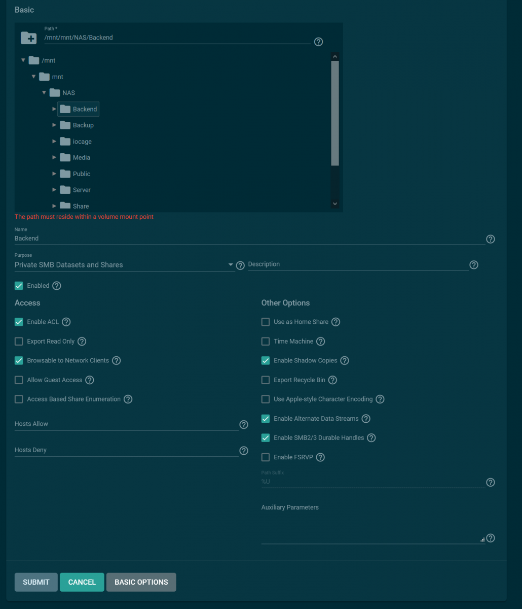

Here you have the settings I use to add the SMB share.

That doesn't look right. I'm assuming your pool name is NAS. The structure should look like /mnt/NAS/... , not/mnt/mnt/NAS/....

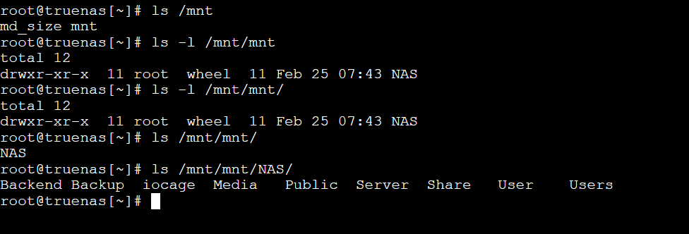

I checked that, during the import it actually did put my zfs pool in that location. Here is a check using the shell.
All I'm saying is that this is not an expected result, and is most likely the reason for the error.

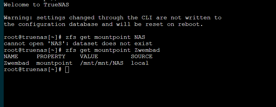

zfs get mountpoint NAS please
itractus
Mar 1, 2021
39
The name of my pool is Zwembad, so the mountpoint is as follows:
Thanks for the assistance

So you changed the mountpoint at some time. This is the cause of your problems. If the pool is named Zwembad, the mountpoint must be /mnt/Zwembad. TrueNAS does this automatically when you create the pool or when you import an existing pool.
If you want the pool to show up as /mnt/NAS, you need to name it NAS, not change the mountpoint only.
Assuming you want your pool to show up as /mnt/NAS I would try:
# shutdown all sharing services, VMs or anything else using your pool
zfs set mountpoint=none Zwembad
zfs export Zwembad
zfs import Zwembad NAS
zfs export NAS
Then import the pool from the UI for a final time.
I am not quite sure if "none" is the correct setting and the rest is TrueNAS magic, but I guess so.

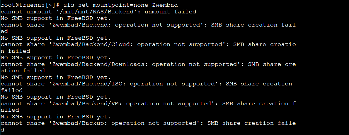

So, there are now no services, VM's or jails running on the system. Running the first command prompts a bunch of errors regarding SMB shares.
