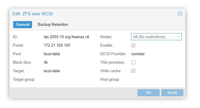

Regarding the topic:
1. TrueNas (latest stable version) ISCSI works fine in Proxmox 7.0
2. TrueNAs ZFS over ISCSI throws error:
command '/usr/bin/ssh -o 'BatchMode=yes' -i /etc/pve/priv/zfs/172.21.100.100_id_rsa root@172.21.100.100 zfs list -o name,volsize,origin,type,refquota -t volume,filesystem -Hrp' failed: exit code 255 (500)
not sure if I choose wrong ISCSI provider: comstar
I want to believe I am doing something wrong here.
Samuel Tai
Apr 24, 2020
5,399
After you mounted the iSCSI volume, did you create a ZFS pool in ProxMox? At this point, I think you just have a bare volume that's not been formatted yet.
rvassar
May 2, 2018
972
I'll second @Samuel Tai here... iSCSI provides raw storage blocks. TrueNAS is storing those raw blocks on a ZFS pool, but the blocks provided are intended to appear as a raw block device. You need to create a ZFS pool or other filesystem on that iSCSI share for Proxmox to make use of it. And honestly, I don't see much point in implementing a ZFS pool on an iSCSI share hosted on an existing ZFS pool. You won't gain any additional compression, and you'd be implementing a bunch of overhead by layering snapshots, etc... Imagine trying to troubleshoot a disk full condition with ZFS snapshots on the TrueNAS pool, and on the client's pool. Let alone the wasted space required to keep both pools below the magic 80%.
ebricca
Mar 30, 2016
4
well this function seems to be a bit different and not so well understood in the thread - there is an article about it
what this function does
- it seems to be automated creation on truenas of a zvol & iscsi share from the proxmox side - that is afterwards used as image
to allow proxmox to create and control zvols&iscsi shares on truenas might be convenient but I would not allow this from a security perspective in production - unless i misunderstood the security implication
also visible by an ssh command - sent to the example nas provider (example from above)
"command '/usr/bin/ssh -o 'BatchMode=yes' -i /etc/pve/priv/zfs/172.21.100.100_id_rsa root@172.21.100.100 zfs list -o name,volsize,origin,type,refquota -t volume,filesystem -Hrp' failed: exit code 255 (500)"
- this is a root ssh login on the nas via key - if someone gains this info with bad intentions goodbye nas
(or if the scripts just have an issue ex. after an update)

jgreco
Resident Grinch
May 29, 2011
18,680
Ah, so this isn't "ZFS over iSCSI" but rather "feature misnamed by idiot." We understand perfectly well what "ZFS over iSCSI" means. The purpose of words is to convey meaning between people, so if you say "ZFS over iSCSI", then we naturally assume you're running ZFS over iSCSI, not talking about some in-depth hypervisor integration that appears to be some sort of plug-in for Proxmox. This looks more like "Remote ZFS disk management for Proxmox"
TrueNAS doesn't give a crap what you're running over iSCSI.
So I take back what I said, I have no idea if this works, but if it doesn't, it's because nobody at Proxmox has put in the effort. Which is hardly shocking as they have their own on-host ZFS implementation, and probably very little incentive. I suspect that's why it looks like it is an add-on from a third party.
There's basically no reason that I see that this couldn't be made to work. The idea is similar to numerous other integrations in the VMware world. From a brief glance, it looks to me like @arrow should have used "freenas" as the iSCSI provider instead of "comstar".
ebricca
Mar 30, 2016
4
well yes it seems to be a plugin functionality for proxmox written in perl
one has to add a third-party version to proxmox as it is not included - which also is a bit so so
some hosting providers seem to use it ... so it might be more than demo level
btw .. the third-party plugin does not yet exist for proxmox version 7 (just 5 and 6)
to use root to execute automated zfs commands via ssh wouldn't be my first choice
(rewritten with the truenas/truecommand api / proper right management i could see some benefit)
