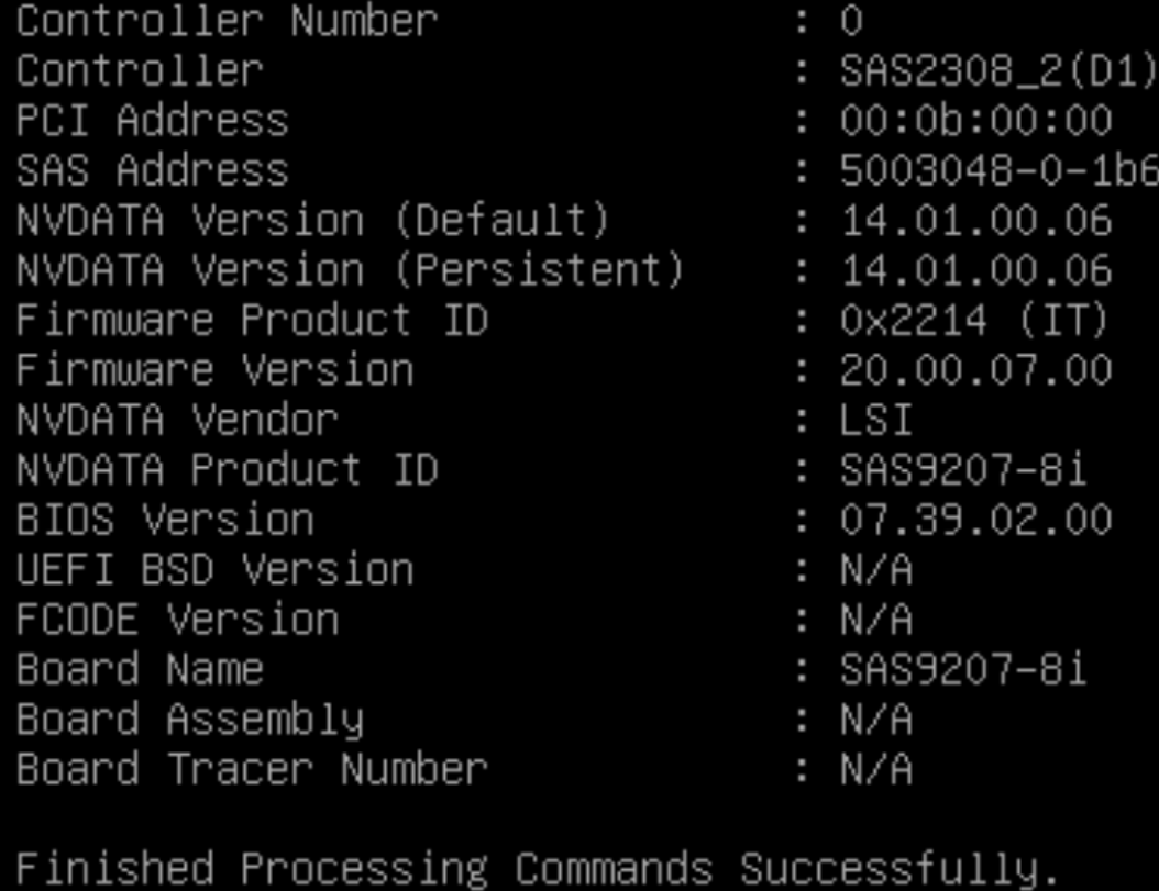

root@nas[/]# sas2flash -list
LSI Corporation SAS2 Flash Utility
Version 16.00.00.00 (2013.03.01)
Copyright (c) 2008-2013 LSI Corporation. All rights reserved
        Adapter Selected is a LSI SAS: SAS2308_1(D1)
        Controller Number              : 0
        Controller                     : SAS2308_1(D1)
        PCI Address                    : 00:04:00:00
        SAS Address                    : 5003048-0-18ee-5b00
        NVDATA Version (Default)       : 14.01.00.06
        NVDATA Version (Persistent)    : 14.01.00.06
        Firmware Product ID            : 0x2214 (IT)
        Firmware Version               : 20.00.07.00
        NVDATA Vendor                  : LSI
        NVDATA Product ID              : SAS9207-8i
        BIOS Version                   : 07.39.02.00
        UEFI BSD Version               : N/A
        FCODE Version                  : N/A
        Board Name                     : SAS9207-8i
        Board Assembly                 : N/A
        Board Tracer Number            : N/A
        Finished Processing Commands Successfully.
        Exiting SAS2Flash.

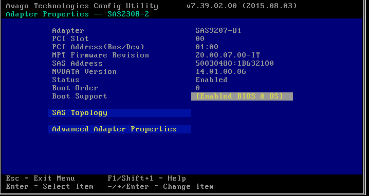

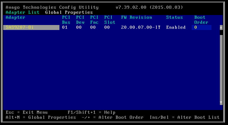

sybreeder
Aug 15, 2013
75
Hm

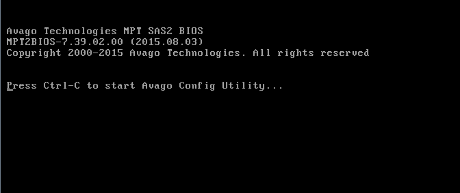

i've installed bios in mine 2308-IT but in virtualized environment it doesn't show BIOS info
I'd probably need to reboot whole ESXi host.
Some settings can be set from MSM from windows for example.
Ok I'm in bios
I was hitting Ctrl+C like a maniac
I've attached bios file that i've used
sas2flash -b mptsas2.rom
  • mptsas2.zip

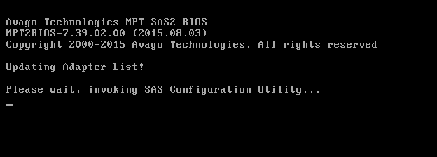

From that video a don't see LSI/Avago bios at all. It's like it's not installed. I'd try flash just the bios.
There was only Intel NIC firmware

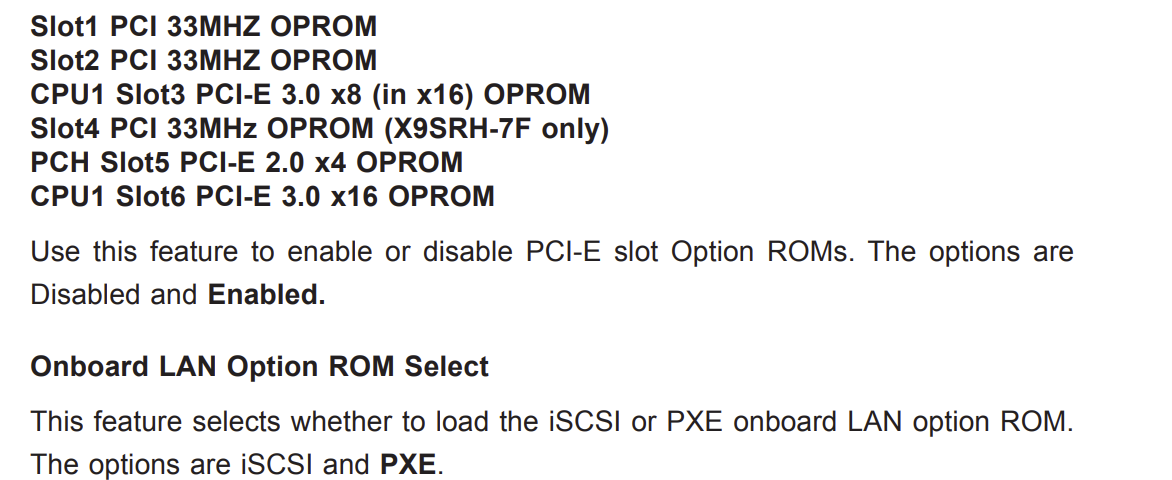

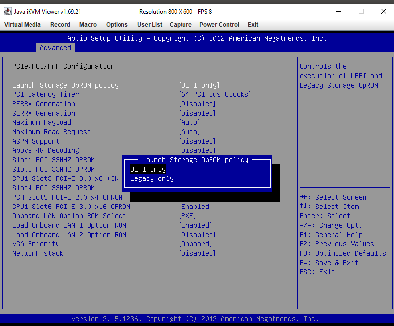

Oh make sure that opROM is enabled in supermicro motherboard bios! for SAS2308
Something like is in mine X9DRH-7TF
this is in X9SRH-7F
If enabling those oprom won't show LSI ROM seems like booting from 2308 is not supported. And even though you've installed bios it will not be enabled by motherboard
artlessknave
Oct 29, 2016
1,506
I know, that's the part that has me stumped. I set the SAS jumper to disabled, and it does, in fact, completely disable it, there are no drives at all. so it's not that.
it HAS the bios, but never even attempts to run it.
Do you have both the BIOS and UEFI ROMs flashed? The BIOS extension ROM gives you the prompt at boot, whereas the UEFI extension ROM adds menus to the setup application (look inside the PCI configuration options, etc.).
If you're booting from UEFI, disable all CSM stuff and set the option ROM to UEFI only or UEFI+BIOS. If you're booting in legacy BIOS mode, you'll obviously need to keep CSM enabled and set the option ROM to BIOS or UEFI+BIOS.

I pretty much always use legacy/BIOS, because UEFI makes absolutely zero sense to me, but ultimately I don't care which one, as long as I can get it work.
it HAS the bios. it does NOT prompt for it. ever. the video shows exactly what it does.

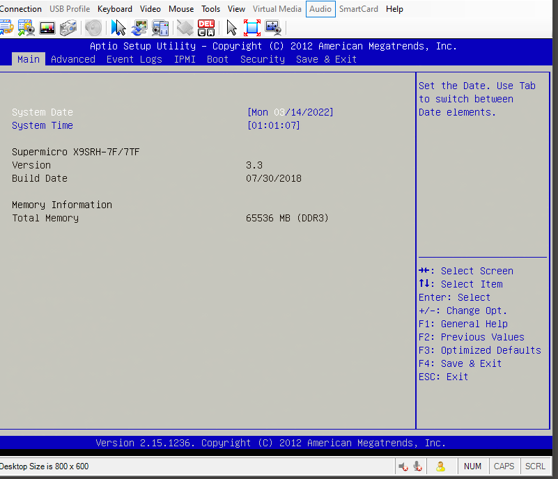

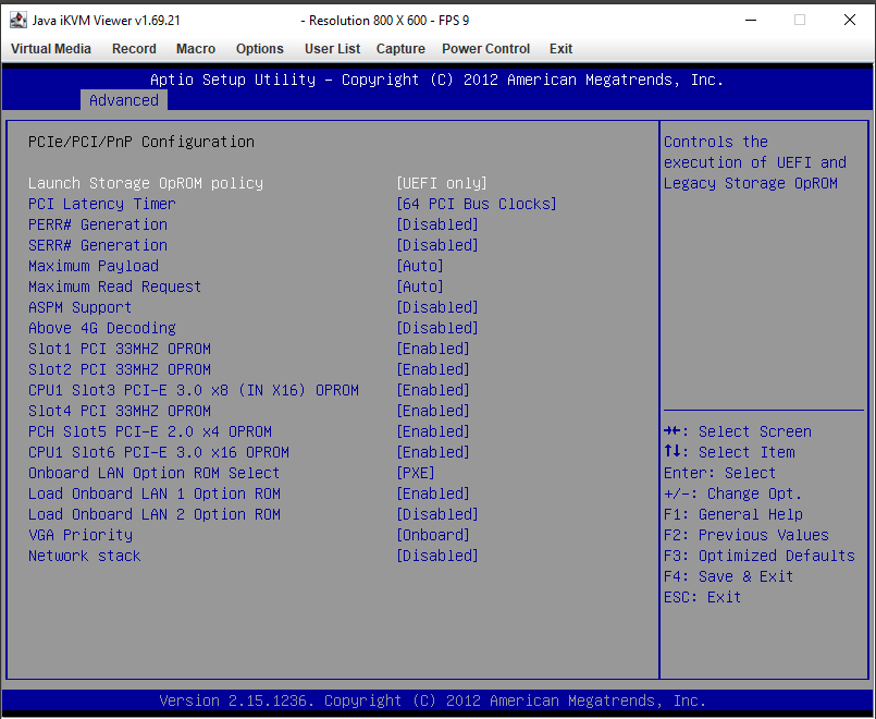

i took some screneshorts, all the OPROM options available are enabled. Im trying Launch storage as UEFI just to see, but I dont have high hopes...
everything was reset to defaults when I updated the bios and cleared the cmos.

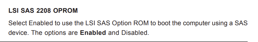

As i shown you in my motherboard i have dedicated LSI oprom in BIOS. You don't . Mine enabled and it works.
In Manual there is nothing more related to 2308 unfortunately...
You can test with HBA as pcie card. PCIe ports has enabled oprom so it should work.

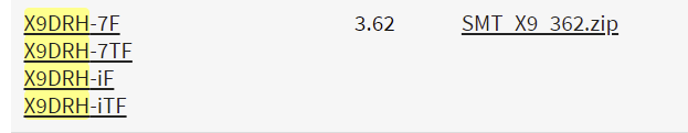

IPMI:
BIOS:
My best guess is that they never plann for booting from that LSI2308. Even if you install IR mode bios.
If it's not in manual it's very rare that they implement it.
artlessknave
Oct 29, 2016
1,506
except its the same bios, and you have an option to enable it, while I do not. it's functionally the same as a card in a PCIe slot, afaik, it should work the same :'(
I am curious how you can have 3.62 IPMI when the newest on the website is 3.61....

It's not ssupported motherboard. With old Bios that still uses java. I doubt that they implement it now.
On manual there was no 2308 oprom.
