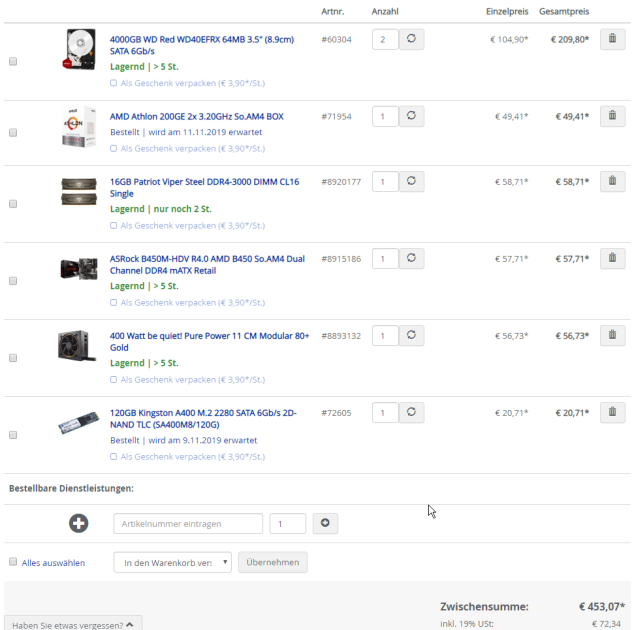

Looked at it. The problem with the server bay rigs: need way to much power for 24/7. Wanna stay under 30Watt.
Playes a bit around and thought i could build somthing like this:
Any thoughts?

sabi-tech
Jan 19, 2012
45
Let me know if you thinking of shifting the motherboard. i could find a use for it ;-)
