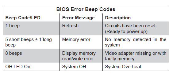

I recently bought a X10SL7-F for my first Freenas build, but i cant seem to get the damn thing to even work, and i fear its the RAM. I get no display output on the VGA port, it just boots up and i get the beep codes very fast, to me it mostly sounds like 4 fast beep and a long one which is not a code(code list on last picture), so it is properly 5 short + long. The computer does not turn off after the codes, but just keeps running and i can hear the hdds spin up fine.
I bought 2x 8gb mt18ksf1g72az-1g6e1 on Ebay after checking the recommended list, but the seller sent me 8gb mt18ksf1g72az-1g6e1zi and 8gb mt18ksf1g72az-1g6e1ze both new. I cant seem to find any info if the ram i got is actually different, or if the last 2 letters is about manufacturing location. I tried both the sticks individually but the results were the same. Do any of you have experience with said ram on the X10SL7 board or am i boned and have to buy more ram?

X10SL7-F beep codes according to the manual
The beep codes in sound:

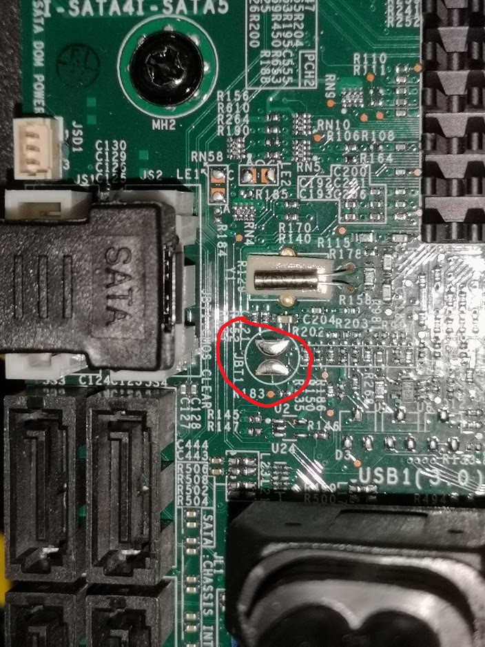

For clearing the CMOS on that board, you are going to want to not only remove the battery, but *SHORT THE BATTERY TERMINALS* for 5 seconds. Just removing the battery is not going to be enough for that board because there are (presumably) capacitors that need to be bled before that cmos power is dropped. There seems to be some indication of this on the supermicro site.
The good @DrKK is correct; Supermicro gives complete instructions for clearing the CMOS in the X10SL7-F Motherboard Manual, available for download from their product page for this board, located here:
http://www.supermicro.com/products/motherboard/Xeon/C220/X10SL7-F.cfm
No need to remove the battery. Shut down the system; remove the AC power cord; then short the JBT1 jumper located near the SATA ports. Remove the jumper before powering on the system again. This should reset the board settings to factory default values.

The first thing i did when i bought the board was to download the manual. I think there is different versions/reversions of the motherboard, because there is no jumper at the specified place in the manual, that was why i removed the battery. But ill try to find out where they placed it instead, if the battery trick is not enough for Supermicro boards.
EDIT: I found the text at the right spot, but there is no pins at all oO, so no place to put the jumper they mention in the manual, apparently on some versions you have to short it with a screwdriver... what a weird system.
