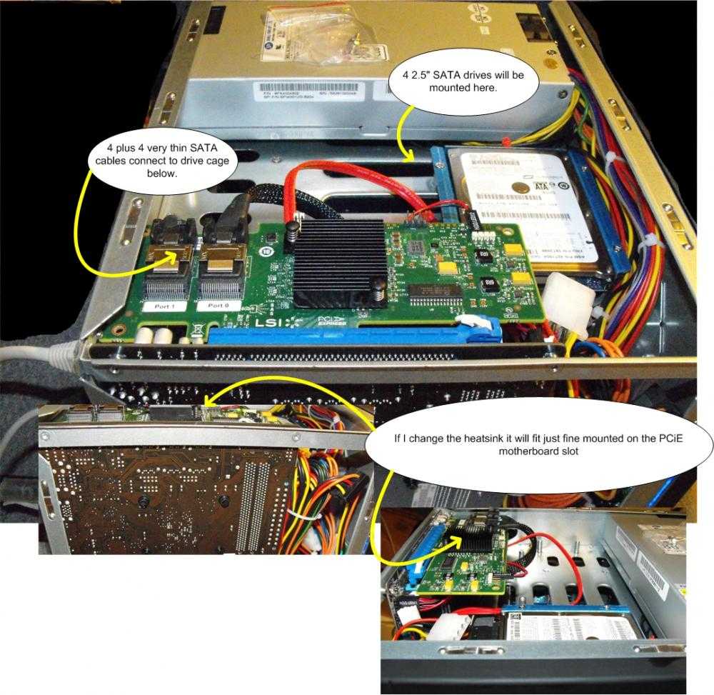

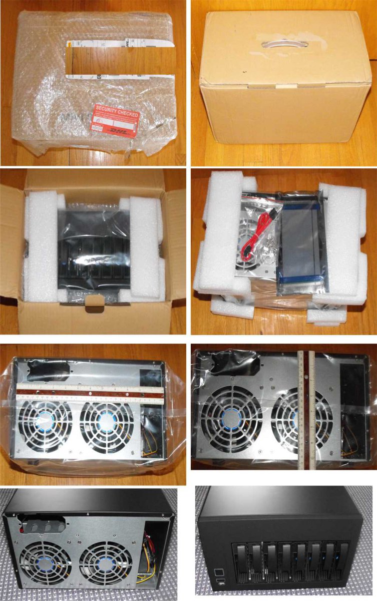

The box I originally built and have yet to use it boots fine any USB stick I have tried (mostly linux flavor but also wintel boot sticks).
I am still playing with it. It has 4 of 8 drives connected to the IBM M1015, one additional sata drive inside of the case that I use to boot from. That said I keep changing what I am doing with it for whatever reason as I have 4 other NAS boxes on line.
I wil test boot freenas in the next couple of days...the original goal for me was how small of an 8 drive hot swap NAS box could I build. Left it at that point a while ago and ventured over to other DIY projects....I do have it closed up now. The original power supply did fail after some 6 months or so. Replaced it and vendor gave me a spare one.
