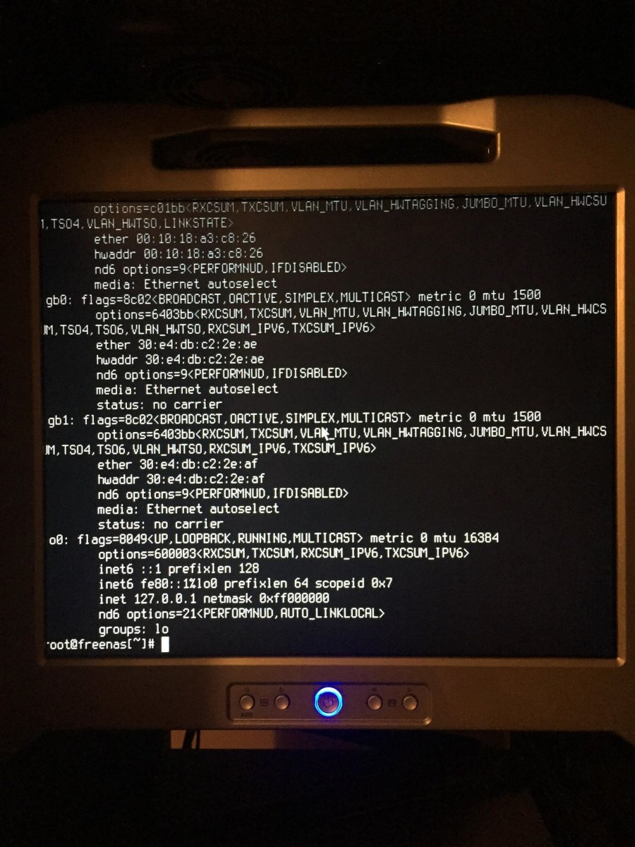

When I booted up FreeNAS it came up as
"The web interface could not be accessed. Please check network configuration."
I tried to set it up manually and got it to at least show the IP I was wanting but couldn't ping the server and it wouldn't show up on my router as a device. I checked using multiple cables and multiple ethernet ports with no avail, they did show greens on link lights. As always any advice is greatly appreciated.
I attached the ifconfig as a image
kdragon75
Aug 7, 2016
2,457
You server does not seem to be plugged into the network "no carrier" generally means no physical connection. Please review the forum rules otherwise we won't be able to help you.

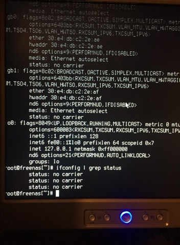

can your provide the output of ifconfig | grep status This will show just the status of all of your adapters.
CreekwaterX
Oct 20, 2018
10
Showing no carrier.

Check your ports and cables on both ends. Its also odd the were only seeing 3 listed... we should see one for each physical port.

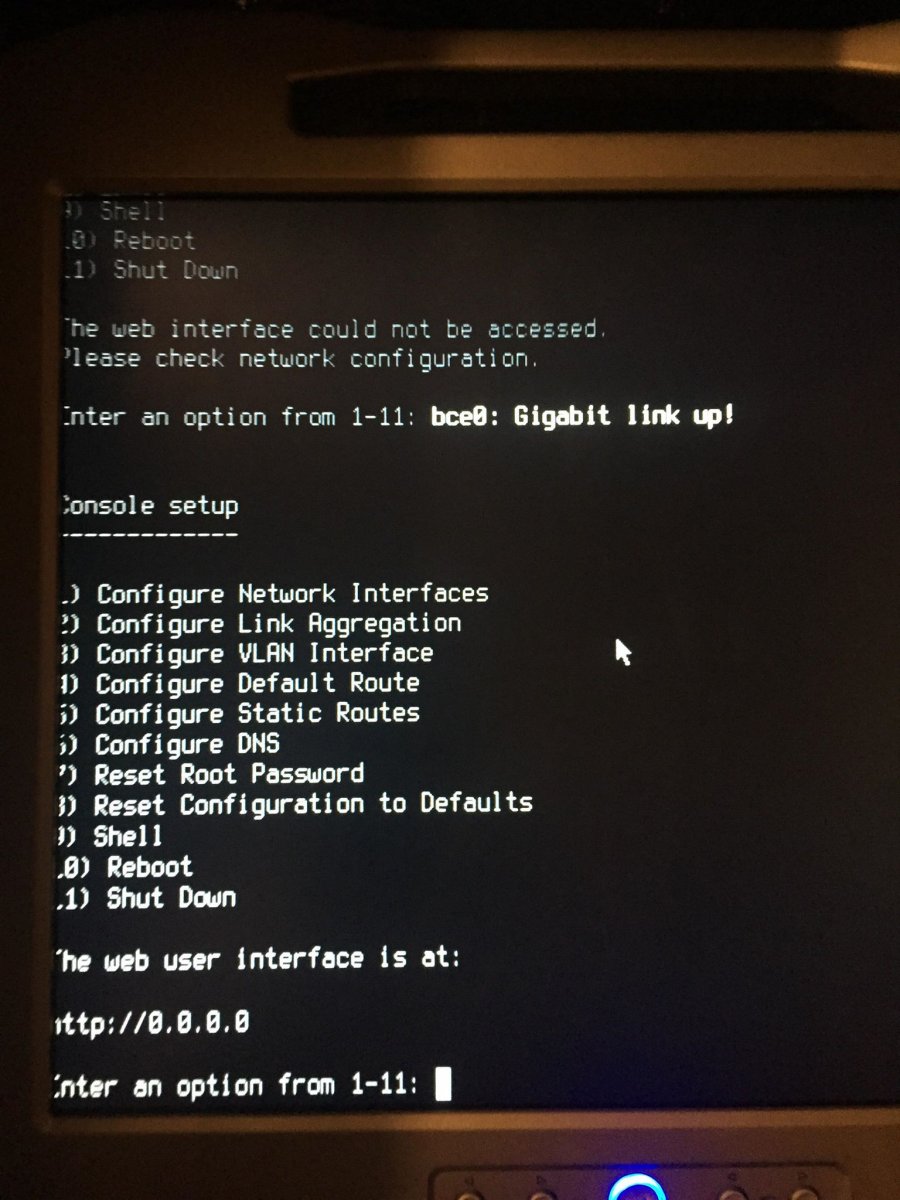

I attempted a restart before I check the cables and when it was booting I did see it did recognized the gateway as my router 192.168.29.1 but said network was unreachable. Was not able to get a picture because it scrolled too fast.
For some reason only some of the ports had link lights as good when I attempted using them.
It just came up as Gigabit link up with an ip of 0.0.0.0

Still shows no carrier.

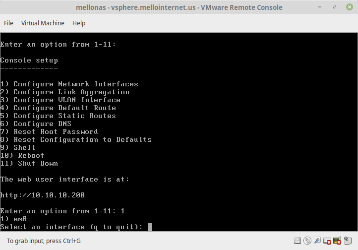

  • From the console, try option 1. If the interface was recognized, it should show:
  • if not you can play with the options, trying to remove the interface, reset network, etc.

Mine from my VM:
em0: <Intel(R) PRO/1000 Legacy Network Connection 1.1.0> port 0x2000-0x203f mem 0xfd5c0000-0xfd5dffff,0xfdff0000-0xfdffffff irq 18 at device 4.0 on pci2
em0: Ethernet address: 00:0c:29:5d:ad:fe
em0: link state changed to UP
arp: 10.10.10.62 moved from 00:0e:04:05:07:48 to 00:02:c9:55:7e:d8 on em0

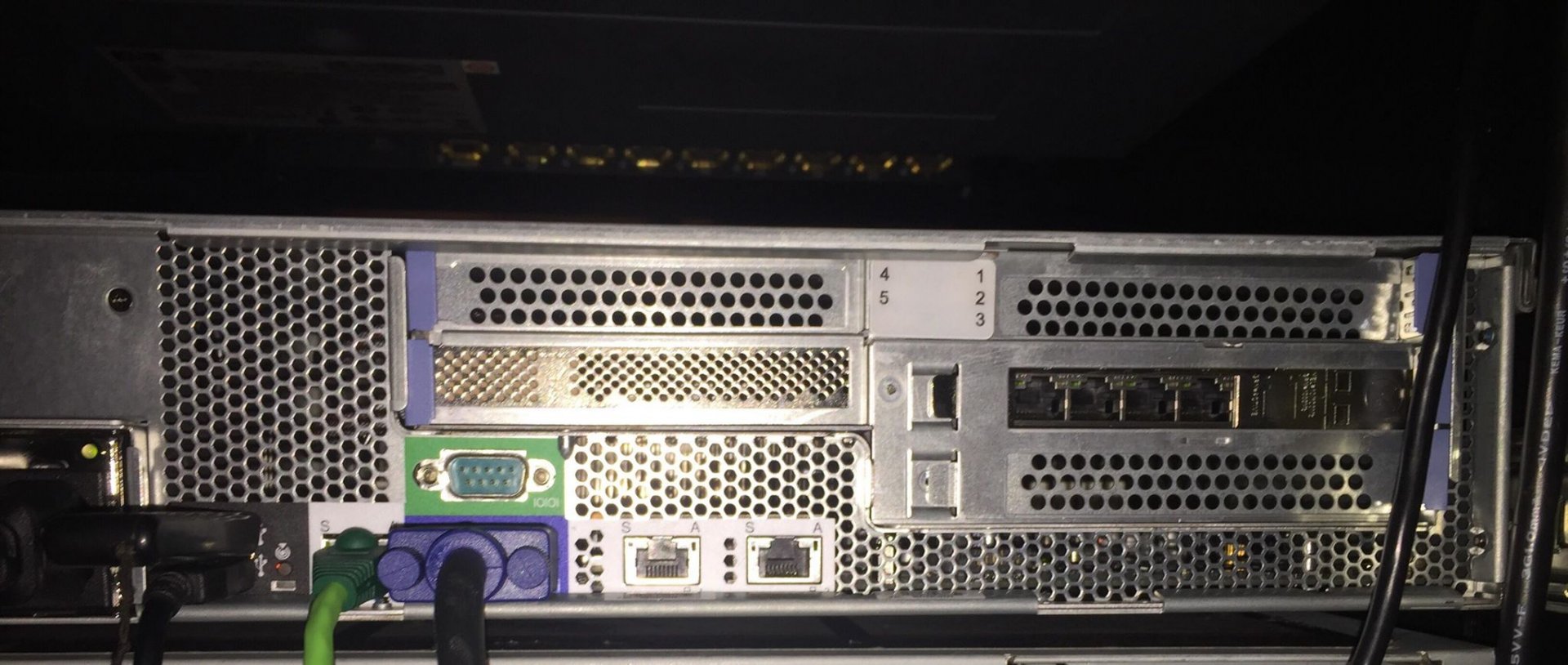

Obviouly I need to get my eyesight check (there are 7) I tried all of the connections and the 4 port NIC on the right showed all green and so did the one that the ethernet cable is currently plugged into in the picture, the middle two to the right of that one showed red though on link lights.

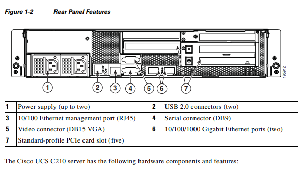

j0hnby
Apr 22, 2017
68
The port you have plugged in with the green cable is the management port, you are using one of of the others normally right?
melloa
May 22, 2016
1,749
. This has been the second most frustrating OS install I've ever had in my life!
Usually a hardware incompatibility.
You are using the wrong interface... use 6 - 10/100/1000 Gigabit Ethernet ports.

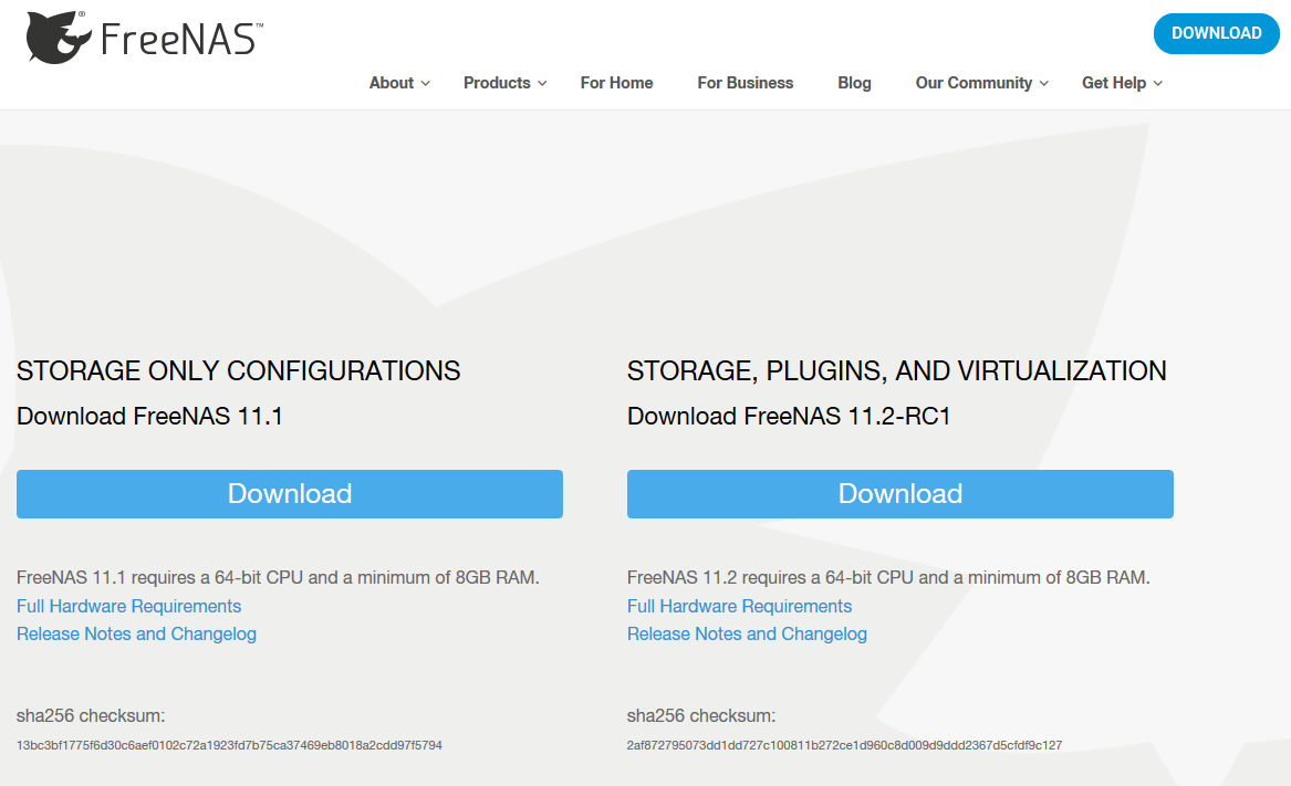

Chris Moore
May 2, 2015
10,079

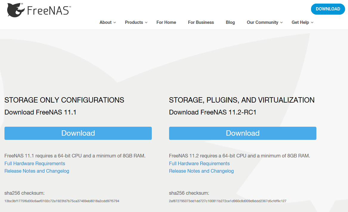

Honestly I just downloaded it from the website a couple days ago, there wasn't any reason.
I understand. I went to the download link on the FreeNAS website and this is what it gives you:
Not knowing the difference, I would probably go with 11.2 instead of 11.1. The difference being the RC1 on the 11.2 version means it is actually still in development. They marked the 'train' as being stable, but there may still be features that are not working properly. The 11.1-U6 (update 6) branch will probably not get any more updates and it is using an older version of FreeBSD. The 11.2 revision is the way of the future, but it is not quite finished being created yet.
I appologize for being a thorn in anyone's side.
No worries. I imagine that most of the people that help out on the forum do it because they enjoy it. I would help more, but I have to get back to work, at work.
kdragon75
Aug 7, 2016
2,457
Well, after all of the conversations about not being upfront about the beta status of 11.2 and the talk of fixing it for the next beta versions we get this deceptive page... 11.2 is for more complete than Corral was but this still fells like that... Pushing an incomplete system on unsuspecting users...
