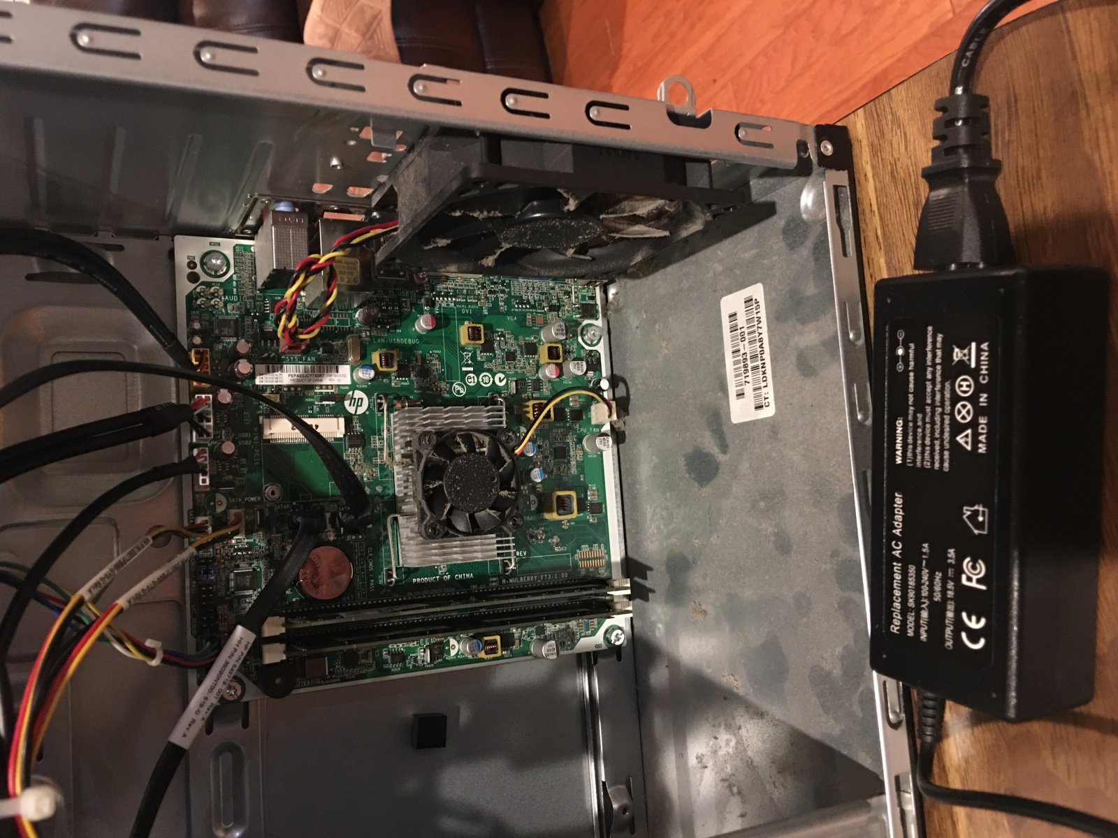

I bought a tower wanting to convert to a NAS. The motherboard is a 2B18 when I was researching it it said it took max of 95W power source. The tower doesn't have a internal power brick instead its a external one. I am hoping to run 4 hard drives, not sure if i should start looking for a new mother board and power source?
I attached a picture of what the motherboard looks like and the lack of a internal power brick.

Well, first of all it appears you only have 2 SATA ports, so 4 drives is probably an instant no-go since it appears you only have a mini pci-e slot for expansion so you wouldn't find a suitable HBA adapter to add more ports.
Your case itself seems to support alternative motherboards, but I can't tell if there's an actual PSU mount area, and I also cannot determine if you even have four mounting slots for drives. Based on the "HP" logo though, I don't expect there to be.
I also anticipate it's going to have very little RAM (looks like 2 GB max), which is not sufficient for FreeNAS.
In summary, repurposing this computer is probably not going to work. Unfortunately you're going to need a new motherboard, which means new CPU and RAM and power supply. The case itself might be usable but that might be a wash too.
If you're set on using that and not needing to replace basically everything out of that system, you're going to want a lighter NAS software at the very minimum regardless. Not sure recommending competitors is allowed here, so that's all I'll say about that.

The power supply is probably insufficient; a typical hard drive takes a fair amount of power to spin up, and trying to do several simultaneously can cook a little power supply.
We do have a resource here somewhere, "Proper Power Supply Sizing" which discusses all the factors.
