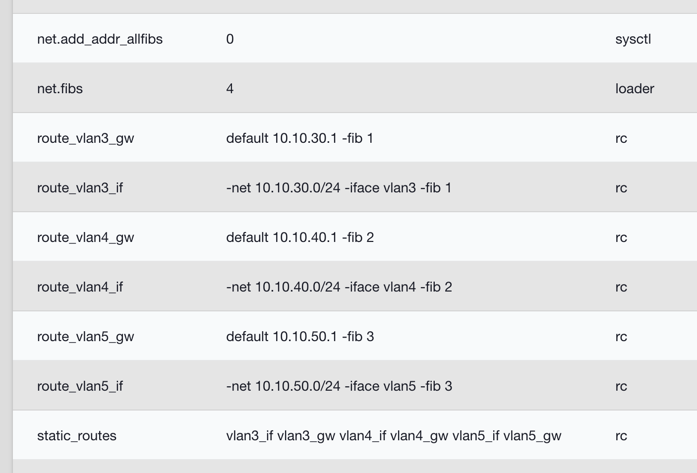

Since my last post I started using a VM on the freenas box (pihole DNS) which did the vnet setup I had with bridges and post-init scripts even messier. I never really had the time to get things working automatically from boot until I finally had a proper look at things again today.
I want to give a huge thank you to chipgoon for chiming in on this issue. The FIB was the missing link for me and once I understood this the rest was a breeze to setup. Your comment on using whatever NIC I wanted for the VLAN parent also worked as you suspected. I want to point out that proper naming of the tunables is needed for them to work and the static routes needs to be added as well and all in the correct order (e.g. if needs to exist to set a default gw on the if). Se attached image for my setup.
Also, to clarify berkeley packet filter cannot be used without vnet and the "interfaces" of the jail cannot be just "vlanX", it has to be in the form "interface:bridge" so in my case "vlan4:eth1" works just fine.
