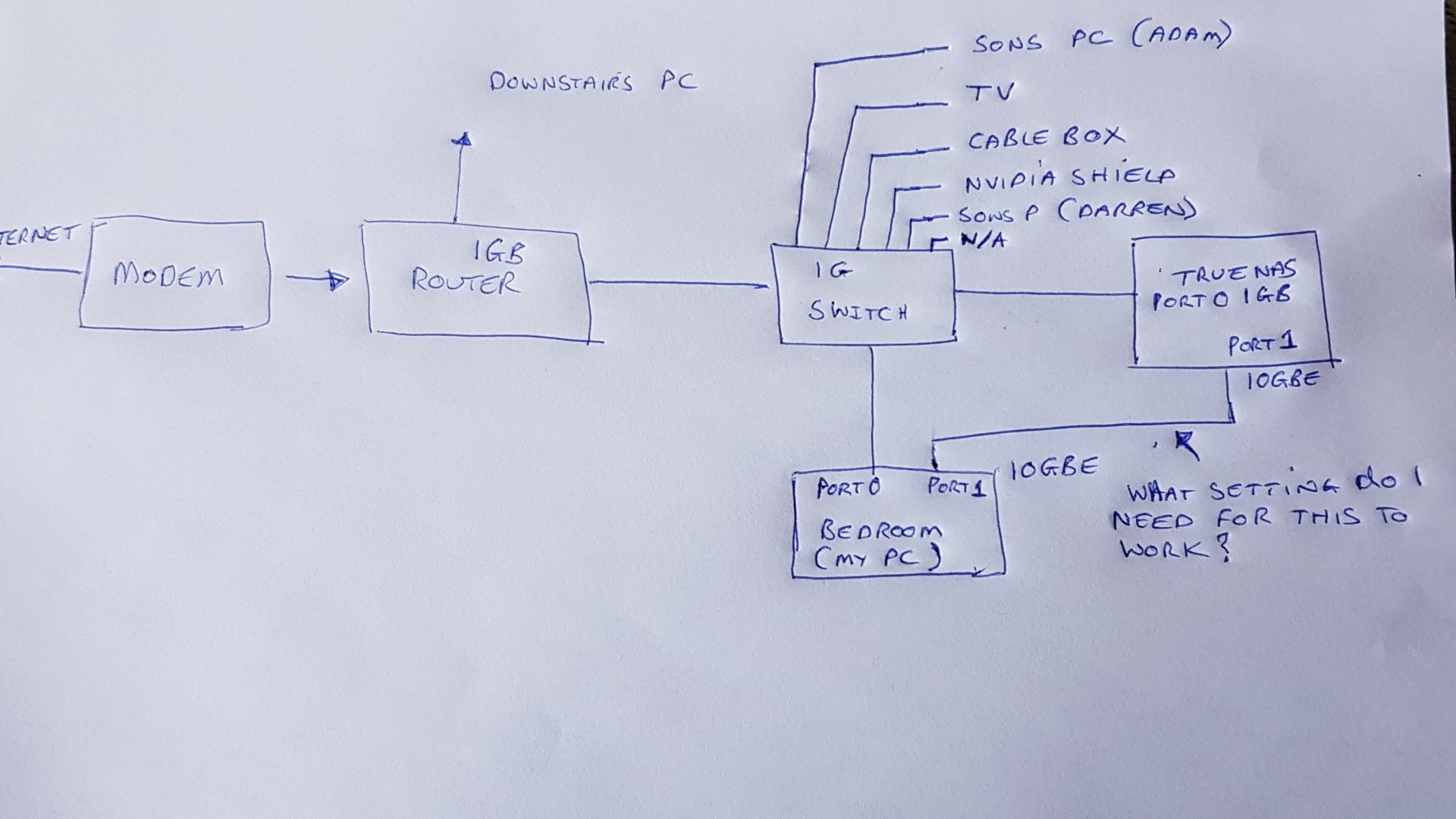

Thank you for the interesting read i meant 1Gbps transfering data from the nas to the bedroom pc ,iam new to truenas and still learning,i drew a picture to try and explain a bit better.

So there should be no path where there's any involvement from the router there. You have a 1Gbps path from the NAS to the PC, traversing the switch, and then a 10Gbps pointopoint.
You probably need to identify what your goal is here. If it's nothing more than "make it work", then I suggest that your simplest solution is to do the IP address based solution I discussed. Because neither the TrueNAS host nor Windows normally provides DHCP service, you need to manually configure the networking for that pointopoint link. If you want to toss up some information on what your current IP network addressing is like, I can probably give you less confusing guidance. Otherwise, you can follow the general example I provided above.

The problem is when transferring data from the nas to the pc it is taking the 1gbps connection to the switch rather than the point to point 10gbe connection.My goal is to transfer data from the nas port 1 to the pc port 1 and achieve up to 10Gbps.
Yes, I understand that. This is one tier above beginner level "plug everything into a switch" networking, and can be addressed either via architecting your network infrastructure appropriately, or architecting your IP networks appropriately. I do this stuff on a daily basis and both have their pros and cons.
In your case, you've probably screwed yourself a bit by selecting suboptimal networking cards; copper 10GBASE-T sucks bigtime. It also means that you cannot avail yourself of readily available solutions in infrastructure. I would normally recommend acquiring a switch with some modest amount of SFP+ capability, because those are available fairly cheaply on the used market, and then just making a single IPv4 network out of it. This mirrors what you are likely already familiar with, but comes at the cost of some new gear.
Because you've already got the 10GBASE-T cards, you're committed to having to work with a pointopoint configuration. In a certain way, this is easier, because it is not involving ambiguity, but users are often reliant on the helper technologies like DHCP and WINS to set up their network and obscure the ambiguity. So it's really only a matter of configuring your pointopoint correctly for a separate IPv4 network, and then using the correct mount command, and it will magically work, and do so at 10Gbps. Because it won't have any idea about the 1Gbps. That's the beauty of the separate network solution.

Thank you for your reply,it may be that i need to have each nic card on a separate subnet.which would mean the nas transfers data directly to the pc using port 1 not port 0 ,i can access the truenas share folders but can only transfer data to the pc at 1Gbps i did manage to transfer data around 400mbs/s to the pc but left no access from the other networked pc's i really appreciate your help and knowledge.
Correct, that's what I explained above. For any design like this where you have two separate networks, each of them needs to be configured. You can then choose which of them you'd like to use.

Not exactly Forty minutes,anyway i came here for help and have fixed the problem with a little help from jgreco, and it is working as i needed, "Any idea's anybody?"was meant for the other members to chime in with any other hint's or recommendations to other member's with a similar problem,Good luck with your timekeeping.
