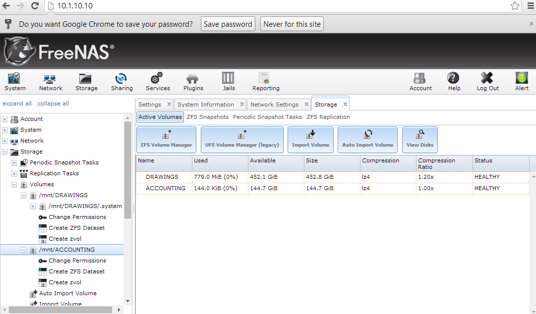

Maybe also pictures of the volumes screen in the web GUI?

That looks fine, how about looking at your shares? You probably just need to reshare the volumes.

Yeah, your volumes look fine. You do have two separate volumes so I doubt you overwrote anything. It's likely either a misconfigured share or some other network issue.

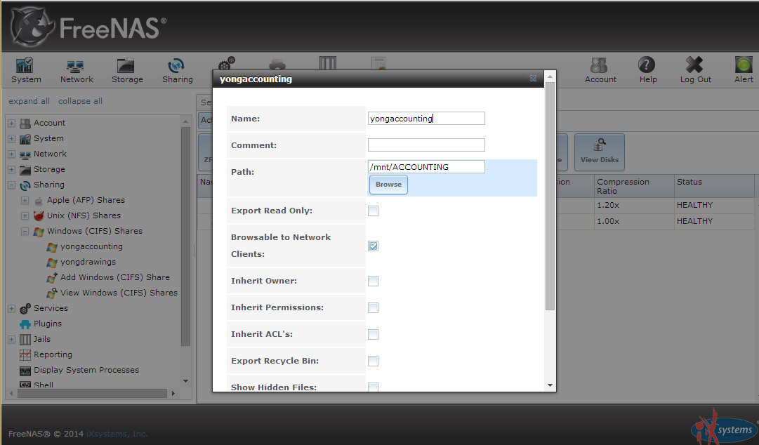

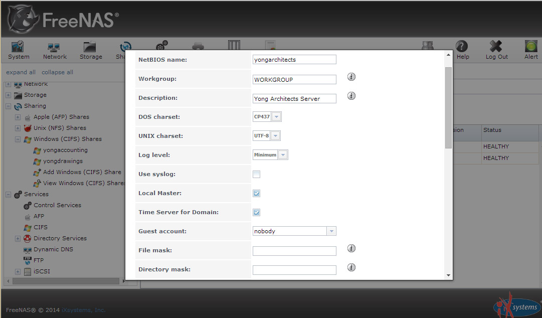

i created a new CIFS share for the new volume, but besides that i didn't change anything else.
i actually don't know exactly which boxes i should check. let me know if i'm doing something wrong. Thank you!
