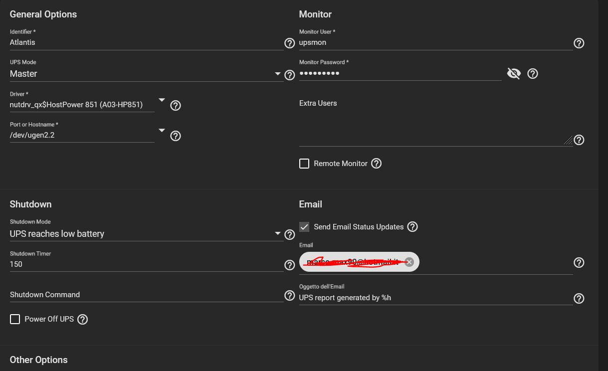

do you mean in the services menu -> UPS?
If yes, I don't know how to fill. Also I believe that the drivers that it offers me from the drop-down menu are not the same model as my ups.

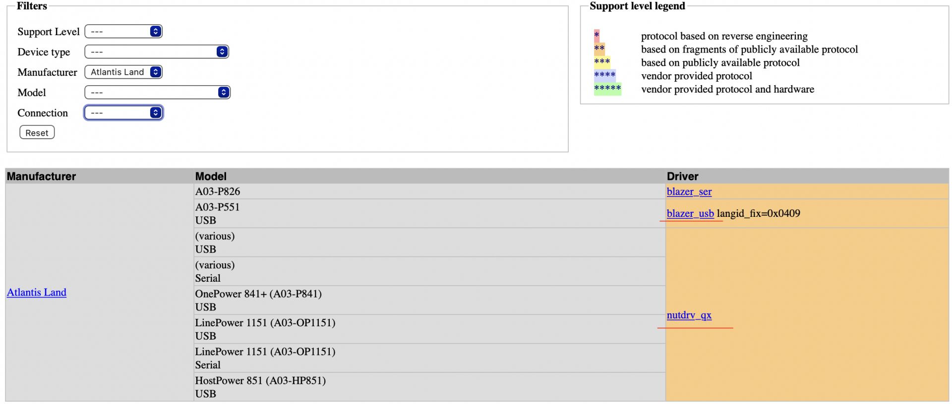

TrueNAS uses NUT for UPS monitoring
You will likely not find the exact model, but you can try the various drivers listed on the compatibility page.

@elvisimprsntr
how do i see if one of those drivers works after selecting it?

if you want to know the port, I had already tested it some time ago when I tried to configure it. When I insert the cable it is the ugen 2.2

Which means you can try usb-hid or one of the devices from the NUT documentation that @elvisimprsntr linked. Like the A03-P551 model ...

how do i see if one of those drivers is okay after i select it from the drop down menu and save it?
There are 4 Atlantis drivers. After saving I get email notifications that the connection has been lost.
