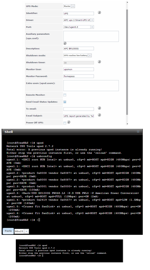

I have an APC BR1000G that I've been trying to connect to my Freenas 9.3 server. Everything seemed to be okay as far as generating upsd reports (the system would yield correct outputs and I wasn't receiving email errors). However, one reboot of the server led to a string of problems that causes constant COMMBAD email reports and an inability for the server to recognize the UPS.
With regard to drivers and USB ports, I believe that is all setup correctly. I've tried two different drivers that many users have stated worked fine with this UPS (and since it worked at first, this all seems to be correct).
Here is a few outputs from commands that I know, and I included the current UPS config setup. Note that the driver that is attached to the usb port is not for the correct unit. I've tried resetting the USB driver and stopping/reloading the UPS driver--which did not help. I was hoping for a way to reset the UPS drivers to a new state, but am unsure if that's the correct procedure or how I would go about that. Any help would be appreciated.

I haven't done anything in CLI aside from running usbconfig and upsd, only to identify if the driver is picking up the UPS or not.
When I turn off the UPS service: "upsmon[26321]: upsmon parent: read" "upsd[26305]: mainloop: interrupted system call"
When I turn on UPS service: nothing comes up at all. The service turns on but nothing displays in CLI to suggest it's turning on. UPSD returns "fatal error: a previous upsd instance is already running!"
sounds to me like the service is on.
What does /var/log/ups.log say about the situation? Does it appear to be recording some/most of its fields validly? Or no.

I'm still getting the COMMBAD - UPS emails sent to me every few hours. Also, upsd commands all return, "fatal error: a previous upsd instance is already running!"
Any ideas for resolving those issues? When I first installed the driver, upsd commands would return all the pertinent info for the unit--which was nice (and gave me some insight as to what level of communication was being made).
Lastly, are there any tests to run to see if the UPS is working and configured correctly, short of disconnecting the supply or cutting power to the house? I'd like to run some sort of mock test, if possible.

You should not be running "upsd" at the command line. Why are you doing that?
satyr
Jun 20, 2015
37
I had the mistaken idea that I could reset the driver through CLI, since I couldn't find any option for doing that in the GUI. I had initially switched USB ports on the box, and that seemed to be when the errors originated. After resolving that issue, this new one began. Clearly, my thoughts about using the UPSD commands were erroneous. My question now is, what can be done to rectify the situation? Any commands to reset the UPSD?
I tried killing the service to see if there was still a version running from when I tried starting it through CLI, but the log returns:
20150807 185249 NA NA NA [NA] NA NA
