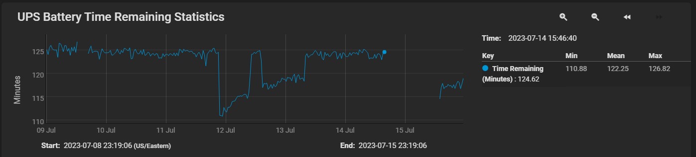

No need to go through that much effort. You can see from the screen shot below that the NAS stopped recording data on 2023-07-14 at 15:46:40. You can also see that the UPS had a lot of runtime left and since I have my shutdown setup for 5 minutes on battery and then shutdown, I would expect to see a drop during that time. And of course the power on was earlier today when I found the UPS powered off. I'm trying to find out if the UPS was told to power off. All the reporting charts have the same thing, recording all normal and then all recording stops at the same time. And as I said before, nothing in the TrueNAS logs to indicate anything was going on. It seems like someone pushed the power button on the UPS, but since I was the only person in the house for the past 10+ days, unless the dogs did it, or maybe a ghost, I right now assume the UPS is faulty.
One other piece of information I just saw, guess it's saying it wasn't shutdown, so it is looking like a power loss to the NAS:
freenas.local had an unscheduled system reboot. The operating system successfully came back online at Sat Jul 15 13:49:07 2023.​
2023-07-15 13:49:07 (US/Eastern)
The little burp of lost data on 09 July was from updating to 13.0-U5.2, so that is expected.
Tomorrow I will swap the UPS units as I indicated in my first posting. I can also run a self-test on the UPS from my computer, maybe it will fail. It just has to be the UPS at fault.
