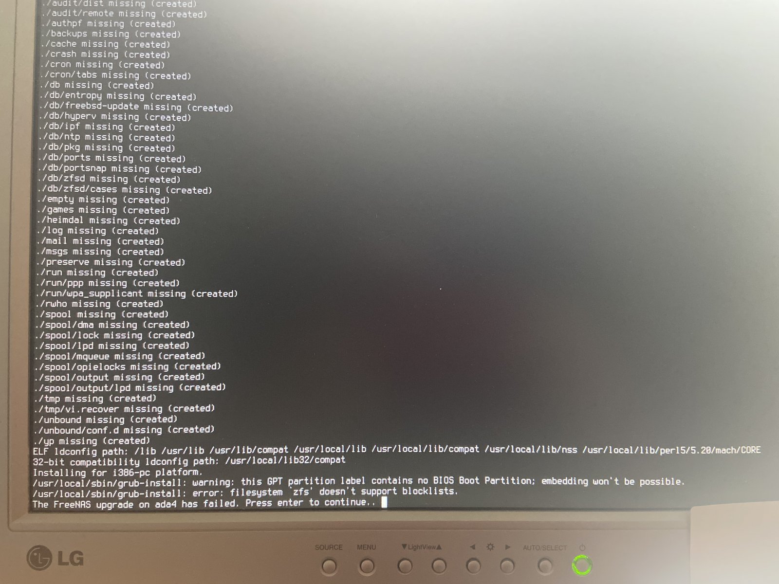

Hi all,
I built my FreeNAS system a year or so ago and had been cautiously moving files onto it from a Windows client.
Decided to upgrade to a more recent version of FreeNAS, so I created a boot USB using Rufus and upgrade seemed to go OK: did an Upgrade Install, installed in new boot environment - aware that I should be using a flash boot device rather than a spinning HDD but hey it worked before.
Got to message about FreeNAS upgrade on ada4 succeeded & prompted to reboot.

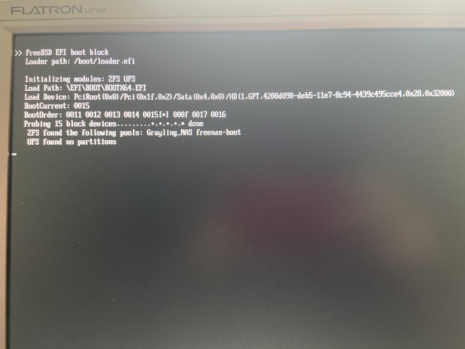

System now hangs after these two messages (see pic)
"ZFS found the following pools: Grayling_NAS freenas-boot"
"UFS found no partitions"
Followed the Resolving Boot Issues link: tried rebooting with system in Legacy BIOS mode rather than UEFI but no difference (as expected).
Tried to "upgrade" back to 11.0 U4 but that "upgrade" fails (see rollback pic).

Are you on 11.0 or 11.1? If you are on 11.0 I would suggest upgrade to 11.1 U7 first then upgrade to 11.2.
Also at boot you can go into the boot environment and change to boot your old version, they are not over written.

Thanks for the advice Jessep - sounded good - but in fact I installed a SanDisk Ultra Fit 32GB USB 3.1 flash drive then did a fresh install of FreeNAS 11.2-U7 to it. Still had the same problem, so removed the old boot Toshiba boot drive which was obviously still being accessed, then the system booted OK from the new flash drive. Imported my disk pool OK.
