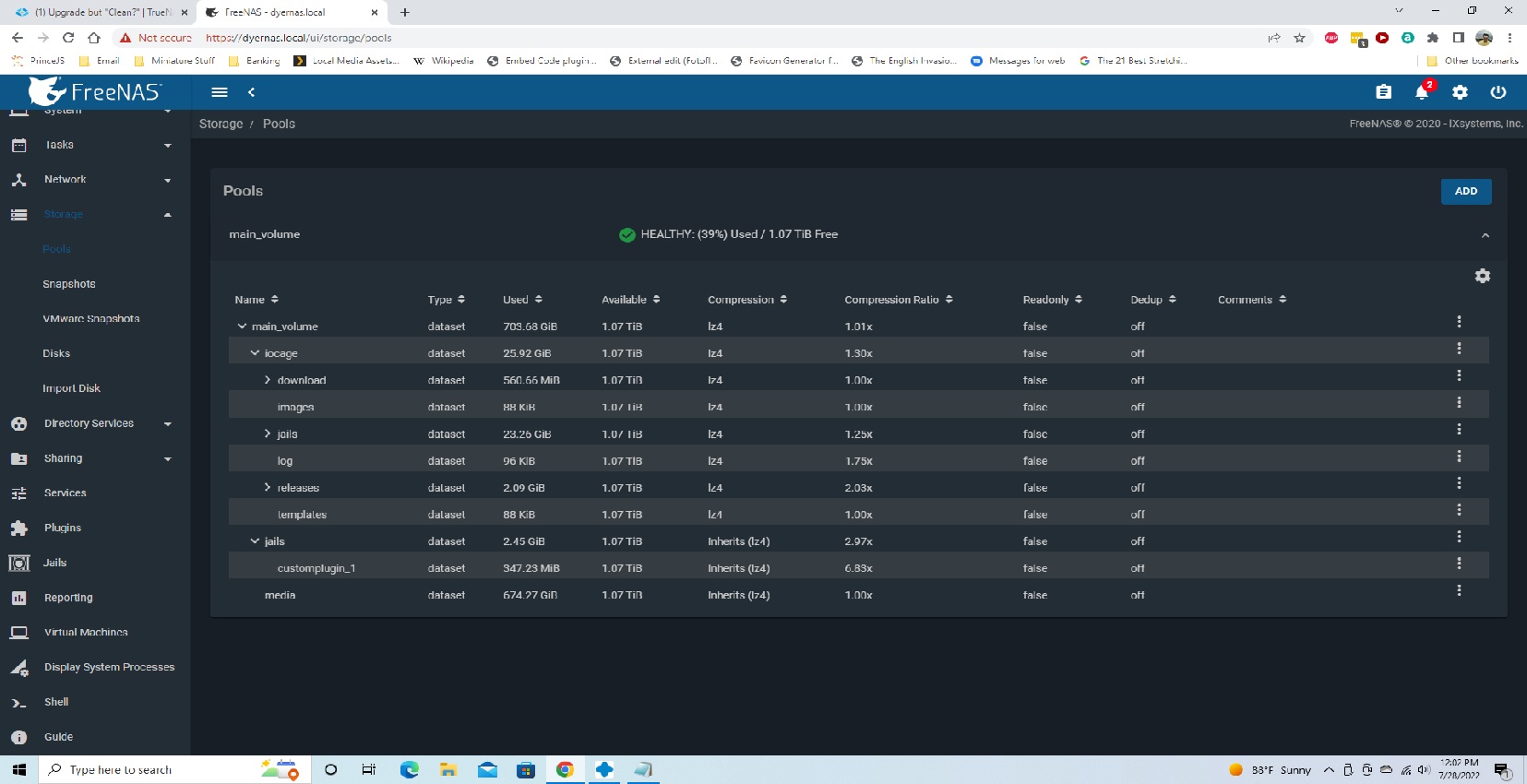

Okay, I think we're already over my head. How do I grab the contents of the the Plex Media Server folder?
Also, is it normal to have two different "Jails" sections under on my main volume? I've attached a screenshot, one is under "iocage" and the other has it's own heading.

Samuel Tai
Apr 24, 2020
5,399
You can delete the jails dataset and its subordinates. This is what the warden jail manager used; but this became moot in 11.3, when the iocage jail manager took over.
It won't let me edit to add additional detail, but I wanted to clarify that I know how to copy stuff within the jail, but I thought the whole point of the jail was that it wasn't accessible for the rest of the OS.
No, the point of the jail is that it has no access to the host file system, other than what the host provides in the jail fstab. The host can merrily stomp all over the jail. As for editing the jail, this can only be done when the jail's not running.
