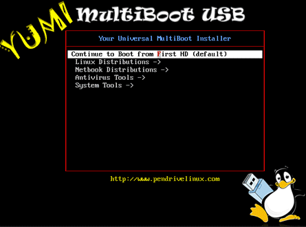

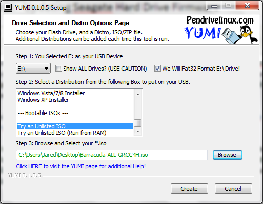

I didn't want to burn a disk so I used YUMI and a spare USB.. Select your USB Drive Letter (D:/ E:/ etc) Point YUMI to your .ISO download (Barracuda-ALL-GRCC4H.ISO).. Use "Try An Unlisted Image Option" in the dropdown menu.. You will need a clean formatted drive fat32/fat - if hasn't been done already check that.. Warning: This erases everything from your USB.. Don't use your Freenas USB!..
When YUMI is done creating.. Select "No" to add any more operating systems and reboot your PC..
To test that the USB will boot up I like to do a quick test in the quick pop-up boot menu using F8/F12 .. This isn't a permanent change.. If YUMI boots up - shutdown the pc..

Save and exit bios.. Your computer will now restart and you should see a YUMI boot menu.. If memory serves correctly you will see "Boot Off Main Drive" and "Try Unlisted .ISO file".. Select "Unlisted .ISO" and you will now see the Barracuda-ALL-GRCC4H.ISO. Hit enter and wait for Seagate SeaFlash to load..
