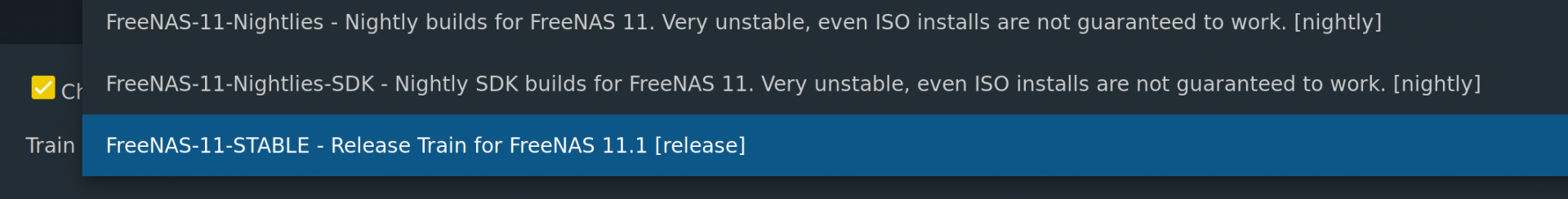

Hi there,
I did a fresh install of 11.2, but I only have the 11 Stable train available for selection in the drop down list. Any advice on how to fix this?
Thanks,
Klaus
kschreyack
Dec 26, 2015
12

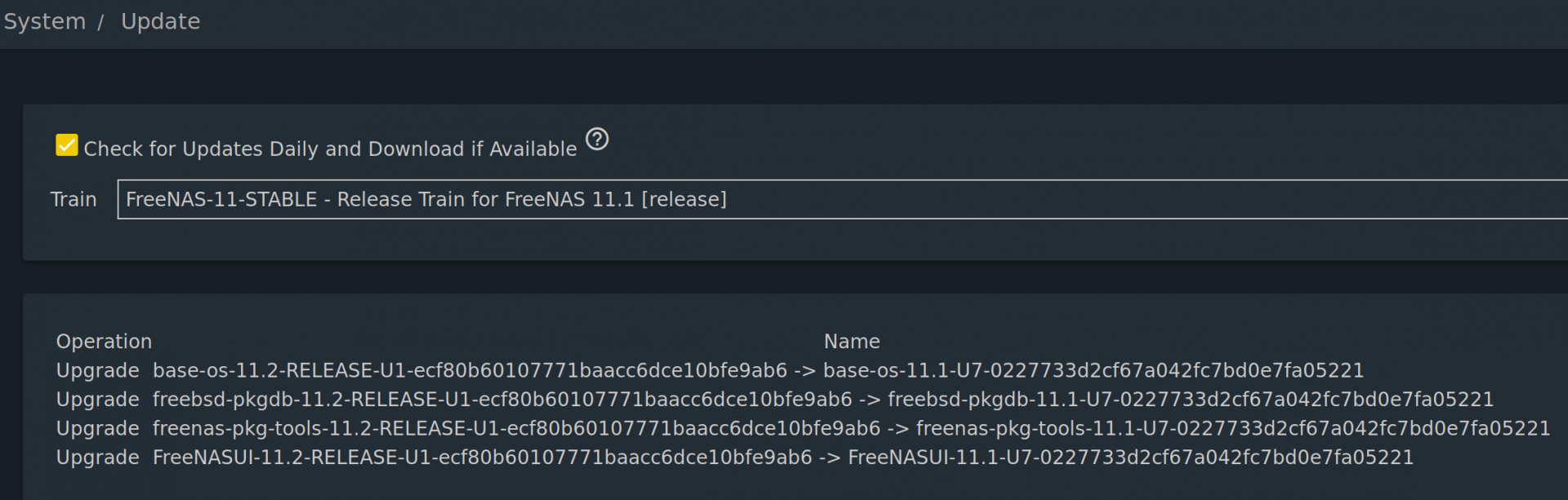

Just an update: I've added screenshots for what I see in choices for train selection, and also the problem I have being on the wrong train is highlighted in looking at the package updates it wishes to perform - which is a rollback.
Do not update to lower version: https://redmine.ixsystems.com/issues/78205
They are fixing it. I think after the fix is released you may need to switch to legacy ui in order to select the correct train.
kschreyack
Dec 26, 2015
12
Thanks for the update. I've since reinstalled, using the latest ISO available. That solved for it ;)
