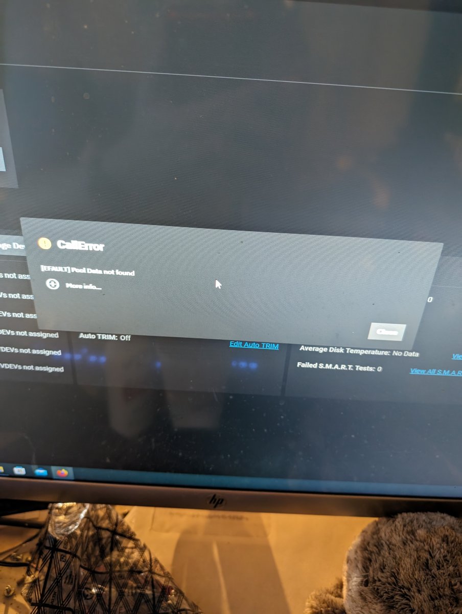

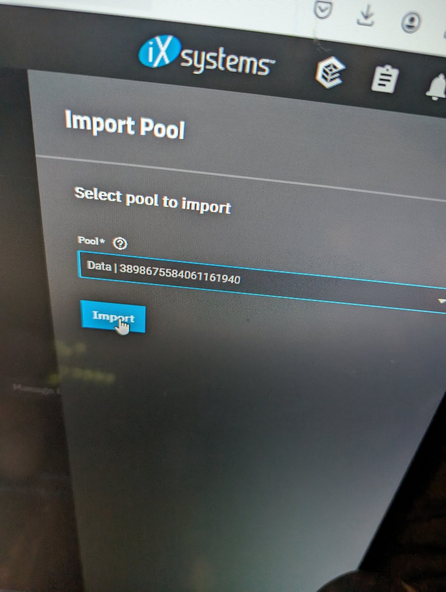

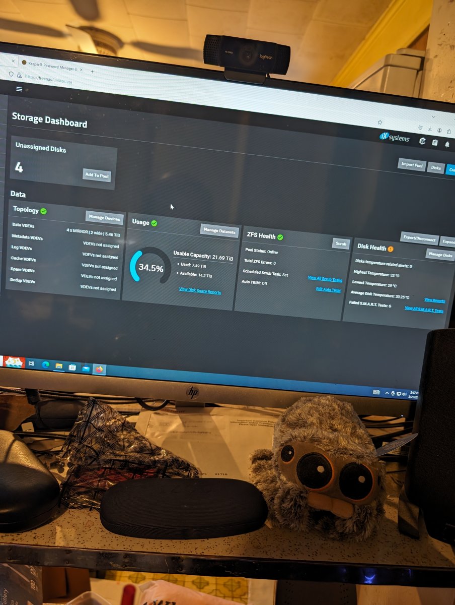

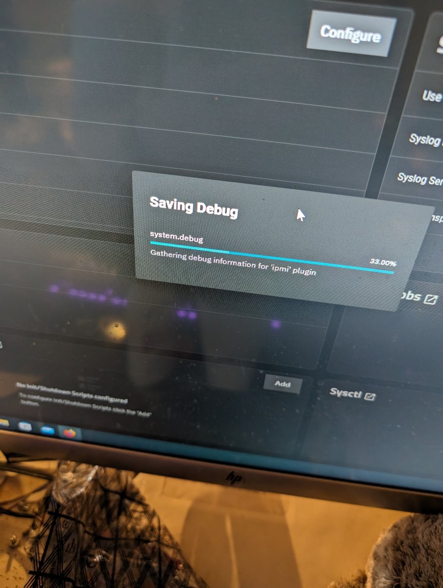

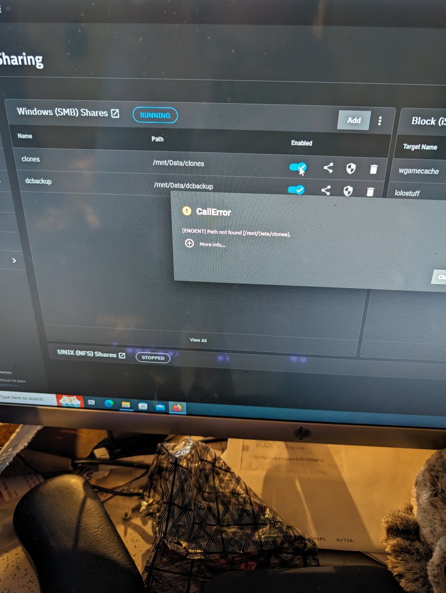

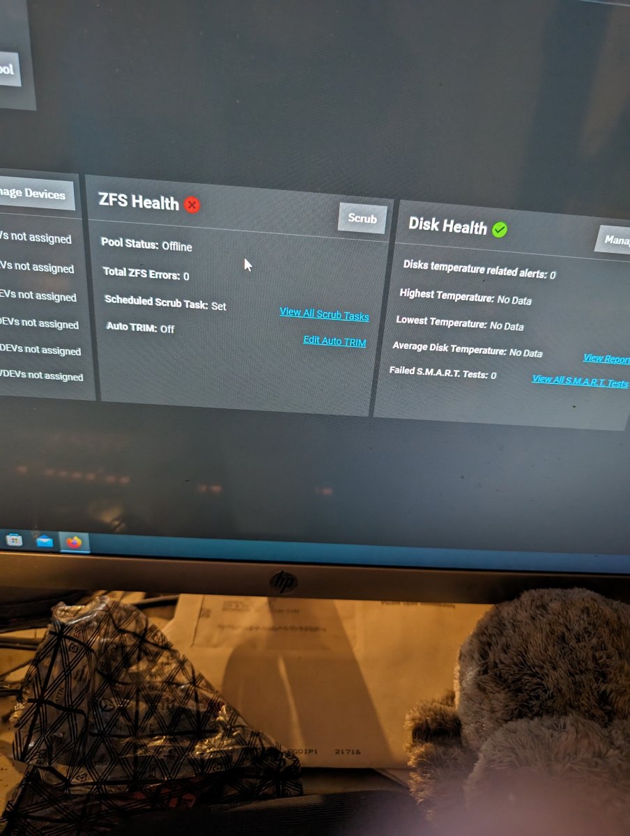

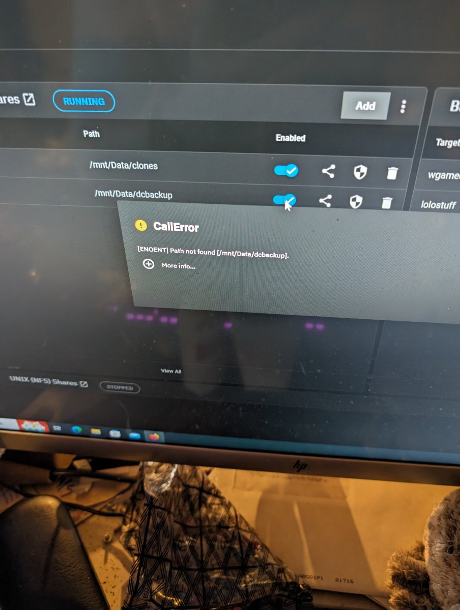

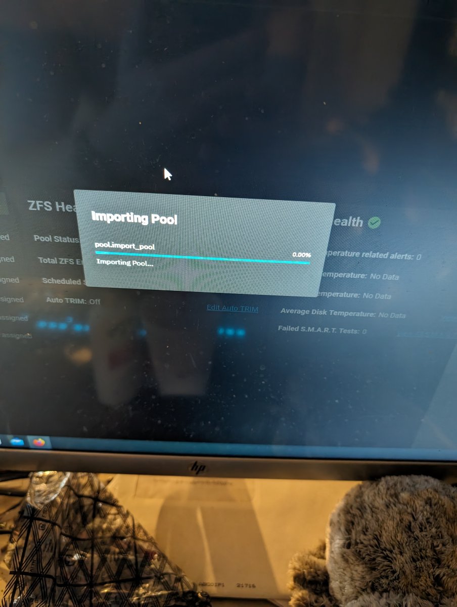

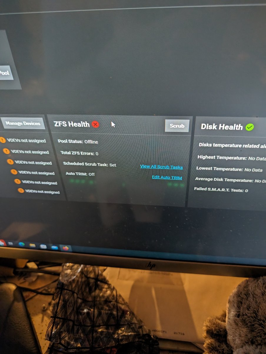

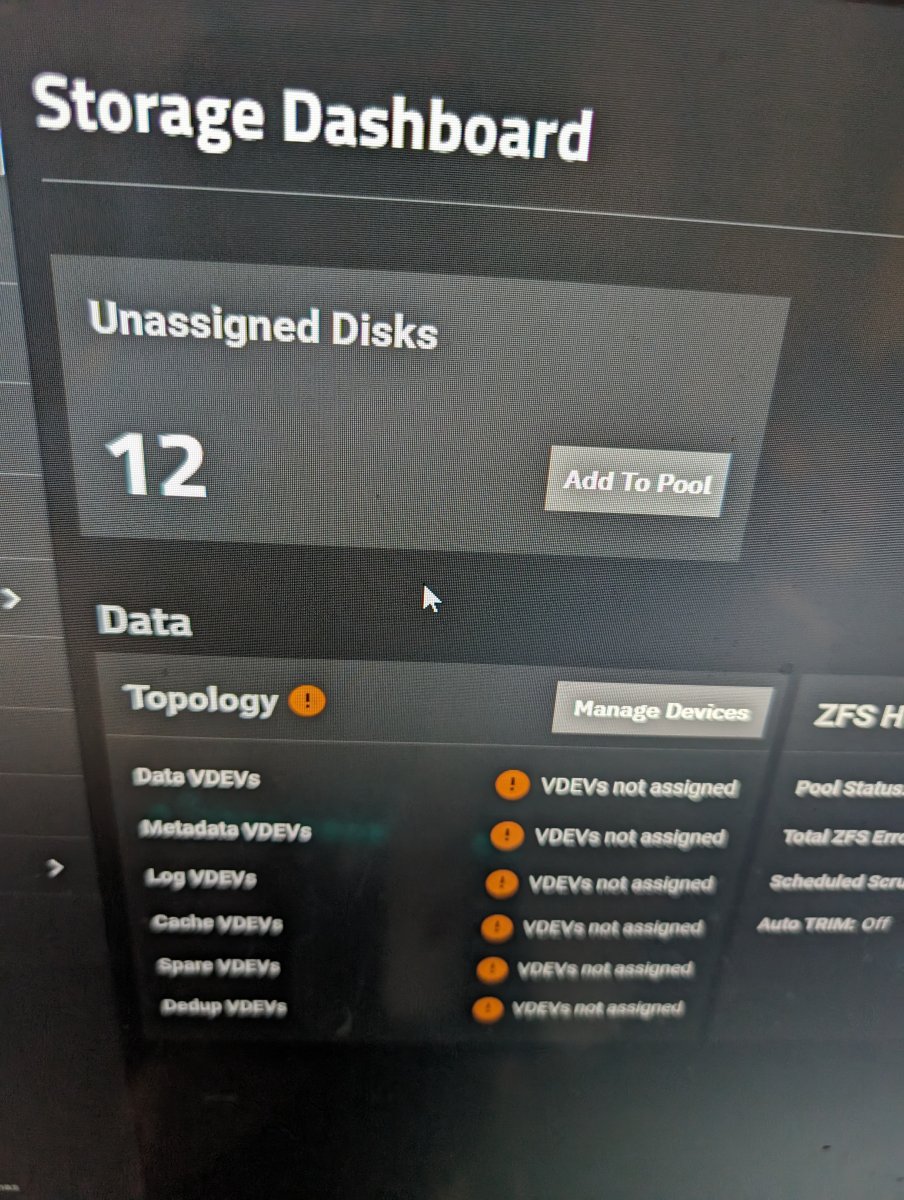

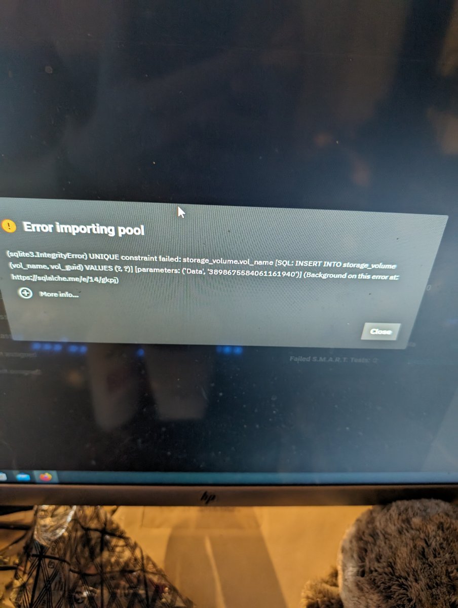

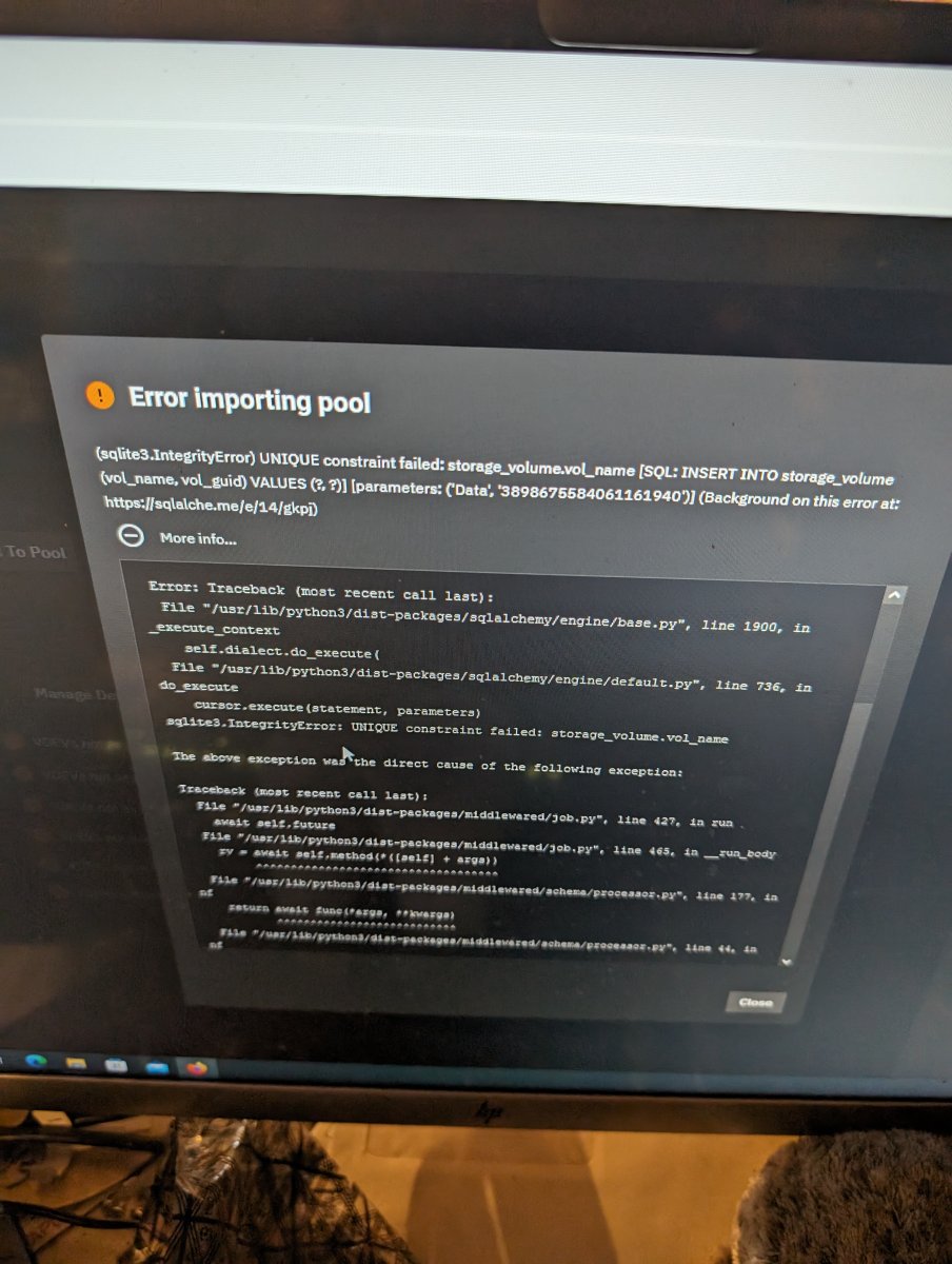

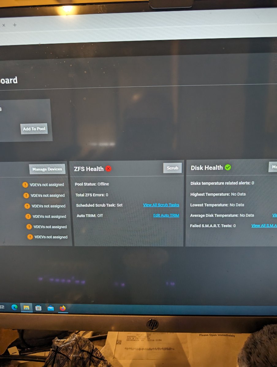

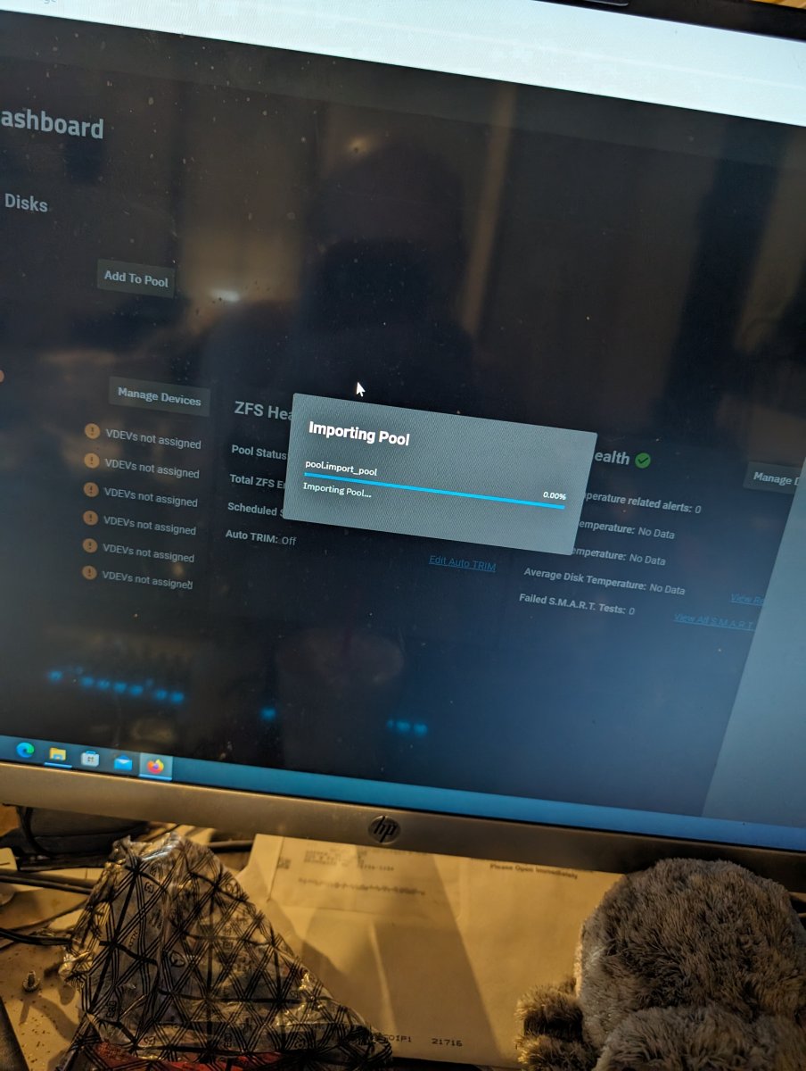

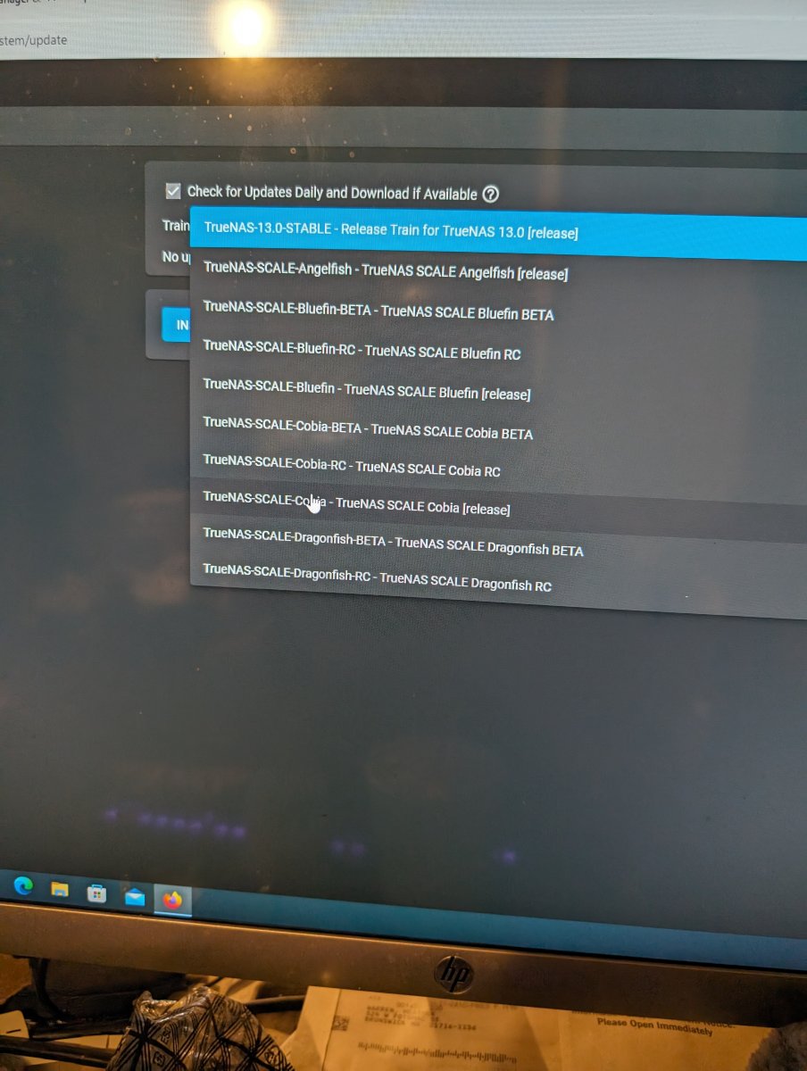

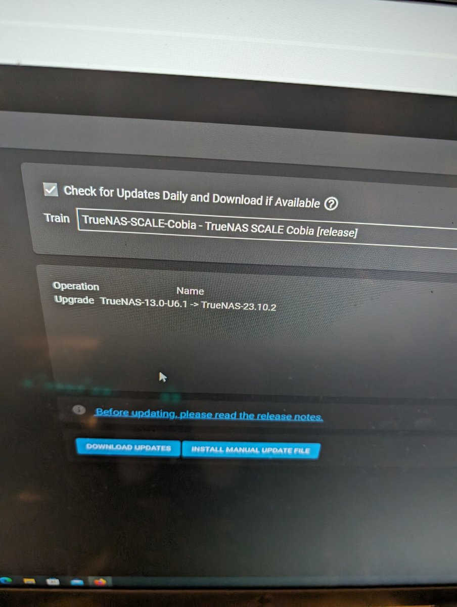

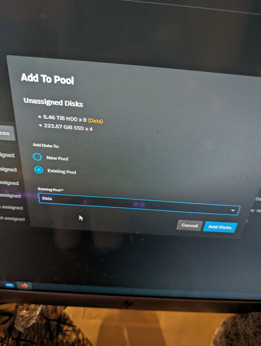

So this time I went from the latest version of core to the latest version of scale. And it acted nine kinds of weird for a while and then it finally stabilized and I had access to my data for a little bit, then I didn't. It told me the pool was gone and I need upgrade and then it would let me upgrade a non-adesistant pool and then it would disappear and then we'd throw some more errors and then SMB wouldn't work. It threw some errors and iSCSI wouldn't work and finally after about 20 minutes it'd settle down and I apparently have access to everything. We'll see what happens tonight at midnight and see if I have all of my snapshot and replication tasks working. I'm also going to log into my other profile which has all the shares loaded and the iSCSI drive loaded and make sure all my data is actually still there. I do have debugs of before and after and config backups.

Not one of the times. When I did the core to scale the pool was gone. It was corrupted. There was no recovery in it. The next time that I tried it after restoring everything I was able to go from core to scale the pool disappeared. But then I was able to import the pool and then I had to upgrade it. So I didn't lose anything but it definitely wasn't seamless. So right now I've got a 50% failure rate on absolute total loss of the pool. This is why I have two servers, one backs up the other plus an off-site replication that's the only reason why I tried this is because I knew in a worst case scenario I had two backups, one being off site

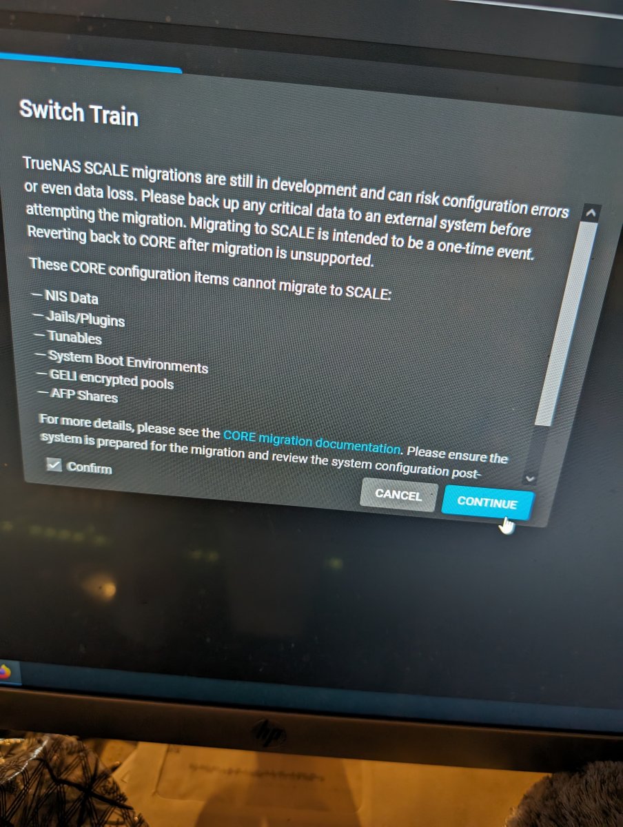

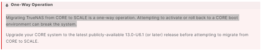

The migration guide clearly states that it is a one way process going from core to scale, this is not supported:

A lot of people aren't reading what I posted. I tried to go from core to scale and it destroyed my pools. Not once but twice. The third time I tried it I had to start from absolute scratch. Going from core to scale only worked when I started from absolute ground zero. Even then I had issues with the pool. When I went from core to scale the third time, it came up and said that the pool wasn't there at all. This time it allowed me to import the pool instead of throwing that weird error. Once I imported the pool then they gave me the option to upgrade the pool. Once I did that I had scale up and running. Now I had tried this once going to twice. I'm sorry. Going to Cobia. I then the third time went to dragon fish RC. Dragon fish RC at least allowed me to import the pool manually, but it still didn't convert it on the fly.

@hescominsoon agreed, if you have a debug from the dragonfish upgrade please drop it to me so I can get it reviewed.

I already dropped multiple debugs at various stages of the process in the ticket that I mentioned above which has since been closed.

I can see a debug from Cobia where the unique constraint issue impacted the upgrade, which was addressed in the BETA.1 of dragonfish, however i am not seeing one from the dragonfish upgrade with the secondary issue you mentioned, if you do have a debug from and would like us to take a look let me know.
