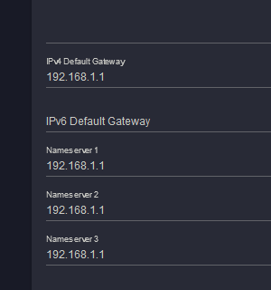

If you have DNS entries (probably including 8.8.8.8 and 8.8.4.4) in your router you can do this:
I assign static IP's by MAC address in my router, all outside the DHCP range.

I did exactly the way you did RedCoat applied it to my freenas computer.
Step 1: Build the freenas static IP address, and subnetmask in my router settings.
Step 2: Copy all of the primary DNS into the nameserver list (freenas network tab)
Step 3: Ping google for insurance (inbound and outbound traffic is A-okay!)
Step 4: Install the plugin.
Step 5: It failed.
