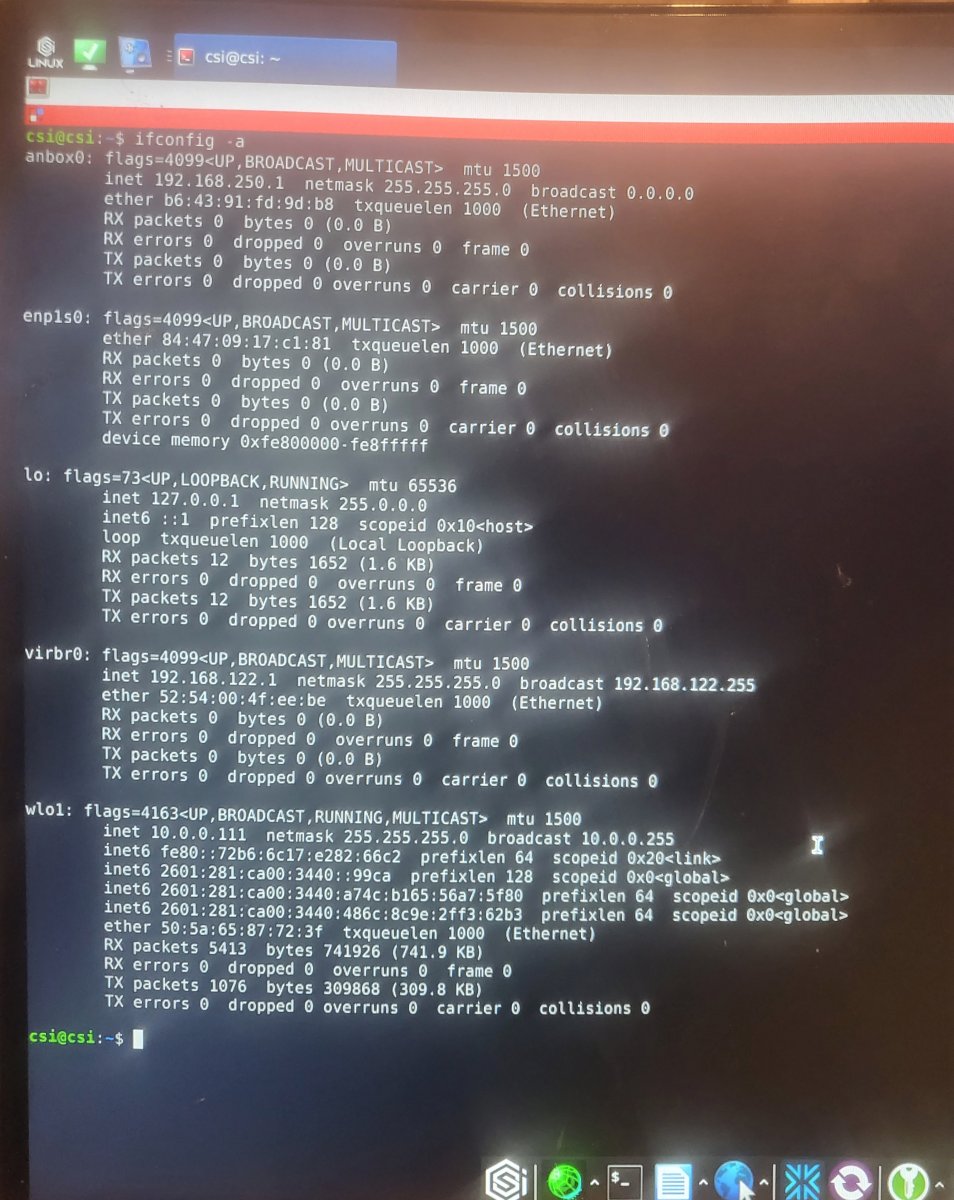

Sorry for delay in responce. Was out of town away from network.

Which machine is that from? Because it's showing addresses on 10.0.0.0/24, 192.168.250.0/24, and 192.168.122.0/24, but nothing on the network you're trying to assign to your NAS.
This is my mini pc, running CSI Linux for forensics
