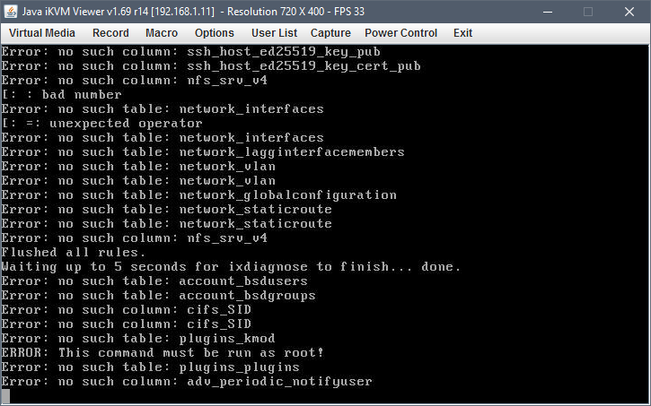

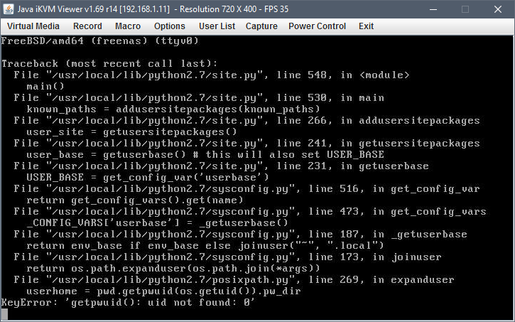

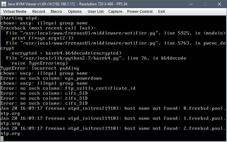

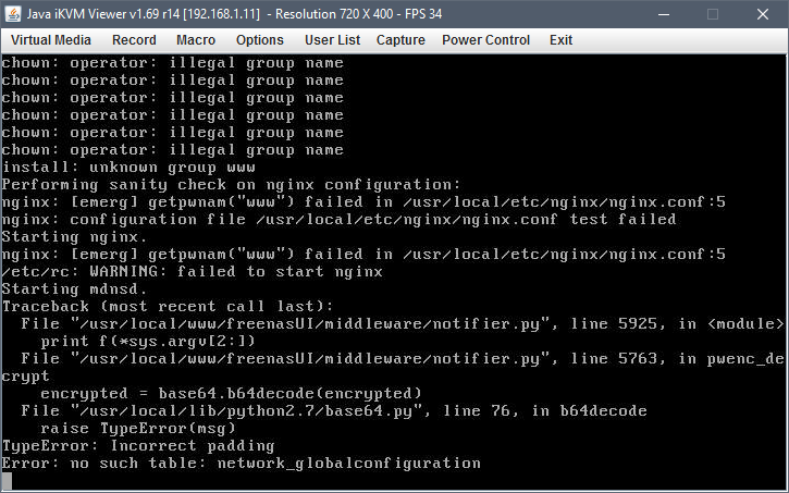

Hey Guys,
New to FreeNAS. Spent a bunch of money to build what I need for my NAS, and in the process, I didn't skimp for what I need.
CPU: Xeon E3-1220V3
Mobo: Supermicro X10SL7-FO
Ram: 2 x 8GB Crucial CT2KIT102472BD160B
2 x 120GB Sandisk SSD's (For whatever, no real plan yet)
And will be running 8 x 3TB WD Red's. (4 new ones, 4 in my current old QNAP, which I will be migrating all data to FreeNAS, and then creating a second pool with the other 4 drives.)
So I've been playing with FreeNAS in Virtualbox, and really want to love it, but have been having issues getting it running on my new hardware. Ran MemTest86 for a day and a half to check my ECC memory, no errors, rock solid and stable....
Ended up installing it on one of the 120 GB SSD's before I realized I wouldn't be able to use it for storage, but got it up and running for the most part, minus going into great detail with configuring, I decided I'd try installing it to a USB stick instead.

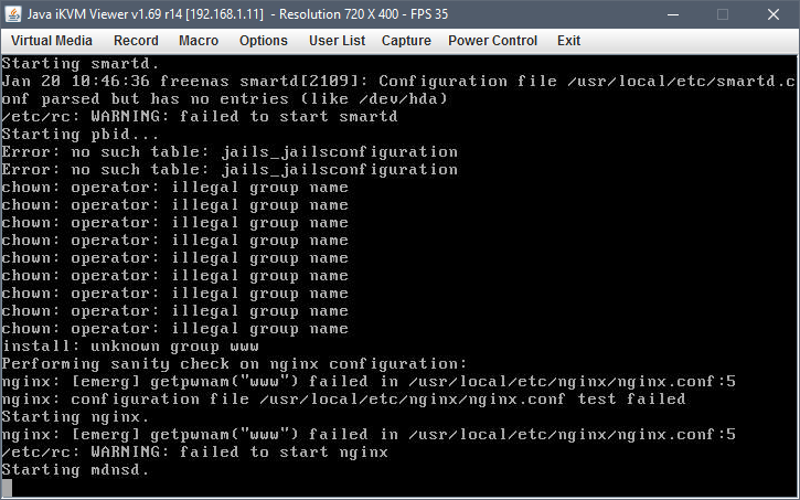

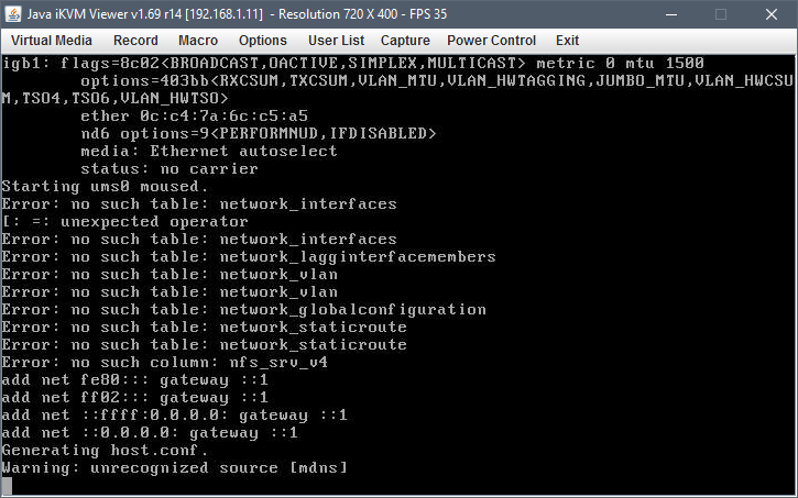

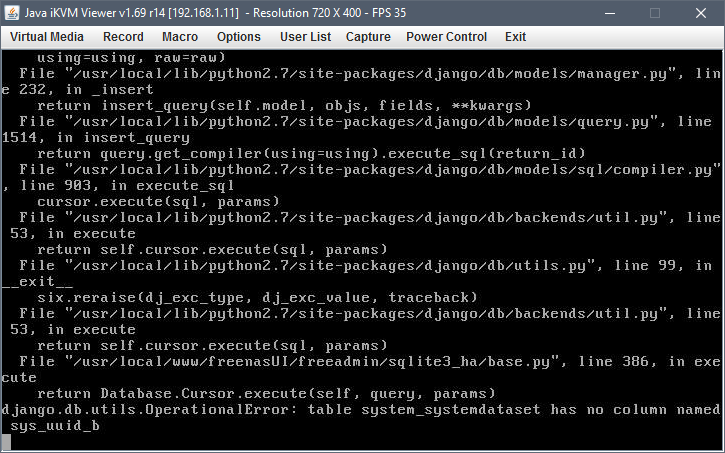

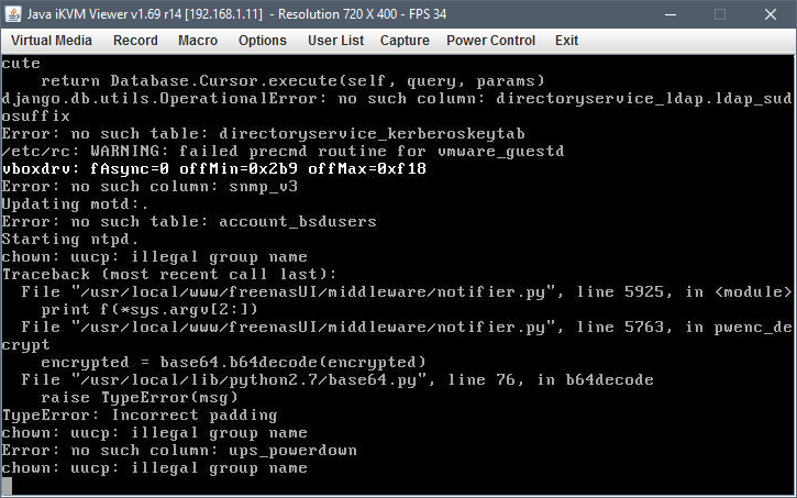

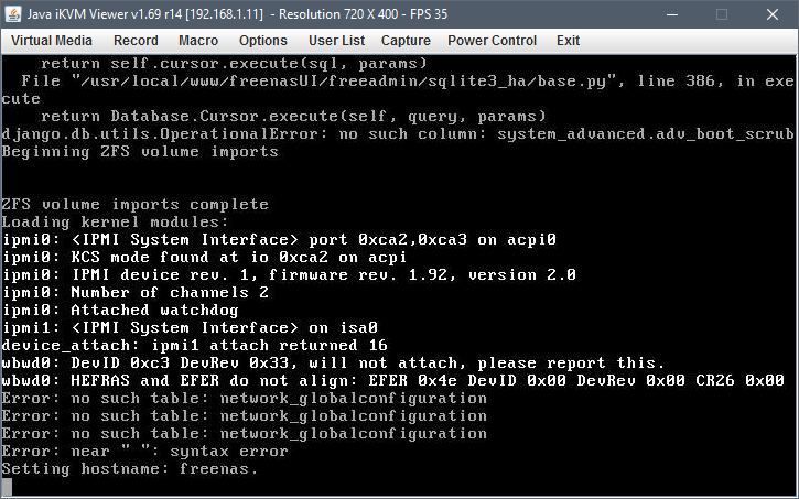

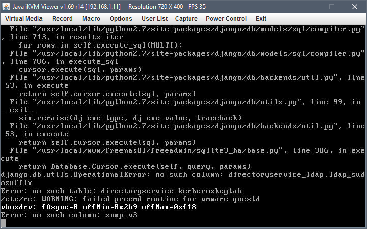

Well, what a big treat I was in for from that point on. Error after error after error after error. Can't even boot from the install still on the SSD, it just absolutely freaks out. Attempted re-installing about 5 times on 2 different USB sticks, tried installing from USB3 ports, Also tried disabling USB3 in the bios (XHCI Mode) and used a USB2.0 port, no luck. It installs no problem, says it installed without errors, but after rebooting and letting it load up, I'm greeted with so many errors its ridiculous, I just really want to get this up and running so I can start copying 5 or to TB of data over.
I've attached some screenshots of the IPMI interface as its booting
Please please can someone offer some suggestions as to what to do? Been at this for 2 nights now and am just wanting a solid working NAS, and the feature set of FreeNAS really appealed to me, ZFS, Snapshots, the reliability (hah, maybe after its actually running) aspect to name a few.

m0nkey_
Oct 27, 2015
2,739
What type of USB drives are you using to boot? Are they USB 2.0 or USB 3.0? If you want to go USB, the most recommended is the Sandisk Cruzer Fit or Ultra Fit.
