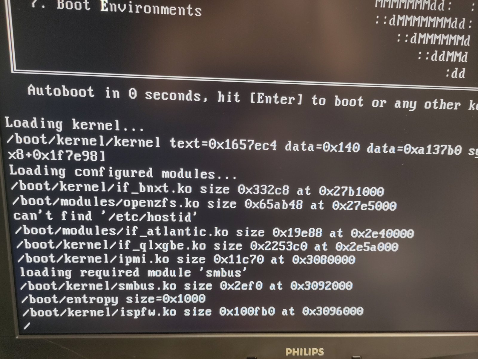

it complained about /jailarray quota, but I went on holiday and did not care :-(.
Now it stopped working. Webserver has not been responding, so I tried directly on the cli.
After some simple commands like "ls" it suddenly did not react anymore. Last thing that I have seen was that my jailarray had been full 100%. So I manually forced a reboot which did not work, so I unplugged the power.
Now after booting it gets stuck at this screen.
/boot/kernel/ispfw.ko size 0x100fb0 at 0x3096000
Any idea to get it back to running?
Does it scan harddisk now, I feed mechanical disks doing something.
Best Dani

This looks like a dead boot device. Install to a fresh one, upload the saved config file you hopefully have, and you're good to go.

Thanks, config backup is on the storage ;-). Tried to boot from usb in the mean time but it did not work, maybe hardware issue too.
