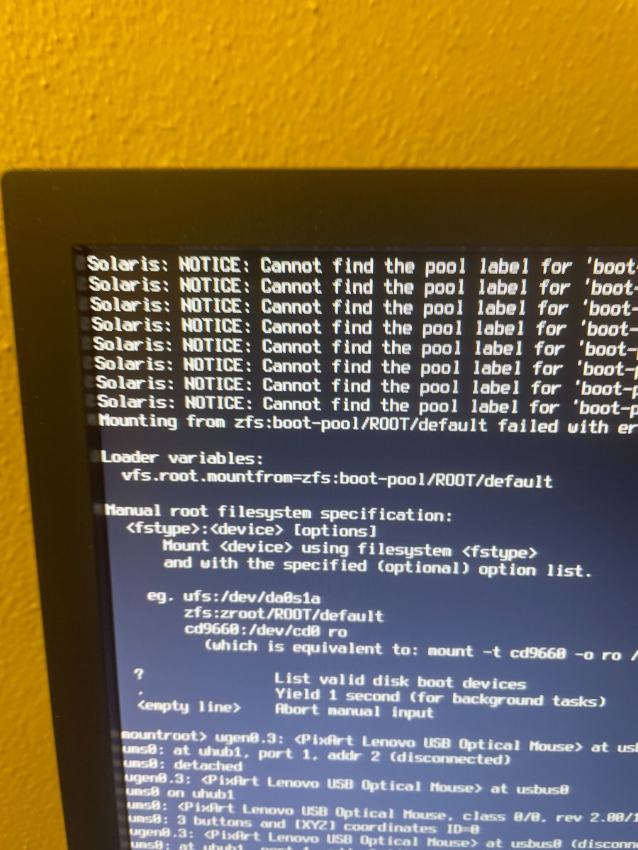

So I'm relatively new to the entire TrueNAS scene I am helping a friend of mine out with fixing his issue and I've reached this strange hiccup that I was hoping some of you experienced individuals may be able to help with.
When I place the boot-drive in another PC I recieve no errors and everything boots fine. Inside of the server he gave to me this is the issue I have regardless of troubleshooting: (see photo below)
I'm assuming I could just wipe the drives, resintall TrueNAS Core and important existing boot pools from the storage drives?

You need to describe your setup per the Forum Rules (in red, in top menu). Right now there's nothing to troubleshoot with.
Oct 22, 2019
3,641
You mean import the data pools? The boot-pool is for the OS only (which can also contain a 16GB swap and log files.)
I think you mean you'll re-install TrueNAS to the same boot drives, upload the config file, and then reboot back to where you were. (You did export the config file, yes?)

Yes I did, I was just double checking from someone experienced so I didn't lose data in the process. I however regret not reading the documentation that states just that in the first place lol.
