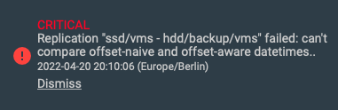

After updating both of my private systems to RC1 all my replication tasks fail - local ones as well as remote.
All of my tasks have custom retention periods for the destination.
People seem to have noticed on SCALE first, but I now have that problem with CORE --> CORE:
Here's a quick hack - would be great if someone with greater knowledge of python would check it for correctness.
Change the file /usr/local/lib/python3.9/site-packages/zettarepl/replication/task/retention_policy.py - line 57 - from:
if parsed_dst_snapshot.datetime < now - self.period]
to:
if parsed_dst_snapshot.datetime.timestamp() < (now - self.period).timestamp()]
Then clear the pycache and restart middlewared:
rm /usr/local/lib/python3.9/site-packages/zettarepl/replication/task/__pycache__/retention_policy.*
service middlewared restart
Honestly, I "stackoverflowed" it - no idea what I'm doing. OK, a bit of an idea. The comparison uses a type with a timezone and a type without and python throws an error about that. I do not know if my way to force identical types is the correct/recommended/canonical one.
to:
Kind regards,
Patrick
You would want to use datetime's function that returns the equivalent in UTC (or whatever TZ you want) and manually strip out the TZ data part of the datetime to convert it into a naïve datetime object. Your solution works if everything's consistent anyway, but there's TZ info missing on one end.
