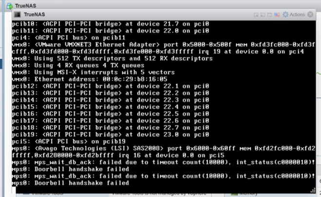

Had some problem with the Core 13.0 release a month ago, it did shut down and would not be able to restart.
Seemed like LSI-card-drivers did not work for my ESXi-virtualized TrueNAS, reverted back to 12.0-U8.1.
Will this 13.0-U1 fix this driver problem?

Tried the 13.0-U1. Worked for half a day, then same problem occured and this time it was impossible to recover/reboot - even into 12.0-U8.1.
Assume a clean install may fix my ESXi problems with 13.0.
So as I had to make a total recovery/setup of the Truenas from scratch, I installed latest TrueNAS SCALE instead - uploaded Core config-file - and then everything works again just as it used to with Core.
