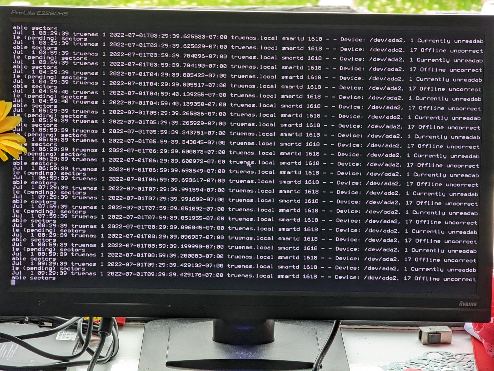

Hi I've done a fresh install of v13 but after 24hrs or so if I go to login to the admin page I get address is not reachable error and I have to force a reboot then its reachable again.
The errors attached are strange as all 3 drives are brand new
WD 2tb and seagate 2tb mirrored (storage)
Lexor 120gb ssd (os and swap)
hp elitedesk 800 g2 16gb ram and i5 quad core 1gb nic
Any advice I'm stumped

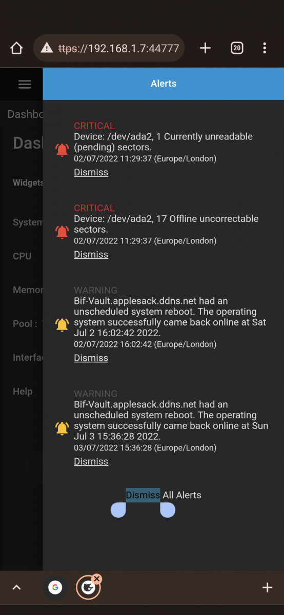

Aside from the fact that the drive in question is reporting sector errors, which is an indication platter media problem.
196 Reallocated_Event_Count 0x0032 187 187 000 Old_age Always - 13
197 Current_Pending_Sector 0x0032 200 200 000 Old_age Always - 1
198 Offline_Uncorrectable 0x0030 200 200 000 Old_age Offline - 17
It is desktop class drive not suitable for a NAS
Model Family: Western Digital Green
Device Model: WDC WD20EZRX-60D8PB0
Serial Number: WD-WCC4M6XCLTE3
Time to replace the drive. Make sure to avoid SMR drives, which are also not suitable in a ZFS application.
