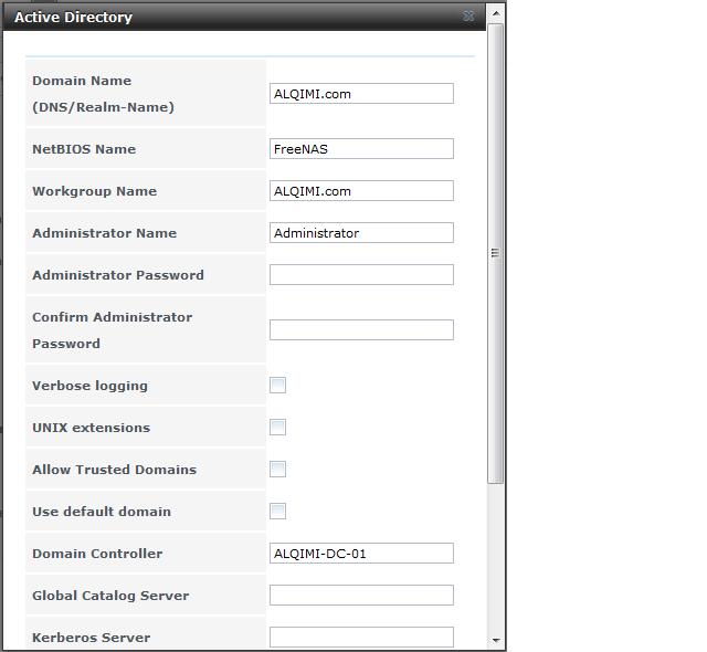

I've been having trouble integrating FreeNAS with Active Directory. Every time I try to boot up the service it gives me an error "The service could not be started". I'm not sure where to begin, I have tried just about everything when trying to connect. I have AD running on Windows Server 2008 R2. Do I need any of the advance options filled out? I have tried it with the advanced options completely filled with information, with just the domain controller filled in and without any information. I also have no idea what to put for the workgroup since I though you can either be apart of a domain or a workgroup but not both. I'm not sure what else I should include in here, but if you need any more information please feel free to ask.

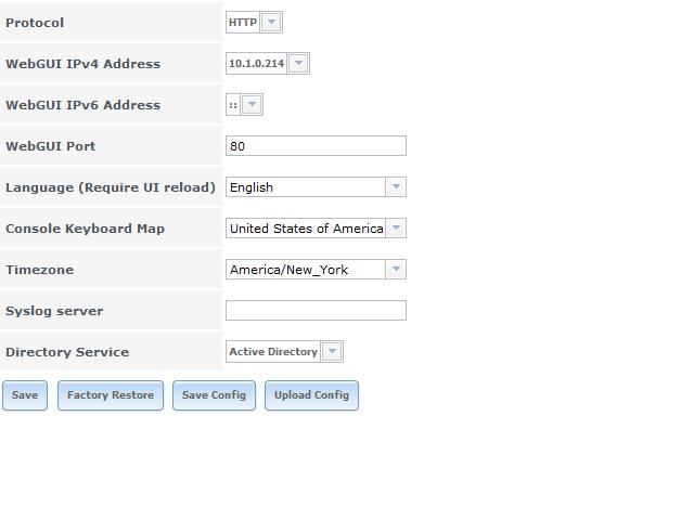

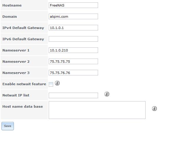

I guess you have already tried these?
  • Ensure time is the same on both the NAS and AD boxes
  • DNS is functioning, you can ping AD by name
  • It is important to ensure the new option under
    • Setting
    • General
      • Directory Service is set to Active Directory
The AD setup is as follows in Directory Service setup
o domain name as follows your (lowercase) domainname.com
o net bios name in caps (hostname of FreeNas box) FREENAS
o workgroup name in caps (old style) DOMAINNAME

Thanks for the help guys. I reall appreciate it. It ended up being that I needed to have the workgroup as just the beginning of my domain with no .com or .net at the end and all lower case. Now I have been having problems trying to get my folders to deny users access unless they have permission. For some reason it lets everyone read, write and execute even when they don't have permission. It seems that discussion is for another thread though. Thanks again your suggestions really helped.
