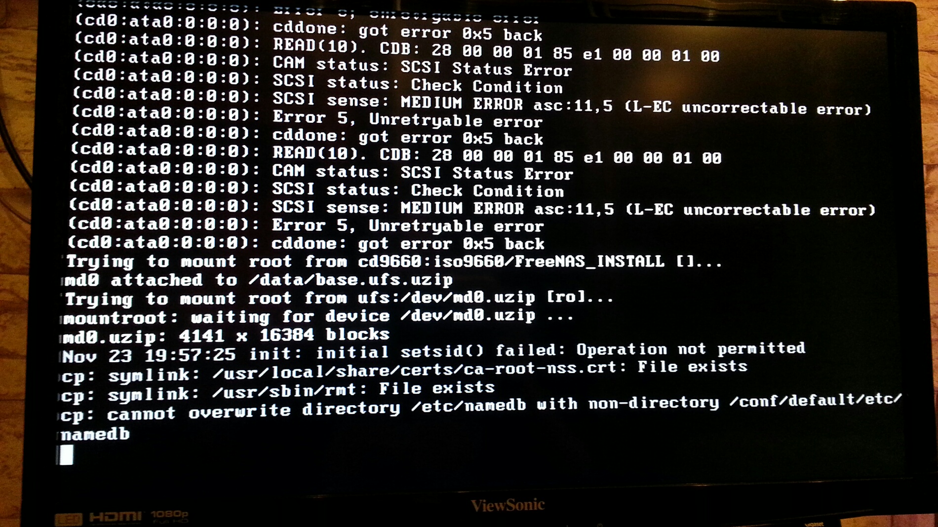

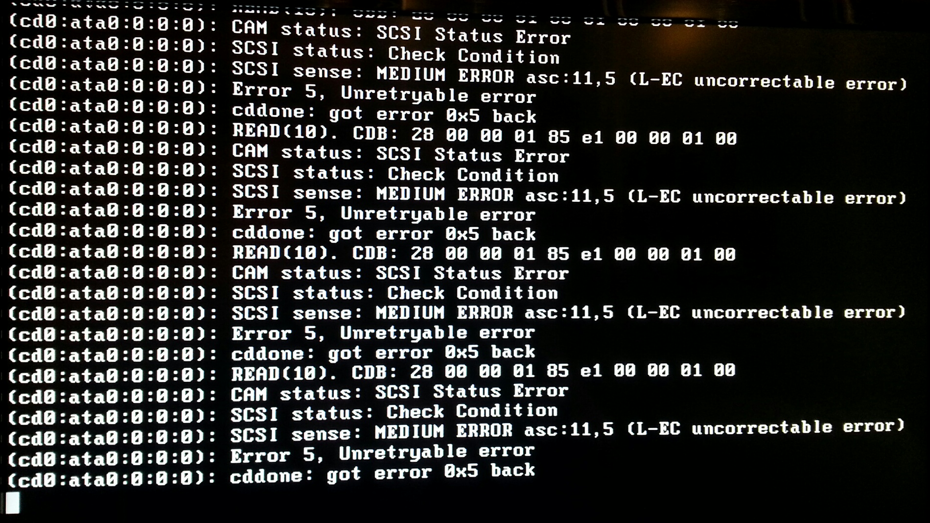

Hi everyone, just saying, I translate using Google.
Tried to install the sake of interest Free NAS, almost the whole system is. Nope, only discs ...
Put on a flash drive, 4 GB. When unpacking there are errors ... How to understand what is going on ???

SweetAndLow
Sweet'NASty
Nov 6, 2013
6,421
Please list your hardware specifications.

First, that hardware is not appropriate for FreeNAS at all. You need 8GB of RAM, it should certainly be ECC, and you should be using server-grade.
That being said, it appears that your hardware doesn't seem to be compatible because of the cd0 errors. Not sure what the problem as the errors are a fairly generic error message, but you definitely have a hardware problem. Note that I'm not saying the hardware is broken, it's almost certainly not compatible, which is why we don't recommend your hardware at all.

I remember that the NAS can be made from any old computer, even from a laptop ... Moreover, these errors occur before the window setup menu ...
RAM enough, the minimum requirements specified 4GB of RAM. Processor enough for tasks such as a home NAS. Though not in this MB RAID controller, it can make itself FreeNAS.I read in magazines, otherwise I would not contrive anything ...
ISO can be damaged, overinflated.
