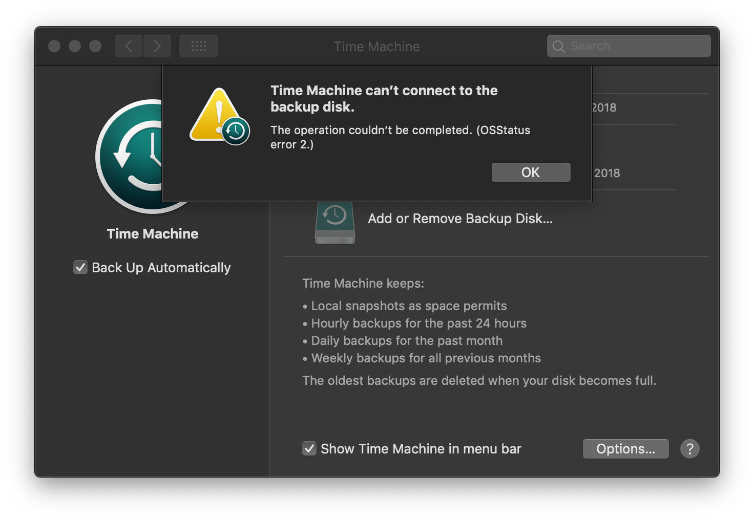

For the Macbook on Mojave 10.14: Time Machine sees the volume available, but on trying to connect I get the error shown in the attached screenshot - Time Machine can't connect to the backup disk. The operation couldn't be completed. (OSStatus error 2.).
