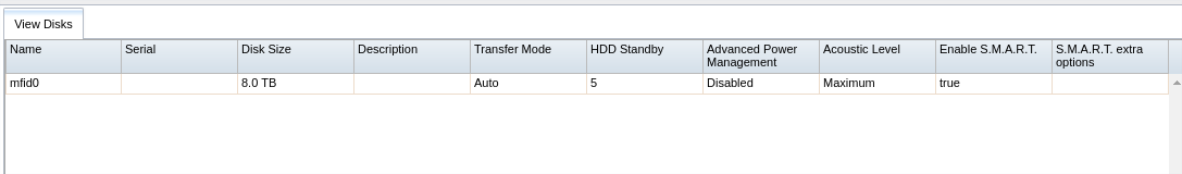

In the GUI, i see the disk, img below.
jba9Am
Anyone have any idea how i recovery this volume?

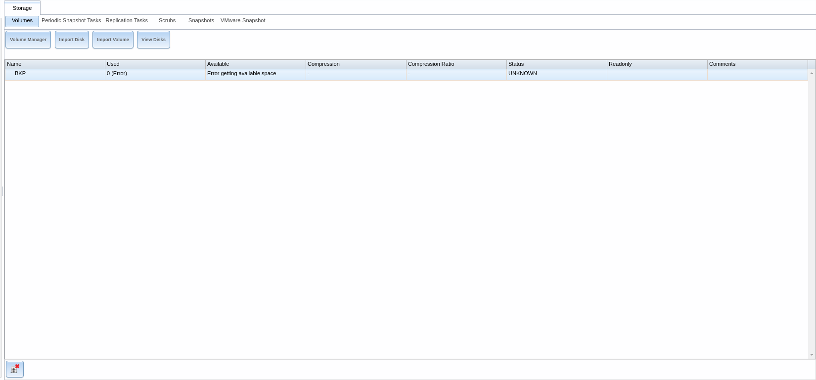

I do not know if it helps, but when I go to "Storage> volume", I can see the volume, follow img, and I only see the link to "Detach Volume"
15,504
So the pool isn't online, and it isn't available to import. That's a bad sign. In fact, it's a very bad sign. Did you set up the pool on a hardware RAID set?

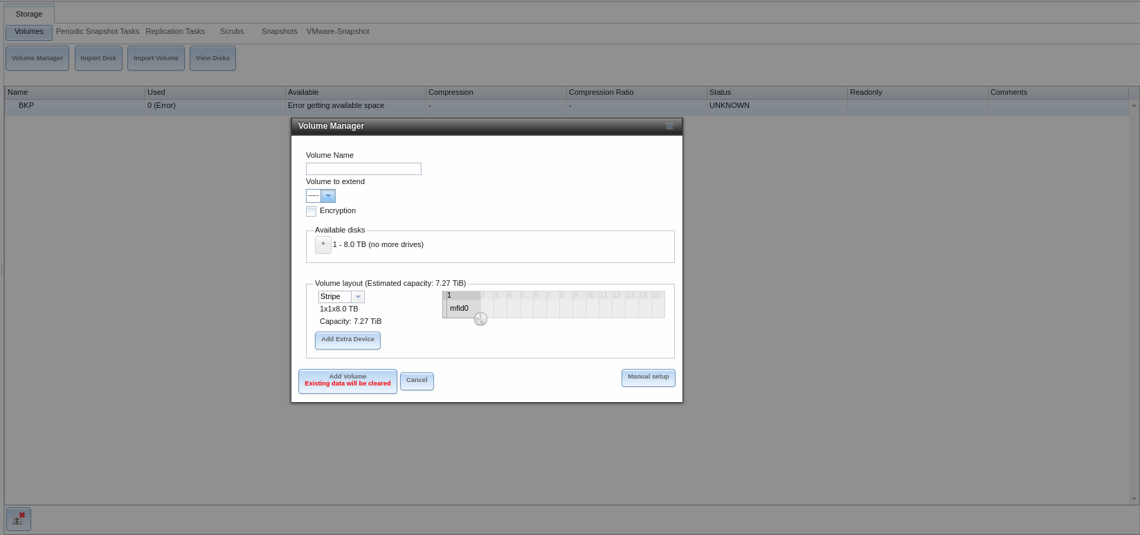

When i go on "Storage>Volumes>Volume Manager" i can see the partition "mfid0"
So it sees that the device is there, but doesn't seem to see that it has a valid partition table. This is why we don't recommend using hardware RAID with FreeNAS (or with ZFS at all, really). If you can't fix the hardware RAID using the RAID controller's tools, I think your data is gone.

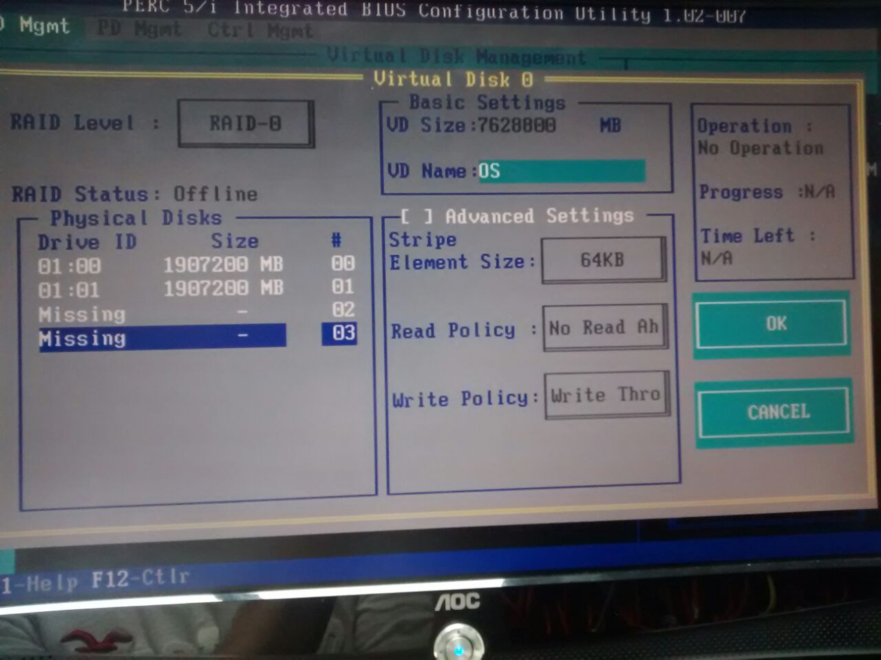

I think i found my problem...

It appears you're not going to recover from that. I would take this as a lesson learned.
ZFS needs direct access to the drives for this very reason. ZFS and SMART could have warned you about a potential failure.
Why would you make a storage pool as RAID-0. That gives you no redundancy. You didn't look at any of the hardware guides or ask any questions before you just slapped some junk together and called it good.
