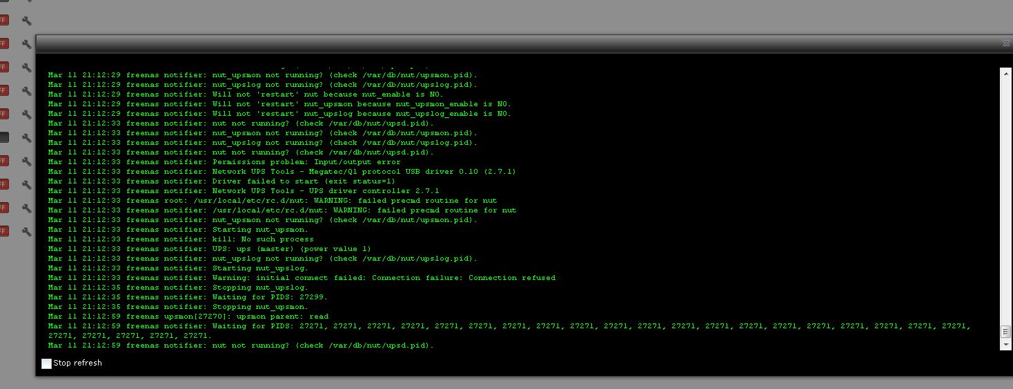

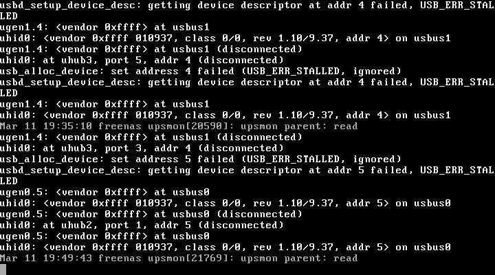

Have you tried? What is the output of upsc ups after you properly configured the port?
What driver have you selected?

I have tried and failed until now. Driver blazer_usb. Port /dev/ugen0.5.
