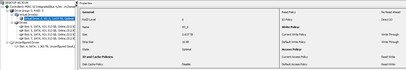

Configuration is in a screenshot attached but basically:
RAID 0 - 4 x 1TB WD Black (2010) drives
Stripe Size - 16kb
Disk Caching Disabled
No Read Ahead
Write Through
I'm getting VERRRY bad write performance on it! This card should be able to handle 300MB/sec. The drives are probably in the 90MB/sec area so 4 in a RAID0 should be able to accomplish 300 or even 200.
I'm getting Minimum 1MB/sec.... Max 7MB/sec with an average of 5.5MB/sec. Please see RAID0-2 screenshot.

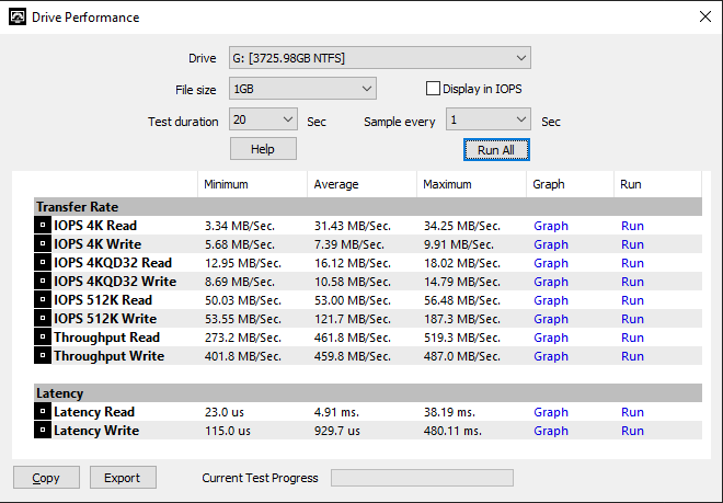

Hi All,
Sorry to bring a non Free-NAS topic to a FreeNAS Forum. Once again, was hoping to get some insight from a community of like minded people with differing skillsets.
@Yorick seems to have the right idea. As stated its a gaming system so FreeNAS would not be an option. If the RAID dies... who cares, I just replace a drive and reinstall games.
That being said, I did some playing around yesterday and resulted in some VERY nice numbers from the Intel Onboard motherboard RAID controller.
I've got basically SSD numbers from a RAID0 of 2010 Gen WD Black drives. My games are happy, I'm happy... Thanks again guys!

The root of your problem with the PERC card is that you've effectively disabled all disk and controller cache with your config choices of "Disk caching disabled" and "write through" - that's why your speeds were so abysmal. But they were safe, at least.
